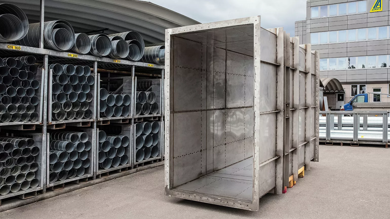

Their equipment, together with their in-house design and development department, enable the company to develop and produce custom-made products from scratch.This innovative metalworking approach means that Aumayr can manufacture ventilation pipes that conventional ventilation manufacturers would struggle to produce. In early 2018, the company received a large order for welded stainless-steel ventilation pipes. Even as the order was being calculated, it became clear that new alternatives to the previously manual welding process would be required due to the hundreds of running meters of weld seam and the customer’s stringent quality demands. Above all, sheet metal thicknesses up to four millimeters had to be welded without warping and in consistently high quality to create ventilation pipe components that were sometimes as long as six meters, as high as 2.5 meters, and as wide as 1.5 meters.

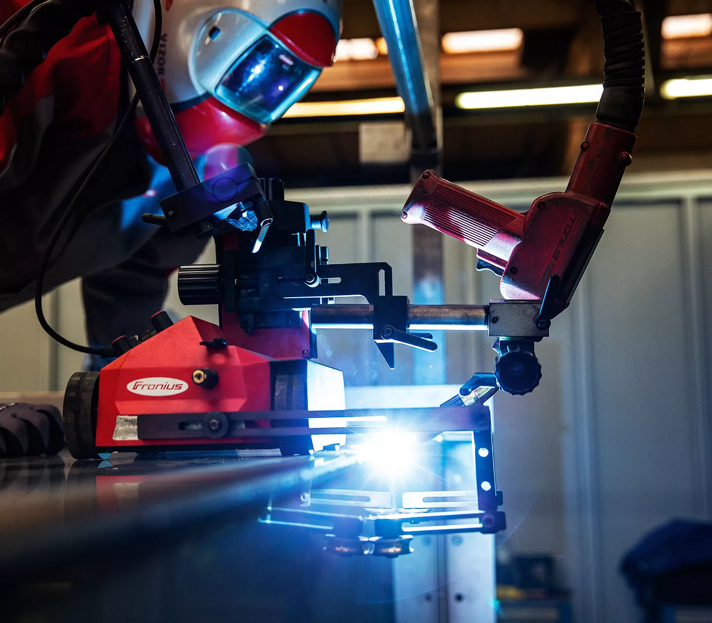

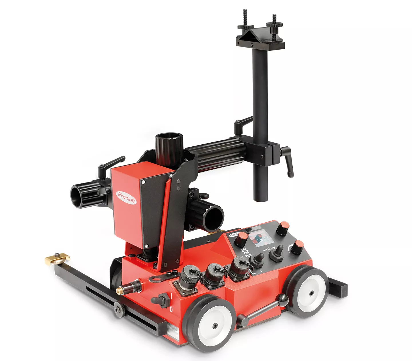

To meet these criteria, Aumayr decided to purchase a Fronius welding carriage – the sturdy, flexible ArcRover 22. “We chose this model primarily for its compact design and its compatibility with the Fronius TPS 5000 CMT and TPS/i 500 welding systems we already had in our fleet. We’ve now been using the ArcRover 22 since March 2018. Our welders particularly like the durability and ease of use of the welding carriage,” explained Erwin Kunst, Head of Metalworking at Aumayr. “Even during the initial tests, we were able to achieve improved and, most importantly, consistent weld-seam quality at a higher welding speed. The carriage is also easy to mount and always stays on the track thanks to its guide rails.”
ACHIEVING PERFECTION BY MIXING PROCESSES
The welding experts opted for a pulse process with an average amperage of 300 amperes in order to achieve optimal root formation when welding the side walls of the ventilation components, which are approximately 4mm thick. This approach ensures the necessary heat input. The somewhat “cooler” Fronius CMT (Cold Metal Transfer) mixed process – unbeatable in terms of welding quality – was used for section welding the flange plates and bracing ribs in longitudinal and transverse directions. The mixed process adjusts the ratio of hot pulse process cycles to cool CMT process phases as required for the specific application, resulting in perfectly welded, virtually spatter-free metal connections with zero distortion.
“The constant speed of the welding carriage combined with the right welding processes were the key factors in achieving the consistently reproducible high quality of the weld seams,” stated Erwin Kunst. “It vastly exceeded our expectations in the end. The Fronius welding experts deserve a special thank you for their advice and support right from the start. Together, we were able to significantly optimize the welding quality as well as the production times. Investing in the ArcRover 22 was absolutely the right decision.”
