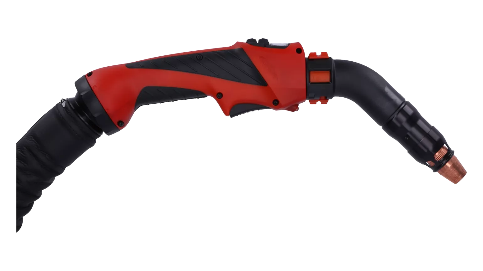

Exento fume extraction torch
High-performance and pinpoint extraction:
Exento fume extraction torches are the perfect complement to Exento HighVac systems. They meet the requirements of standard DIN EN ISO 21904-1 Health and safety in welding and allied processes.
  • Five different power categories:
    3x air-cooled and 2x water-cooled
  • Extraction capacity controlled directly on the handle
  • Four different user interfaces available:
    Up/Down, JobMaster, potentiometer, top torch trigger
  • LED light for welding in dark environments as well as for quality control
  • 1.3 m leather protection tube directly on the handle for perfect protection against high temperatures and welding spatter
  • Quick tester of the extraction capacity directly at the suction nozzle

    Exento extraction torches
     gas-cooled water-cooled
    MTG 250i Exento
    250 A 40% D.C.
    MTW 300i Exento
    300 A 100% D.C.
     MTG 320i Exento
    320 A 40% D.C.
    MTW 500i Exento
    500 A 40% D.C.
    MTG 400i Exento
    400 A 30% D.C.
