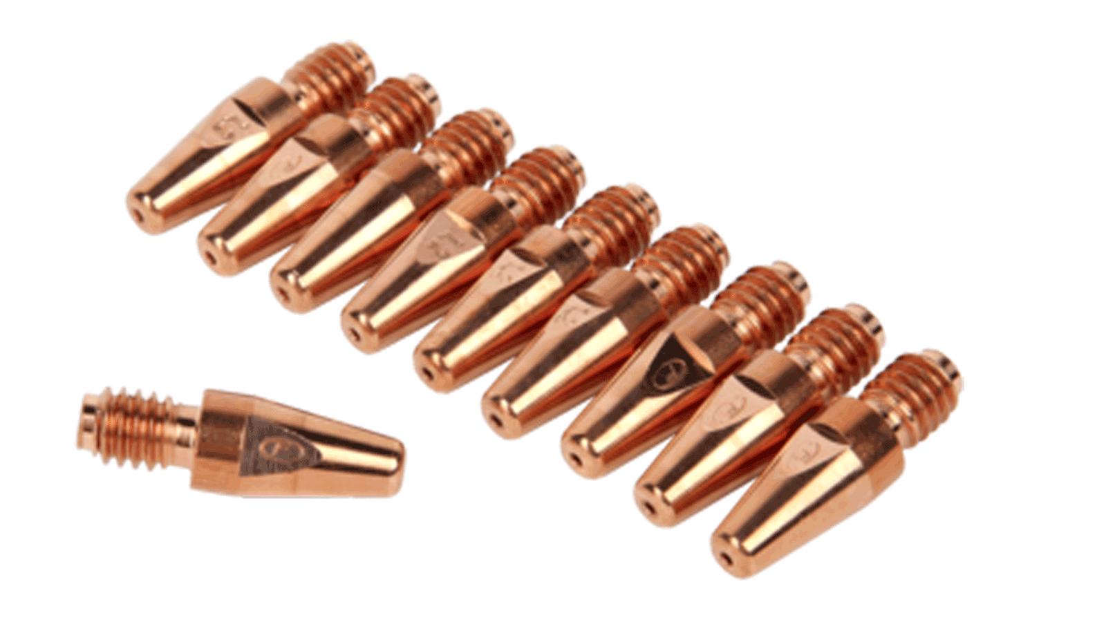

Contact tips for welding torches
The contact tip is the smallest, but the most important, wear part in MIG/MAG welding, and has a major impact on the quality of the welding process.
It transfers the welding current to the wire electrode and, with a constant flow of current, guarantees a stable arc. But which contact tip is best for which welding application?
Ideal for steel and CrNi welding.
E-Cu contact tips are made from pure electrolytic copper and boast outstanding electrical conductivity and good thermal conductivity. Electrolytic copper softens at around 260°C and has low wear resistance. E-Cu contact tips are primarily used in the low ampere range for manual welding applications.
Ideal for steel/CrNi and aluminum/CuSi welding.
The CuCrZr contact tip is made from a copper-chrome-zirconium alloy. These alloy elements make its electrical conductivity slightly lower than that of the E-Cu contact tip, but its temperature resistance extends up to 500°C. CuCrZr contact tips are right at home in the medium to high ampere range for manual and robotic welding applications.
The WQ contact tip (tungsten-copper quality) is an CuCrZr contact tip with a tungsten-copper core. The high temperature resistance of tungsten is impressive and combines perfectly with the high electrical and thermal conductivity of copper. Applications where grinding might be involved will particularly benefit from a WQ contact tip. System availability increases and maintenance costs fall.

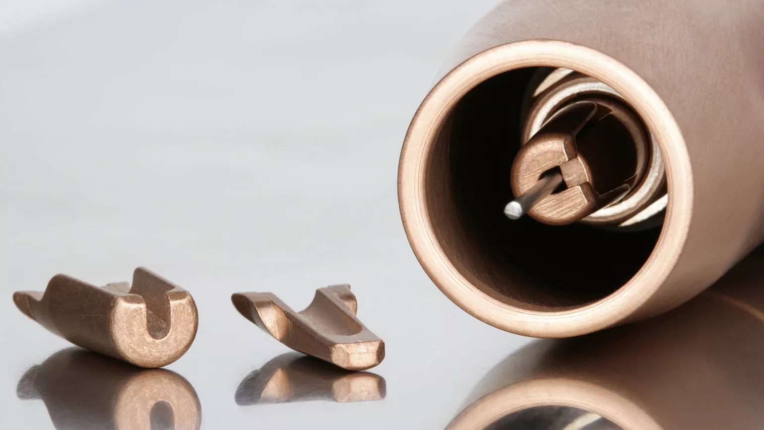

Special form: Contec contact tip
Ideal for aluminum and CuSi welding.
Features:
  • 100% consistent contacting
  • Longer service life
  • Greater process stability
  • Constant tool center point (TCP)

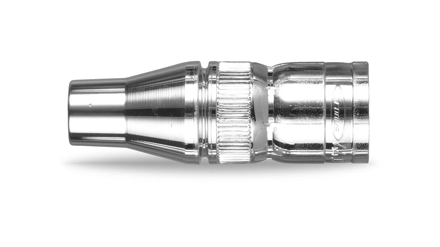

Gas nozzles for welding torches
The gas nozzle ensures a uniform flow of shielding gas into the welding process. This constant flow of gas protects the arc and the weld pool from the atmosphere. We have the right gas nozzle for every welding application.
Gas nozzles that have been specially developed for aluminum applications ensure that spatter rarely sticks, consequently reducing the turnover in wear parts.

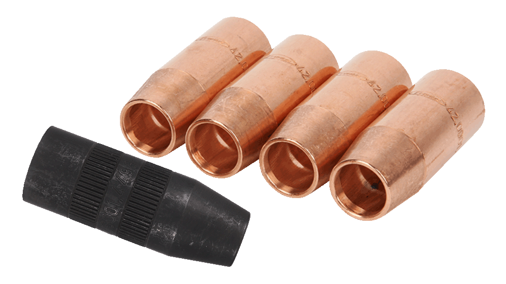

Special form: Small-gap gas nozzle
Feature:
  • Narrow gas nozzle for optimal accessibility

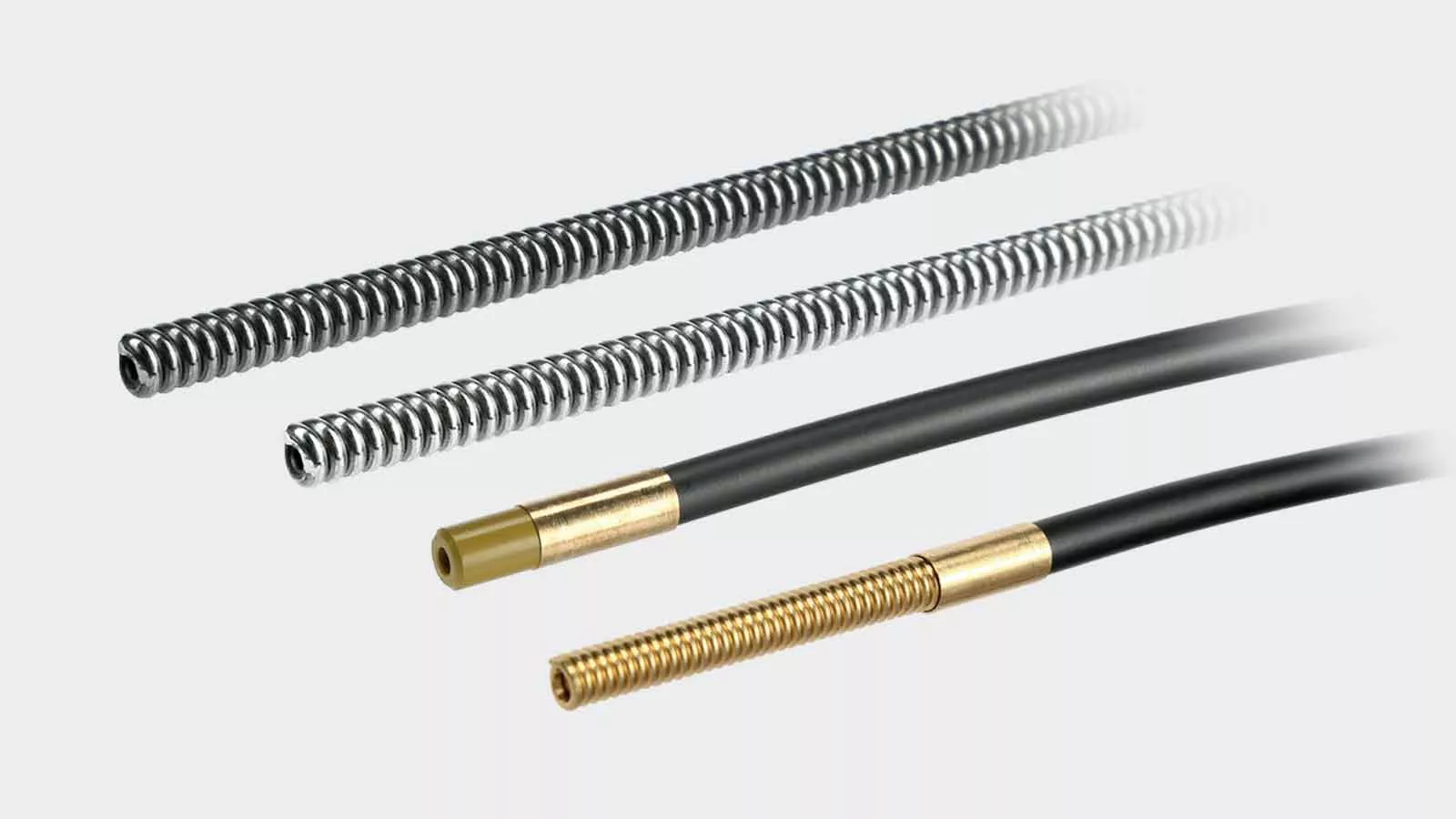

Inner liners for welding torches
The task of the inner liner is to feed the welding wire smoothly from the wirefeeder to the contact tip.
We provide the appropriate inner liners – and combinations of them – for every application area. Our range includes bare steel liners, coated steel liners, CrNi liners, Teflon liners, graphite liners, and bronze liners. Both the construction and the inner diameter of these inner liners perfectly complement Fronius welding processes.

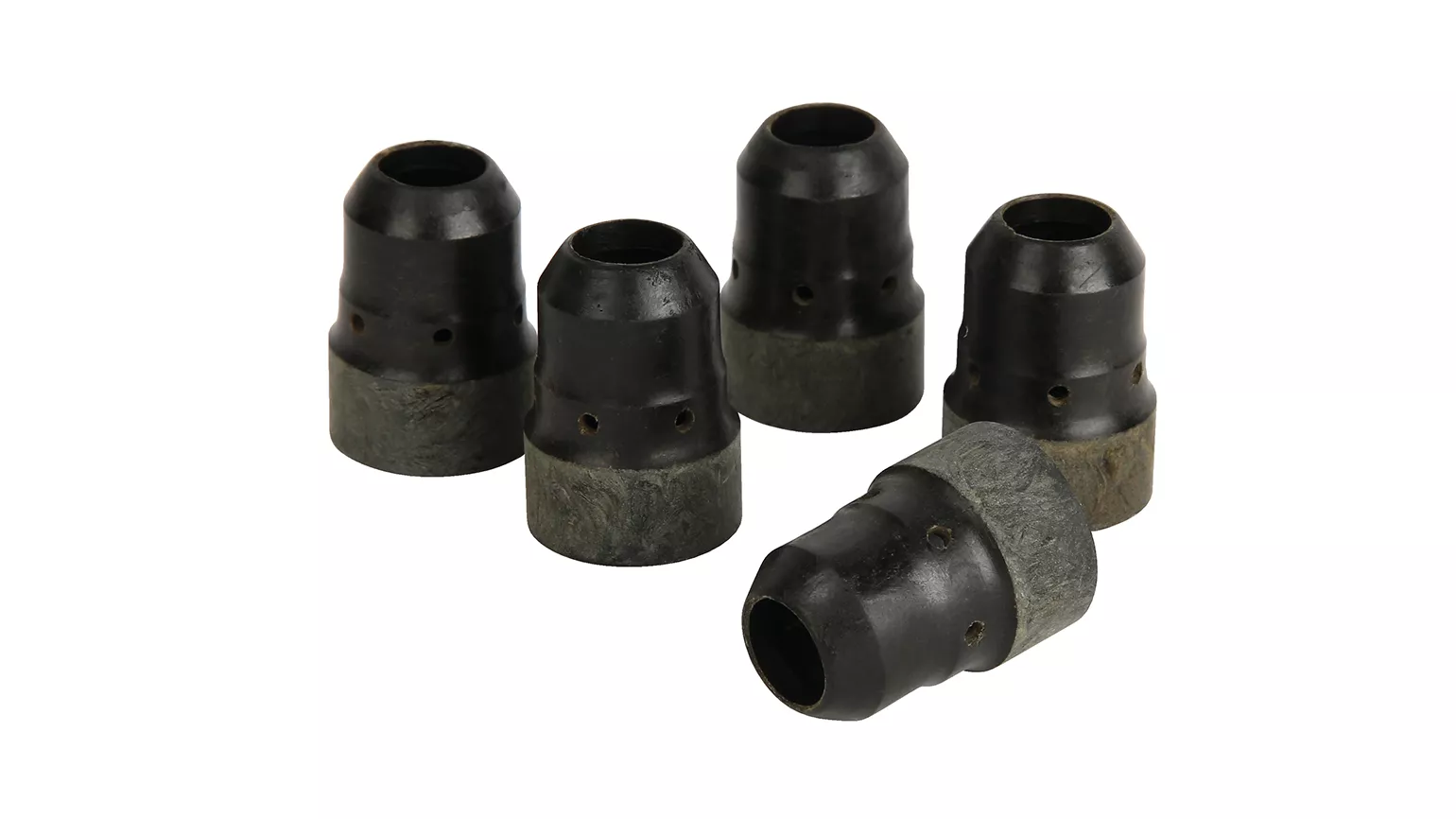

Gas distributors for welding torches
The gas distributor is mainly used for aluminum welding and produces a uniform flow of shielding gas.
The materials used in our gas distributors impress with their long service lives.
