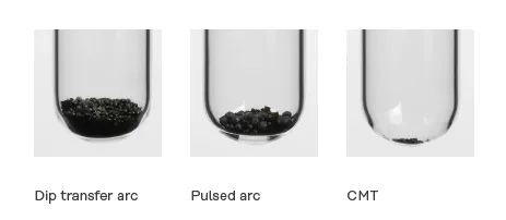

The advantages for you
Less rework
/ 99% less spatter*
/ 33% less heat input reduces distortion
/ Spatter-free ignition (SFI)
100% higher speed**
/ Same penetration at high speed
Fast joining of thin sheets
Stable arc
100% CO2 welding
Also for high-strength steels
Not susceptible to external influences (changes in stickout or workpiece surface)
*Under laboratory conditions
**Compared with standard dip transfer arc

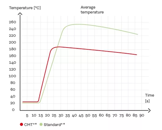

Reduced heat input
Heat input at the lowest level: as soon as the short circuit occurs, the wire is pulled back again during the CMT process. This means that the arc only introduces heat for a very short time.
As a result, CMT enables continuous regulation of the heat input from cold to hot. In addition, higher welding speeds and a wider range of applications* are possible with maximum weld quality.

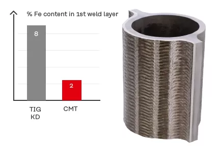

CMT Cladding
CMT cladding
The characteristic for cladding with low penetration, low dilution, and wide weld seam flow for better wetting
More information on cladding
CMT cladding: 75% less dilution of base and filler metals
In conventional overlay welding, the arc fuses a relatively large amount of the base material.
The typical dilution and mixing of base material with filler material reduces the corrosion resistance of the applied layer. However, the base materials are melted to a lesser extent due to the lower heat input of the CMT process. This results in up to 75% less metallurgical mixing of the base and filler materials, and reduces costs for overlay welding.

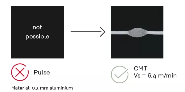

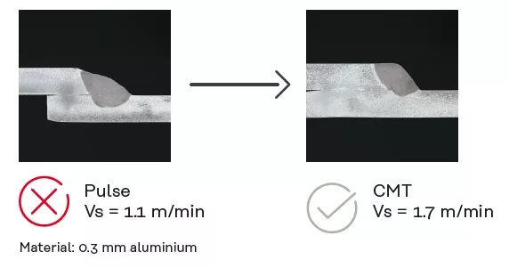

Aluminum welding with CMT
An investment that pays for itself
Calculated per component, costs can be reduced by up to 43%*, so the higher investment costs involved with CMT are repaid in no time.
* In relation to the Standard Welding Package
Light gauge (≤ 1 mm) aluminum sheets can be welded.
The low heat input of this process means that weld-pool support isn't necessary to keep the weld from dropping through.
Advantages
Reduced investment in welding cells: better utilization and useful life of the cells, thanks to higher welding speeds
Less rework and fewer rejects thanks to the stable process and reduced spattering
Shorter maintenance operations, since contamination from spatter is kept to a minimum
/ Lower gas costs due to reduced welding time. Light gauge (≤ 1 mm) aluminum sheets can be welded.

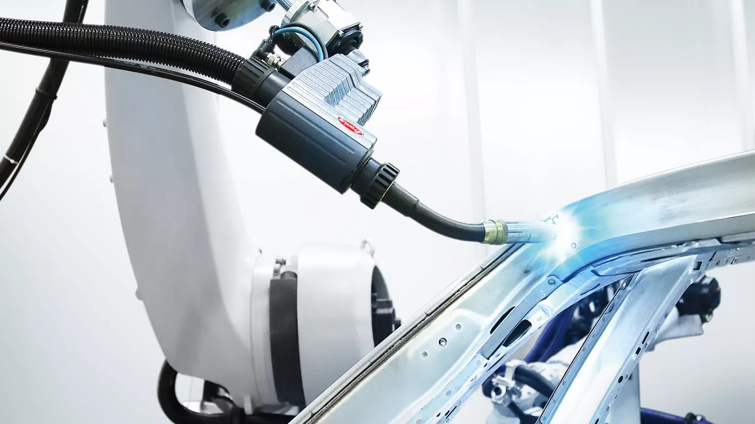

Robacta CMT application
