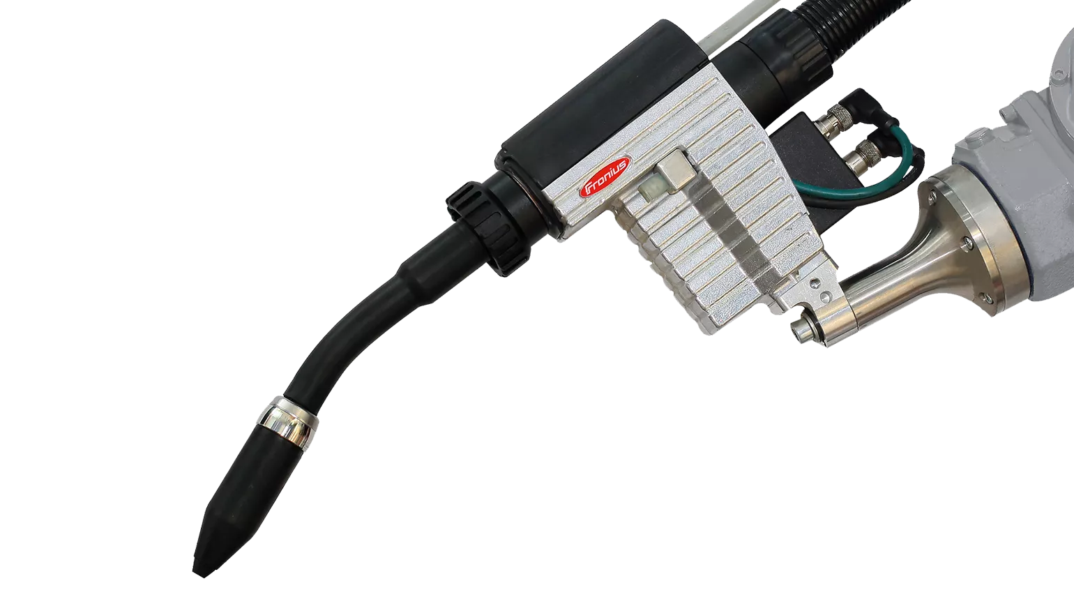

Fronius has developed an extremely narrow conical gas nozzle in cooperation with AUDI AG for the CMT Braze+ (CMT = Cold Metal Transfer) process. The shielding gas emerges from the nozzle at high speed, which constricts the arc and makes the brazing process much quicker than standard arc-welding processes. Gas consumption also decreases by as much as 60%, to three to five litres per minute. What’s more, the high flow velocity and the optimised design of the torch ensure a high cooling capacity, which guarantees long component service lives. This not only dramatically reduces the investment costs, but also the wearing part costs. The welding process achieves a high level of reproducibility, which is why CMT Braze+ is becoming increasingly attractive for applications that used to be the preserve of laser brazing.

Are you already using a CMT welding system from Fronius? Then let us advise you on how to exploit the advantages of CMT Braze+. In order to use the new process, all you need are the torch body and an adapted characteristic.
