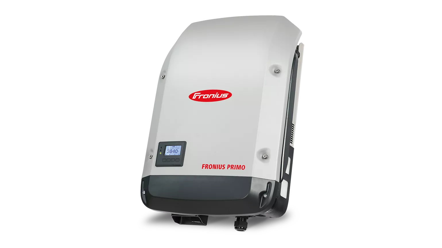

Fronius Primo
The communicative inverter for optimised energy management.
With power categories ranging from 3.0 to 8.2 kW, the Fronius Primo perfectly complements the SnapINverter generation. This single-phase, transformerless device is the ideal inverter for private households. Its innovative SuperFlex Design provides maximum flexibility in system design, while the SnapINverter mounting system makes installation and maintenance as easy as possible. The communication package included as standard with WLAN, energy management, numerous interfaces, and much more besides, makes the Fronius Primo a communicative inverter for owner-occupiers.
