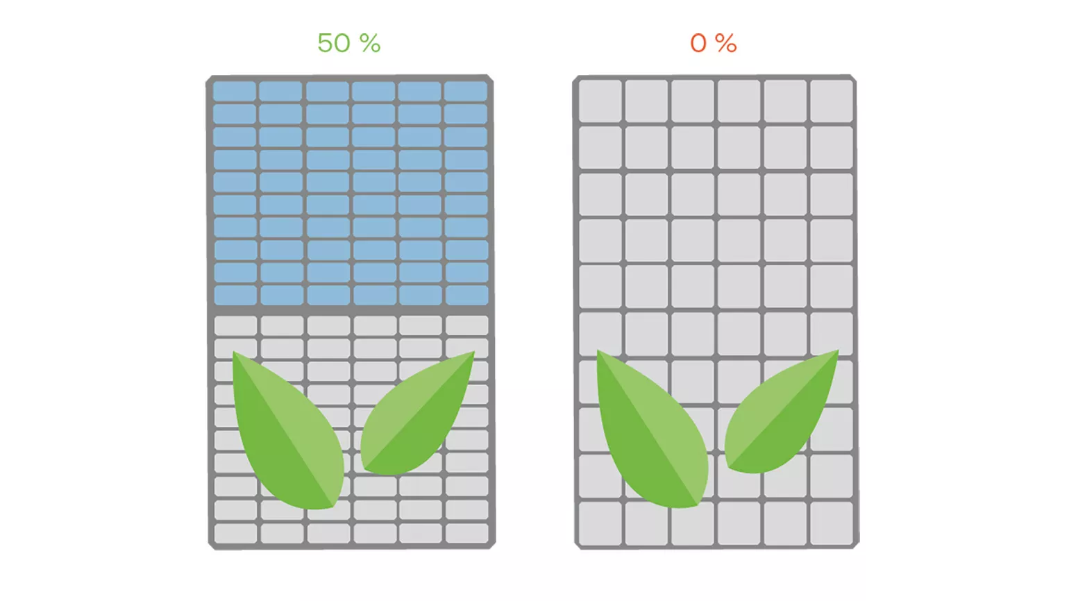

Ongoing advancements in solar modules are also helping make home rooftop PV systems even more efficient. Half-cell technology, which splits individual solar cells into two, means conventional solar modules can not only reduce power loss but also improve light utilization as well as ensuring stable functioning even at high temperatures.
Shading behavior is also improved with half-cell modules, in which bypass diodes divide the modules in the middle. If the lower or upper half of the half-cell module is shaded by leaves, for example, the other half of the module can still continue to provide full power output. In comparison, an equally shaded full-cell module would lose the output of the entire module.

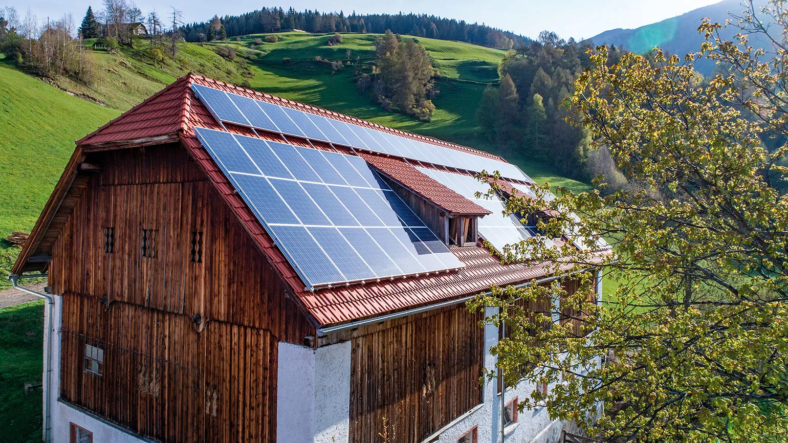

Example of shading from a chimney
A shading simulation using independent simulation software shows that annual shading loss is small.  Basically, two different categories of loss must be considered.
Module-specific partial shading loss: Due to various shading objects – in this case a chimney – sunlight is blocked and less light falls on the solar modules. This reduced light incidence cannot be optimized by any inverter, power optimizer, or microinverter; the only solution in this case is to remove the object casting the shadow.
In contrast, mismatch loss – that is, interconnection loss in strings – can be significantly improved with an intelligent MPP tracking algorithm: as shown in the table, thanks to Dynamic Peak Manager, mismatch loss is about two thirds lower than shading loss at the module level.
