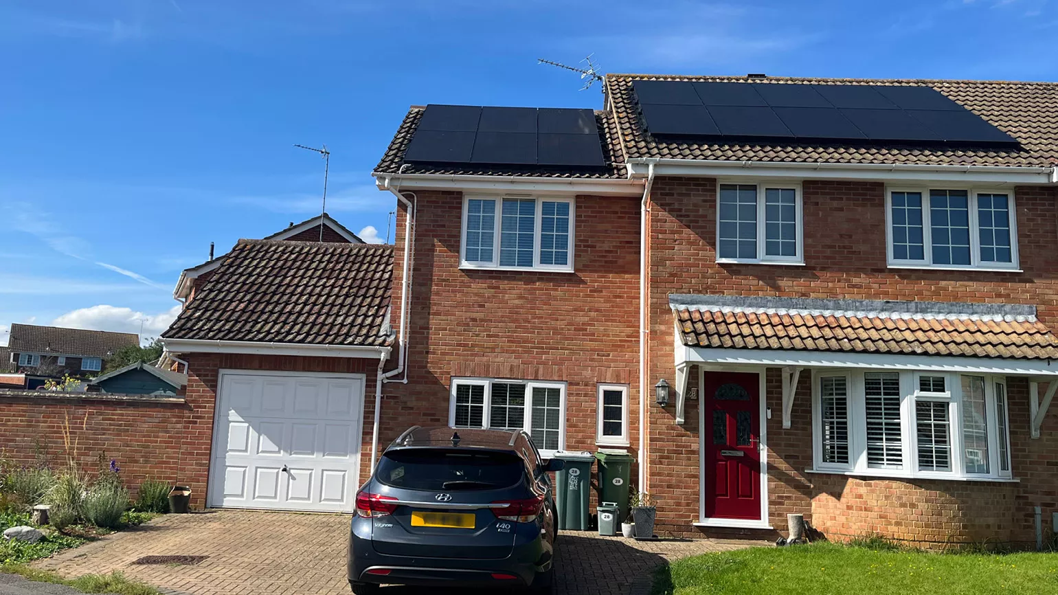

Outside of UK family home with panels on the roof

“An annual electricity bill of zero blows that idea out of the water.” Says David Lee, owner of a 5.76 kW system in Buckingham, United Kingdom.

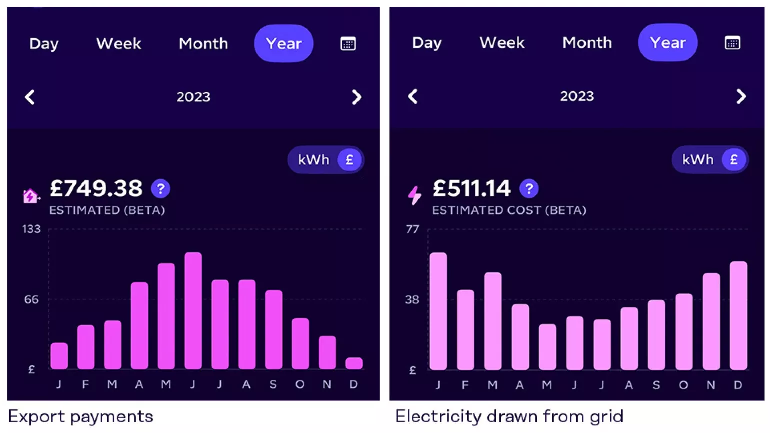

This is when you take both the cost savings and export tariff that the family receive from their energy company into account. The small electricity bill that occurs in the winter months, when there is less sun to generate energy, is balanced out by export payments made by the energy company in the summer when more excess PV is generated. They will have broken even in just a little over six years*. They are currently two years in.

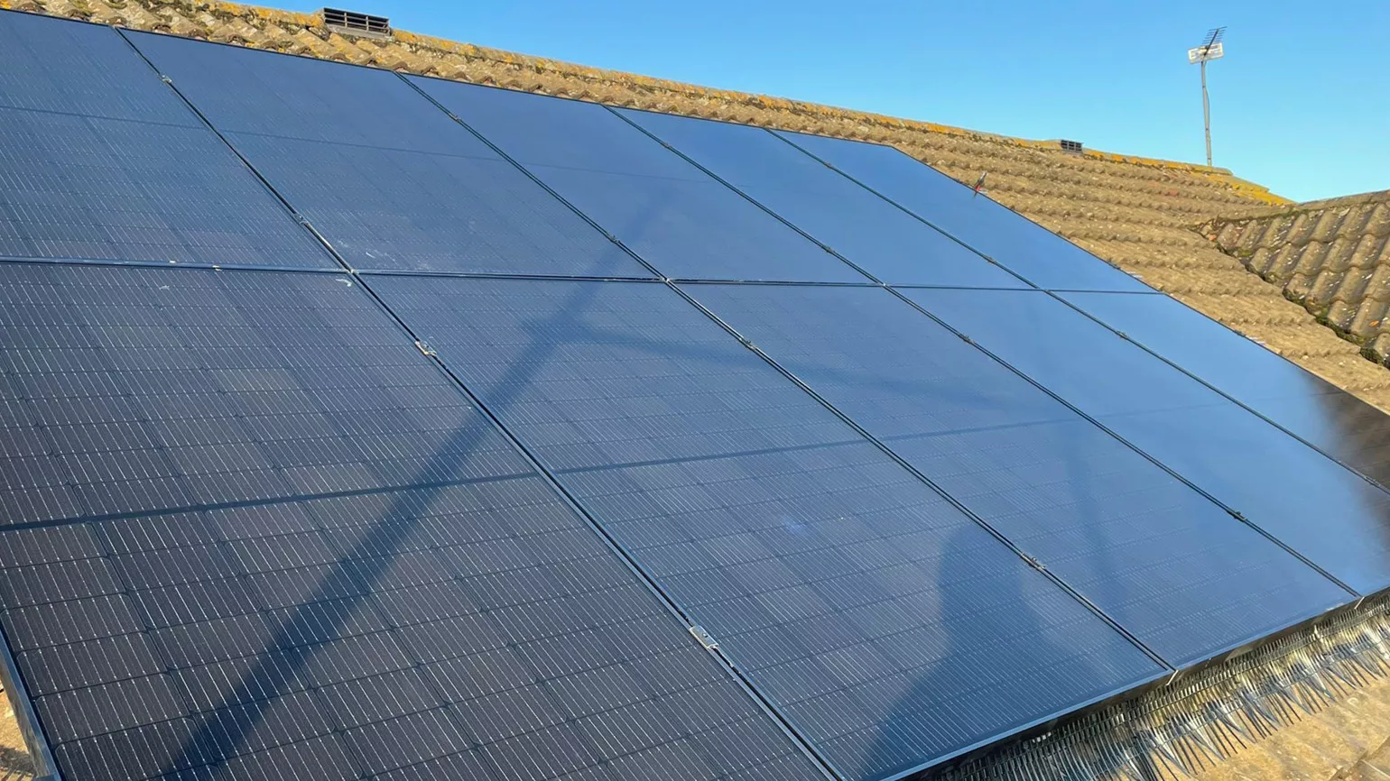

Panels on UK homeowners roof
The first thing we realised was how much credit we were in with our energy company. We got a refund, and drastically lowered our monthly payments

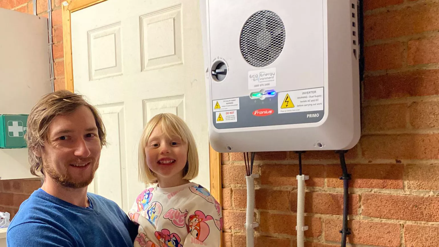

Designed and installed by Fronius System Partner, Eco Energy Environment, a Fronius GEN24 Plus 5.0 inverter was placed at the heart of the system.
This converts the electricity generated from DC to AC so it can be used in the home. Generating this energy are 16 Solarwatt Classic 360W panels, mounted on the south-facing roof.

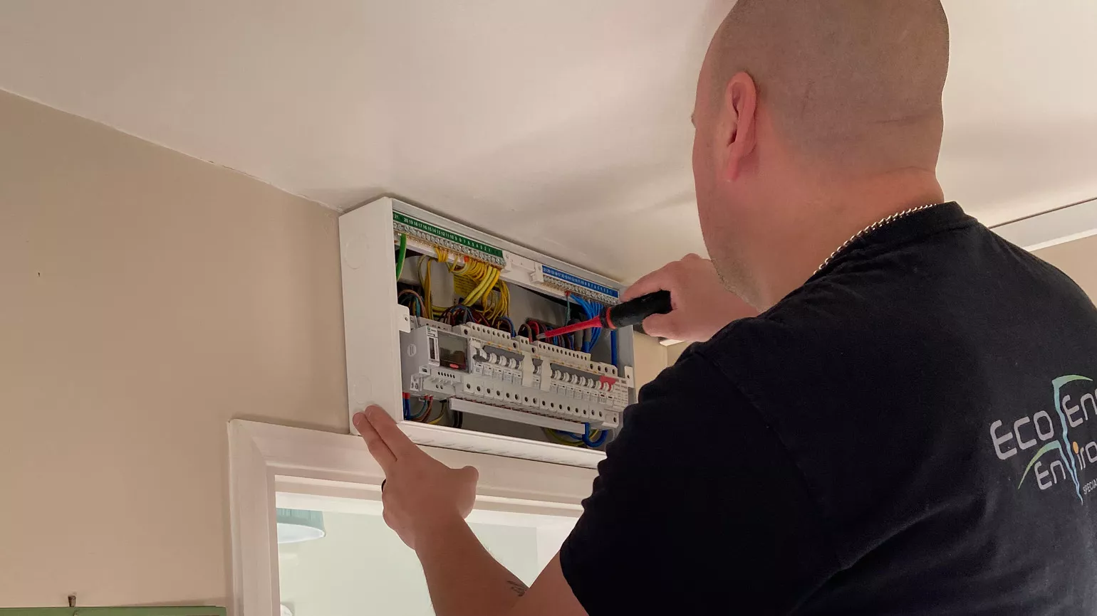

FSP, Eco Energy Environment, installing the smart meter
“The first thing we realised was how much credit we were in with our energy company. We got a refund, and drastically lowered our monthly payments,” says David. “That’s when we really started noticing the savings. What’s more, we have the same provider for gas, so export payments we get are credited to the account and therefore contribute towards our heating bill.”
The family have also ensured that the system is future-proof, opting for a Fronius GEN24 Plus should they wish to introduce battery storage, EV charging or hot water heating at a later date.
