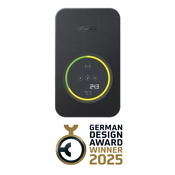

Your energy, your e-mobility. With the Fronius Wattpilot Flex, you can charge your electric car very economically with self-generated solar power. The PV-optimised wallbox automatically switches between 1 and 3 phases to make the best possible use of the sun's power. From 1.38 to 11 or 22 kW (depending on the version), PV surplus is optimally used. No ray of sunshine is wasted.
Thanks to intelligent charging modes, you always have the choice: Eco Mode gives priority to solar power, while Next Trip Mode ensures that exactly the right amount of energy is charged at the right time for your next trip.

The Wattpilot Flex received the prestigious German Design Award 2025 for its excellent product design even before its official market launch. For design enthusiasts, the wallbox is even available in a limited first edition with a special logo variant.
