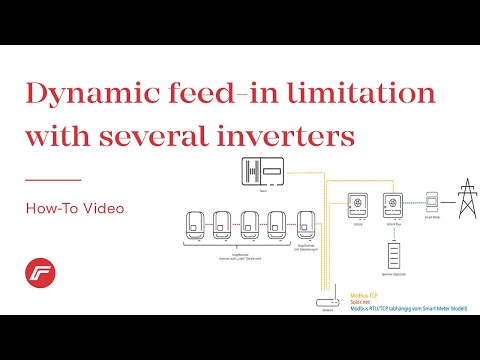

System Power Control
This software update facilitates dynamic feed-in limitation for PV systems with multiple inverters. For active power reduction at the feed-in point, only one Fronius Smart Meter is sufficient to make all relevant settings via the main device (a Fronius GEN24 or Fronius Tauro). This power limitation also works for combinations that include SnapINverters.
See our how-to video here for more details.

      How-To Video: Dynamic feed-in limitation with several inverters
