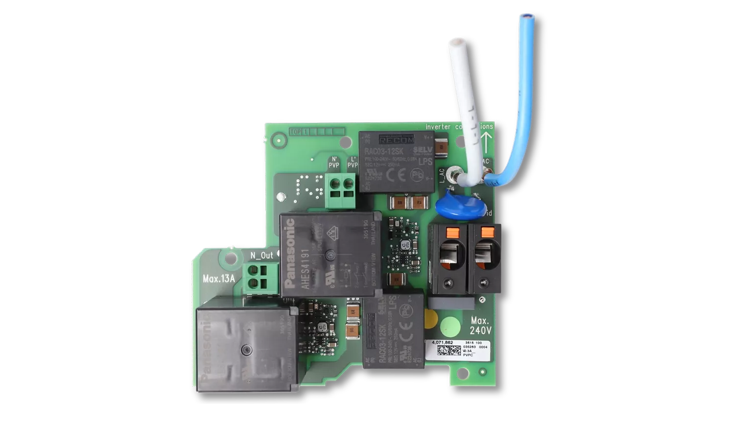

The PV Point Comfort offers a more seamless solution. It provides a power supply to the connected socket or circuit, even during regular grid operation, unlike the standard PV Point. This ensures that critical devices remain powered without needing to plug them in manually during a power outage.
To enable this functionality, an additional circuit board must be installed in the inverter's connection area. The good news is that this upgrade can be done at any time, allowing flexibility for future enhancements.

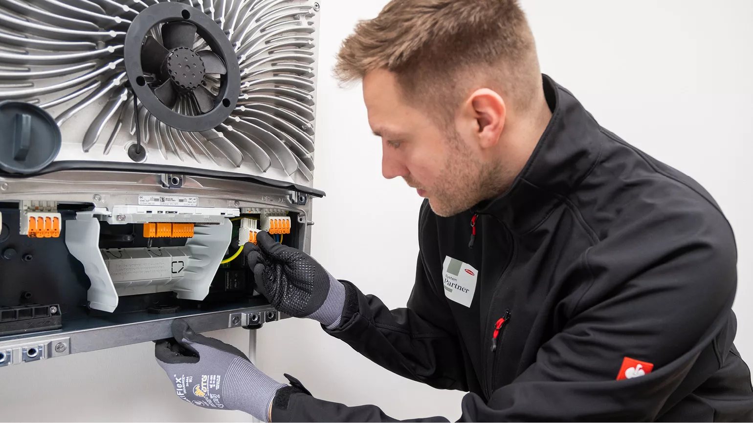

PV installer installing the PV Point Comfort board into a GEN24 inverter

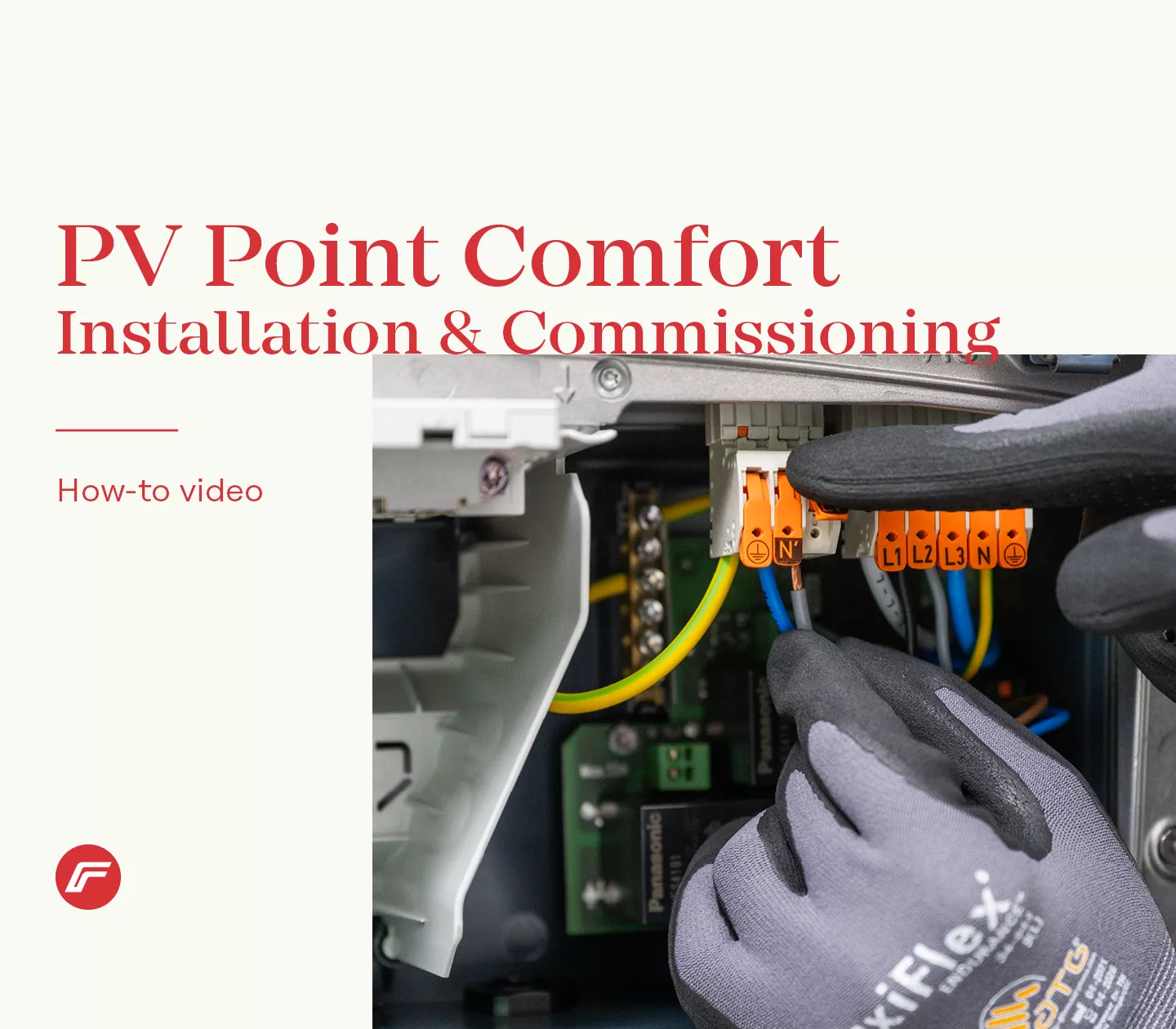

How-to video: PV Point Comfort installation and commissioning video on YouTube
How-to video: PV Point Comfort Installation
Learn how to install and commission the Fronius PV Point Comfort in our short how-to video
You can also download our quick guide here.

PV Point Comfort PC Board
