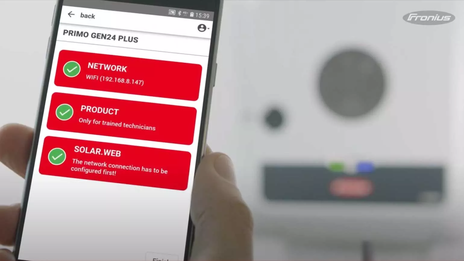

Start up your GEN24 using a smartphone with the Fronius Solar.start app installed. The app will lead you through the process and help you easily connect the inverter to the internet.
Alternatively you can use your browser for commissioning. We recommend bringing a tablet or laptop for this. Connect your device to the inverter's WiFi access point and enter the following IP address into the address bar of your browser: 192.168.250.181
