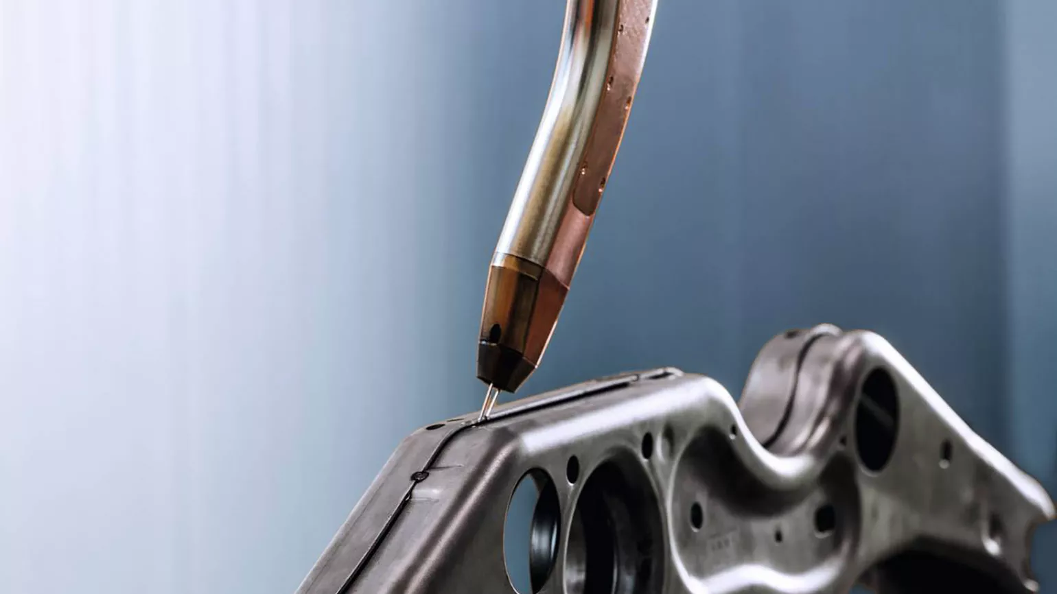

To improve the welding performance even further, Fronius has continued to work on the LaserHybrid technology: the LaserHybrid Twin process utilizes a laser beam as well as two independent wire electrodes with different diameters. These are attached in a special welding head with an internally developed wire supply concept. In contrast to conventional Twin processes, only one motor is used to supply both wires to the welding head. This has the benefit that the welding head is much lighter and more compact than in other systems, which improves accessibility to parts and users can use smaller robots with higher dynamics.
The welding power can be flexibly adjusted via variable electrode diameters. The new welding process offers clear improvements in practice: the laser beam ensures a constant penetration depth, while the tandem gas shielded arc welding reliably bridges gaps.

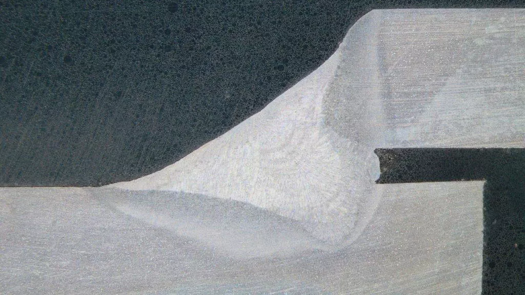

Users benefit from the significantly higher welding speeds, optimal results with fully-reproducible quality, and an enhanced range of applications. For instance, the flange width can be reduced compared to conventional MAG tandem welding. Users particularly benefit from the advantages of the LaserHybrid Twin process when welding lap joints and steel parts – such as in axle production.
3 mm plate, material S355, lap joint, 1 mm gap, laser power 6 KW, welding speed 6 meters/minute
