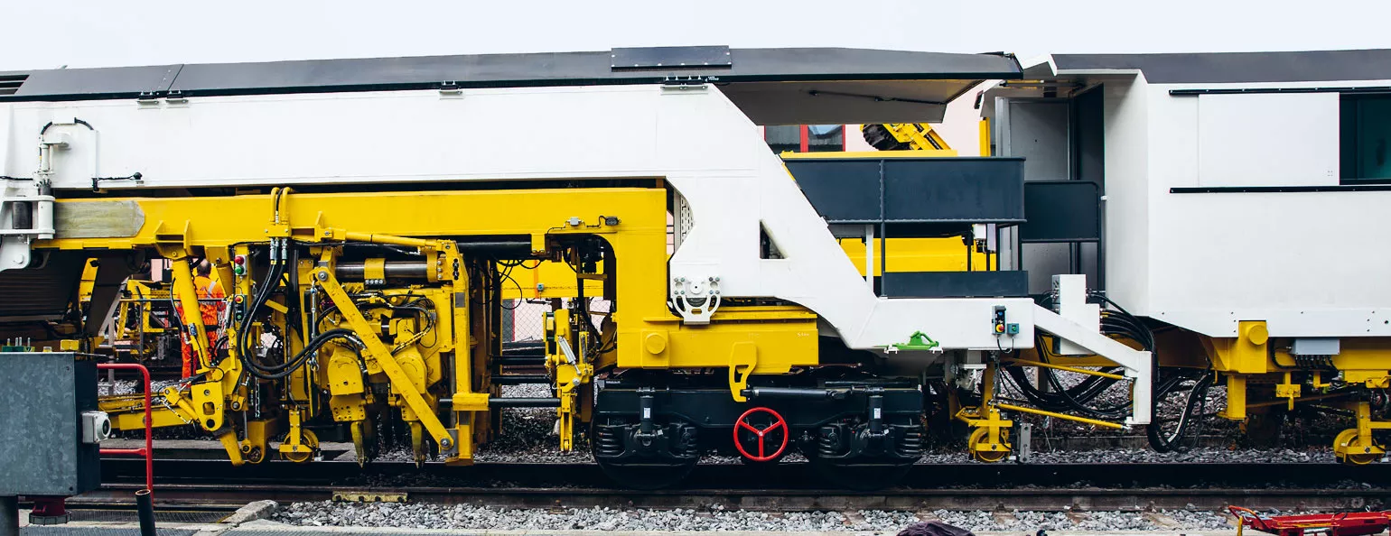

High speeds aren’t the only reason for the growing demand in railroad track-laying and maintenance machines. Ever-decreasing time frames for pending works mean that measuring, construction, and maintenance machines have to manage a heavier workload with greater precision and maximum availability.
It’s for this reason that track construction machines from MATISA are in such high demand. The company, who began manufacturing construction and maintenance machines on the banks of Lake Geneva in 1945, have become a respected name in the industry thanks to the reliability of their machines. In some German-speaking countries, “matisern” (or “matising”) has even become a synonym for ballast bed tamping. Although MATISA pride themselves on the reliability of their machines, they believe that customer satisfaction is every bit as important. Customers from around the world can be sure that they will find a receptive ear when it comes to their special requests.
“This is because there are different track gauges and other regional variations, but also because we consider the supposedly smaller customer requirements. For example, installing a washroom could radically change the construction due to the closely packed design of the train and the altered weight distribution.” This is particularly true if the machine needs to be adapted to the customer’s specific workflows. For this reason, MATISA is rarely able to use standard components on any of its passenger or freight trains, meaning that the Swiss manufacturer produces all of the important parts it needs, including bogies.

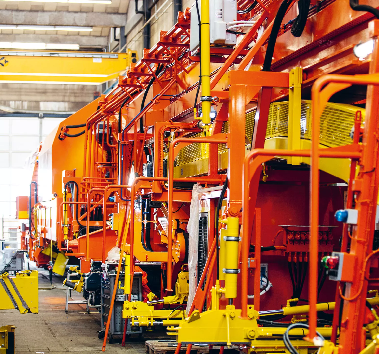

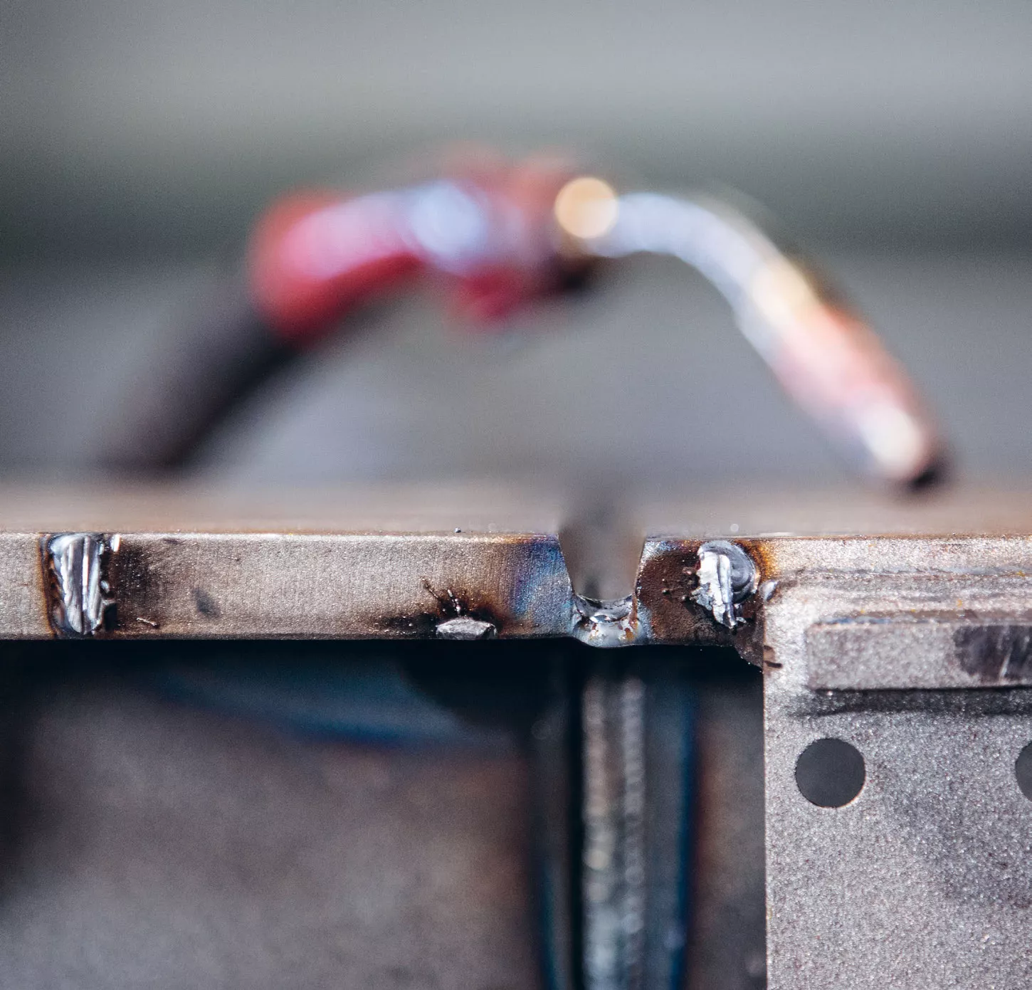

MATISA has therefore kitted out its construction and production departments with the very best equipment. Out of a total 500 employees, 100 are engineers who look after the different levels of electrical and mechanical structures in the trains. Of the 400 staff in the production department, 50 are fitters and welders.

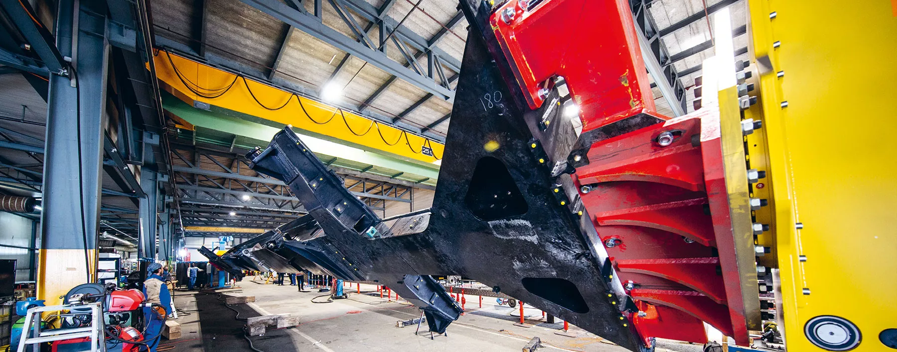

MATISA is EN 15085-certified and processes metal sheets and profiles made from conventional construction steel (S355) with thicknesses of between 10 and 200 millimeters to construct the trucks, bogies, and superstructures. The welding operations are diverse and comprehensive, accounting for around one-third of the time needed to build a tamper. Even for relatively simple products, such as transport wagons, hundreds of meters of weld seams are needed. After all, these wagons are 25 meters long, made out of metal plates with different widths, and are welded together from prefabricated five-by-five meter long box sections.
Each truck must comply with a geometrical dimensional record with extremely tight tolerances. The joining of the box sections with a 25 mm penetration depth is monitored through ultrasound and magnetic testing.
WITH FRONIUS POWER SOURCES – AND ALMOST EXCLUSIVELY MANUAL LABOR

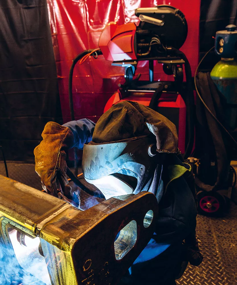

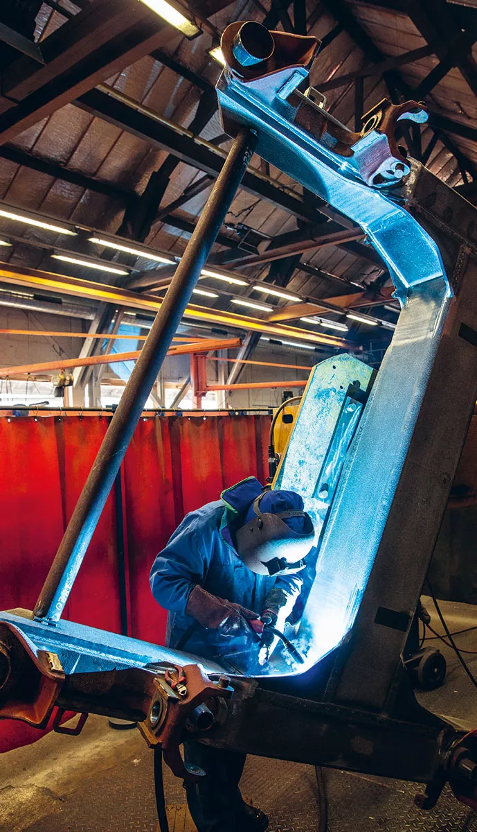

Experts manually weld these and all other weld seams up to two meters long using conventional filler metal (1.2 m Böhler EMK 8 solid wire electrode). Welding is mostly carried out using the spray arc welding process (with plate thicknesses starting at 5 mm), but with longer longitudinal seams, the company uses a type FDV 22 MF battery-powered longitudinal chassis instead, which has a permanent magnet and optional oscillation. The MAG power sources used for manual welding at MATISA are also a Fronius solution.
The five parts of the trucks for the transport wagons are clamped on a positioning device in order to prevent out-of-position welding and to ensure the specified tolerances are met. Now the welders can start welding the box sections together. So that the frame does not buckle or become warped, specific welding sequences must be followed and the frame is turned around regularly to prevent deformation. Finally, the weld seams are subjected to both visual and non-destructive ultrasound and magnetic testing, as these are classified as a welded, safety-related component.
