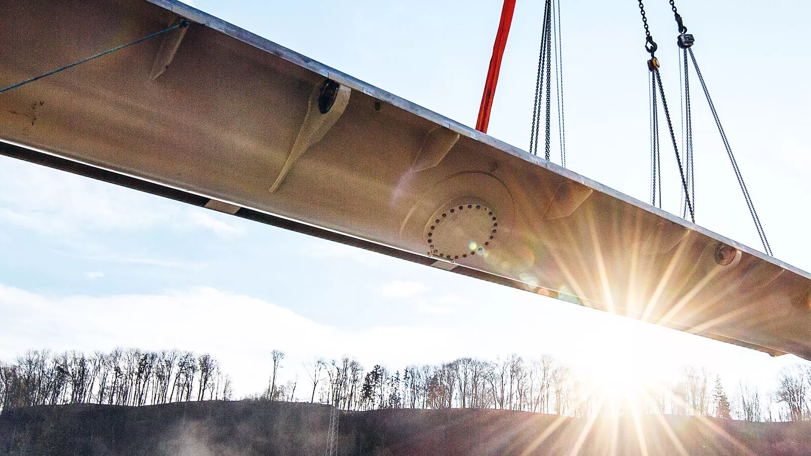

FORTY-FOUR-METER-LONG FISH BELLY FLAP GATE
In run-of-river plants, fish belly flap gates control the level of the water. They owe their name to their arched shape, which is reminiscent of a fish belly and makes them particularly torsion-resistant. For the Traunleiten project, two rotary gates, each measuring 44 meters in length, were ordered, and which are connected to the side wall of the barrage at one end by means of a hydraulic positioning drive. The approximately 2.5-meter-high gates are connected to the threshold of the barrage via a rotation axis. This allows the fish belly flap gate to be raised and lowered and thus the water level to be regulated quickly.
“Due to the transport restrictions, the gate bodies were divided into three segments of up to 16 meters each,” says Bernhard Brindl, Project Manager in the Hydro Division of Bilfinger in Wels. “The parts were joined on the construction site using flange plates with high-strength bolted connections, which requires regular checking of the tightening torque.” A resealable manhole with a diameter of 650 millimeters had to be provided for each Segment.
