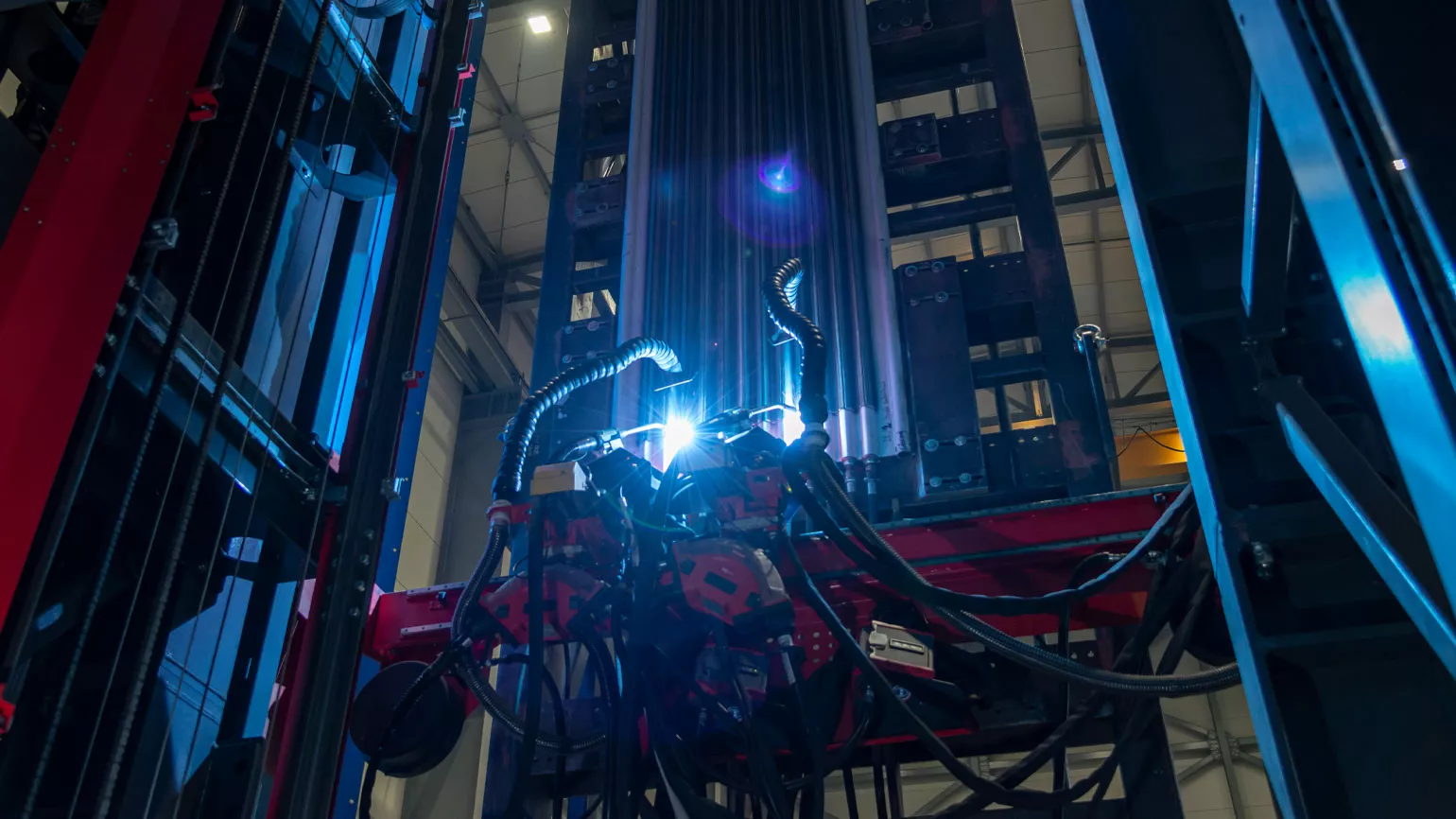

“To surface the finned tubes, we use a cladding tower from Fronius Welding Automation that is approximately 15 meters high,” explains Arkadiusz Osuch, managing director of FAKOP. “It can accommodate two 12-meter-high and 1.6-meter-wide finned walls and is operated by two elevator platforms, each equipped with innovative CMT welding technology.”

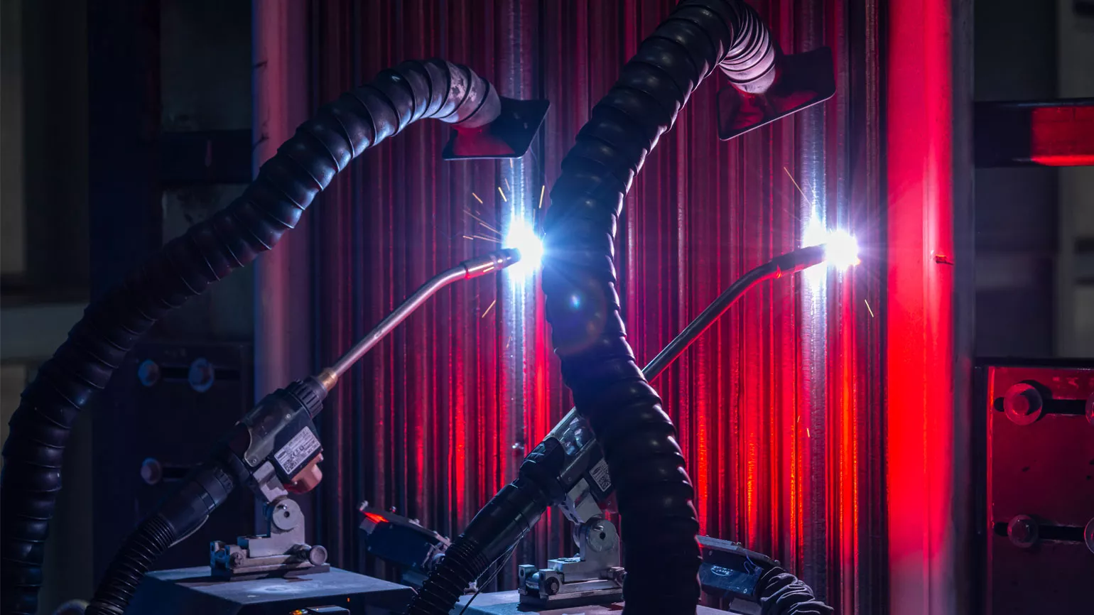

When opting for the Fronius welding tower, a key factor was the use of CMT technology. Its advantage lies in the digital process control, which independently detects short circuits and supports droplet detachment by retracting the welding wire. This creates a back-and-forth motion that keeps the arc phase short and reduces heat input. The result is a material transfer that enables spatter-free cladding results with a particularly smooth surface, soft seam overlaps, and a consistent layer thickness.
“Nowadays, we find the majority of our customers require the CMT process,” says Olej, adding “You can safely say it’s established itself as the standard, and those who know how to use it properly enjoy good opportunities in the market.”
Expertise comes up trumps
Welding expertise and experience are vital. For example, arc stability and the susceptibility to porosity largely depend on an equally optimal and constant wire speed.
“From the inner liner to the welding torch, we are dealing with an enormous wire length of around 15 meters. That’s why it’s difficult to keep the speed completely stable - you need a reliable wirefeeder, a series of tests, and sufficient expertise,” says Piotr Ogórek, technology and development expert, explaining the importance of specialist knowledge in laying membrane walls. “A further criterion is the ideal position of the welding torch, because spatter will occur if the torch angle is set incorrectly,” Ogórek adds.
The stick-out and associated arc length are other significant quality-determining factors which–together with constant wire speed–contribute to reducing porosity. With the help of Fronius, the specialists at FAKOP adapted the properties of their TPS/i CMT power sources to achieve optimum application results without pore formation by adjusting the stick-out accordingly.
High-tech welding tower with outstanding ease of use
Welding is performed with horizontal oscillation from top to bottom in the vertical-down position (PG). Both elevator platforms are equipped with CMT welding technology and have intuitive HMI system controls with touchscreen, an ArcView camera and monitor, two CMT welding torches, and a joystick for fine adjustment.
Since welding torch temperature has a major influence on the dilution rate, all welding torches are water-cooled. To further ensure that the dilution limit of 3% is never exceeded, precise regulation by the plant’s cooling system is required.
One system optimization worth mentioning is the new fine adjustment joystick for the welding torch position. Originally it was necessary to manually move the torch into position using a slide rail. This made fine adjustment almost impossible and always required extreme dexterity. With the ArcView camera and joystick, fine adjustment can now be carried out quickly, easily, and with millimeter precision.
User safety is ensured by fume extractors on each welding torch and a dark-red tinted protective curtain that seals off both elevator platforms, and extends the full height of the system protecting welding operators from UV radiation.
