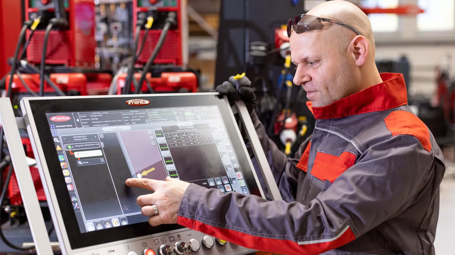

All parameters live and at a glance
The HMI-T21 system controls are ready for Industry 4.0 with a large, intuitive 21-inch touchscreen, multi-user accounts with individually assigned authorizations, process visualization in real time, on-the-fly parameter adjustments, and innovative functions such as X-Ray View, Component Editor, Bore-to-Bore Advanced, actual value monitoring in real time, and STEP file import. And, of course, the system offers remote maintenance capabilities. The X-Ray view provides a transparent outline of the component to give the operator an excellent overview. The Bore-to-Bore-Advanced function offers assistance when several offset transverse bores with non-90° angles or flanges with bores are to be surfaced. All relevant welding parameters are displayed live in the system-integrated actual value monitoring.
A service that meets every need
The welding professional creates components step by step in the Component Editor via the HMI-T21 touchscreen. The height and diameter are defined by inputting the relevant dimensions, and the various components appear in real time as 3D graphics on the screen. In addition to cylindrical shapes, flat and conical shapes are also possible. There are also options to model bores and extensions, such as flanges. The CNC technology now integrated at Fronius creates scope for even more component geometries than before, including intersection bores on conical components.
The welding processes are programmed in the Program Editor. Operators select the individual sections of the components and define the welding sequence. One especially helpful aspect is that the welding torch can be shown at the starting point.
All welding parameters are defined in the Weld Editor. The system offers a selection of jobs with fixed parameters that can be adjusted at any time—even on-the-fly—in the Weld Adjust menu. AVR (Actual Value Recording) records the actual values of the welding current, voltage, wire speed, gas quantity, and welding position during the welding processes in table form. The PC software packages Data Logger HMI and Data Viewer HMI are optionally available for graphical evaluations and analyses.
Once the home position of the welding torch has been calibrated, it moves independently to the starting point for each overlay welding application. Siegfried Wiesinger, overlay welding expert at Fronius, explains: “The remote control can be used to fine-tune a range of parameters even just before igniting the arc—for example, the AVC (Arc Voltage Control) function adjusts the starting point and distance of the welding torch to the component.“
