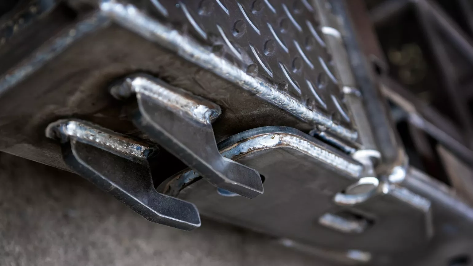

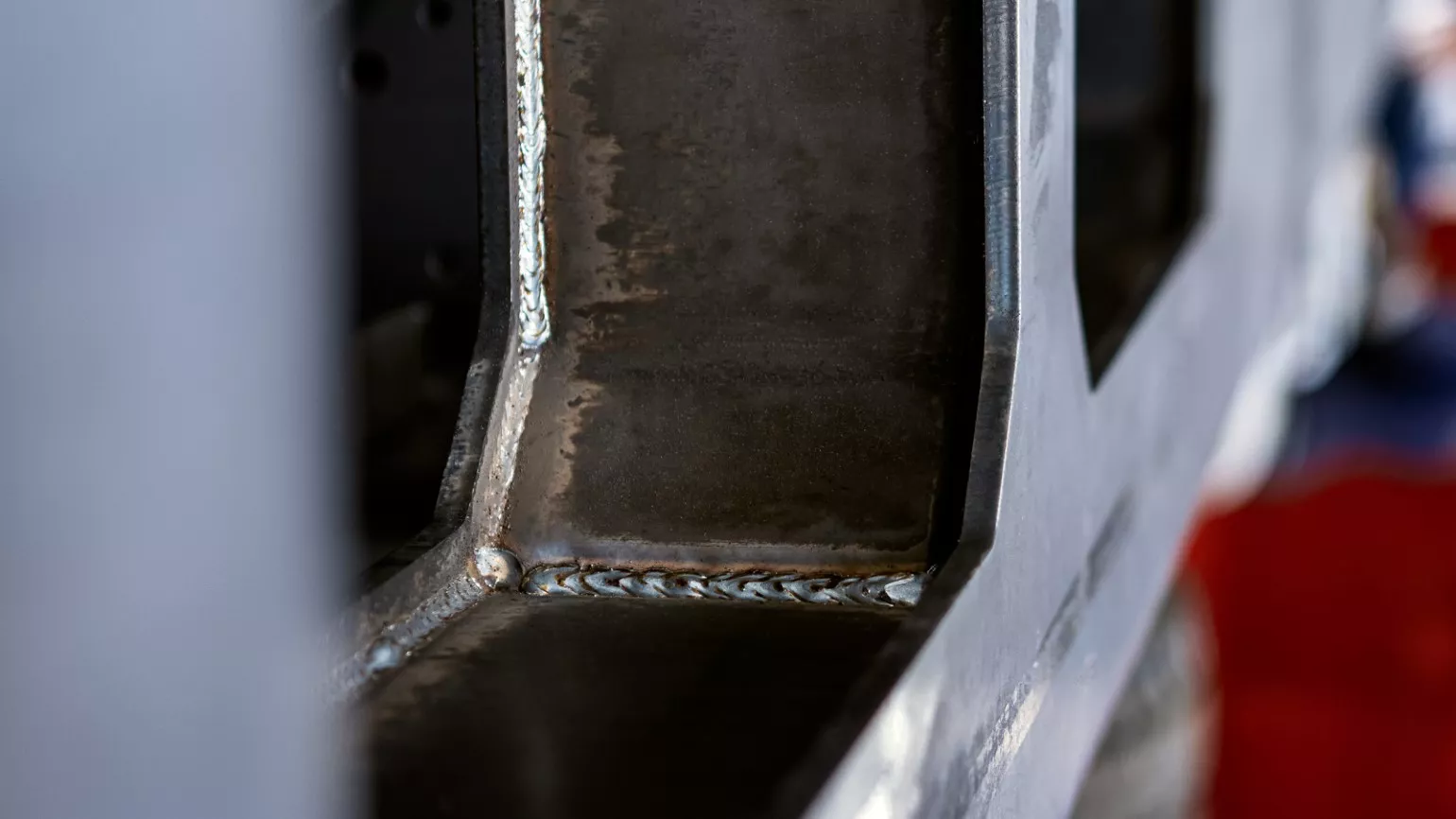

The trailers incorporate a multitude of welded components that must withstand high mechanical stresses such as shock, vibrations and torsion. “We take great pride in our weld quality. Defective welds can lead to significant issues and so we have very strict standards regarding the quality of our welds. We focus particularly on ensuring flawless welds in the load-bearing parts such as the load support structure or subframe, where we use high tensile S700MC steel. Additionally, we ensure that all welds are aesthetically pleasing as they are visible on the exterior of the trailers.” Continues Artūras.

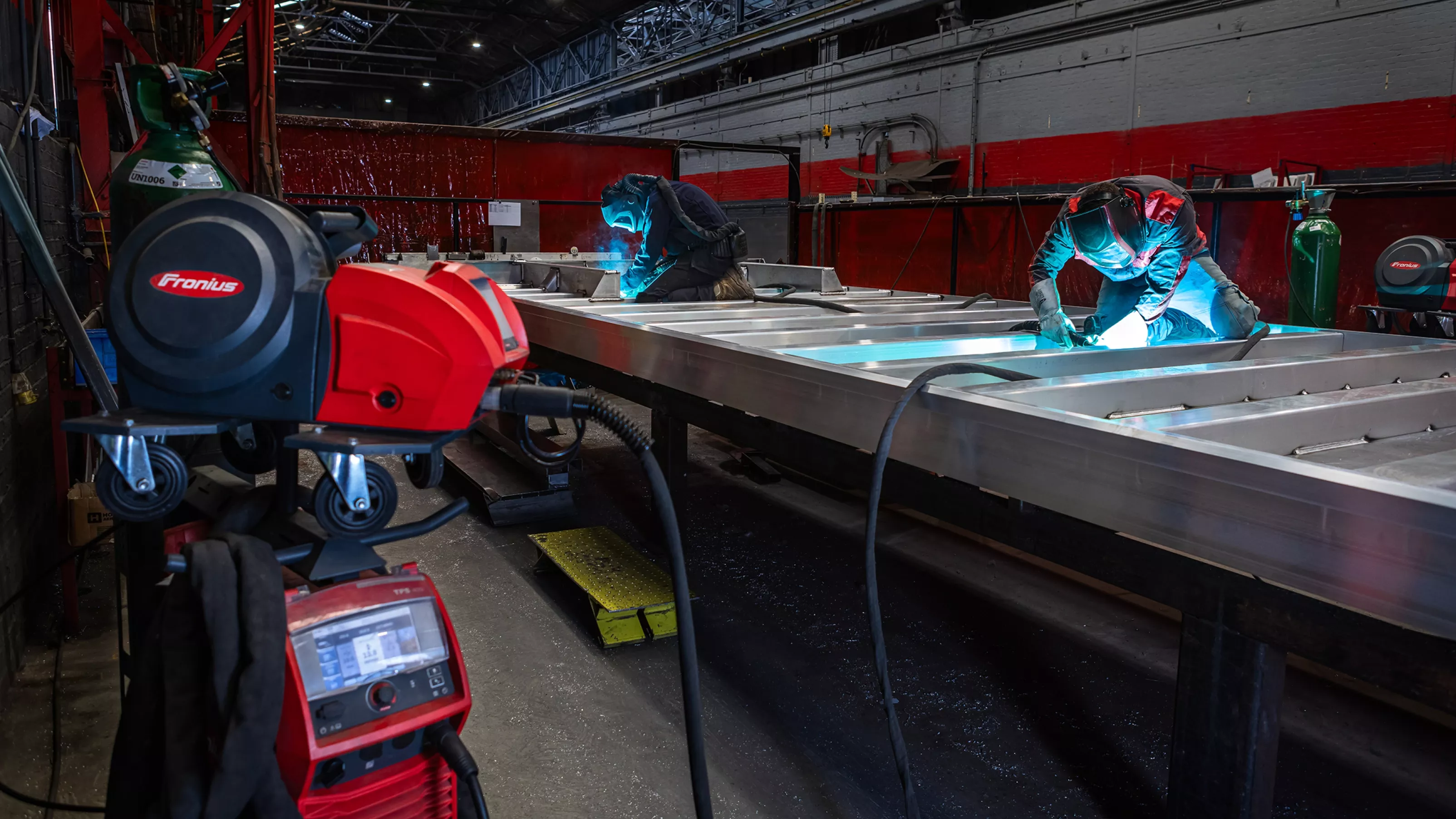

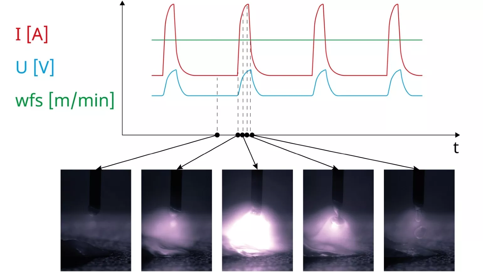

The TPS 400i is equipped with intelligent control systems that allow precise adjustment of welding parameters. Penetration and Arc Length Stabilisers ensure consistent weld quality by maintaining the desired penetration and arc length, which aids in controlling the heat input more effectively. The TPS/i can be customised with various software packages to meet specific welding requirements. The Pulse feature is typically used at Fruehauf to ensure the thicker top rail receives sufficient heat for fusion, while the thinner panel is protected from overheating. Pulse technology enables the arc to alternate between high peak current and a low background current. This reduces heat input, minimising distortion and burn-through, which is especially critical when welding thin to thick materials. The controlled droplet transfer in pulse mode also reduces spatter and enhances weld bead appearance.

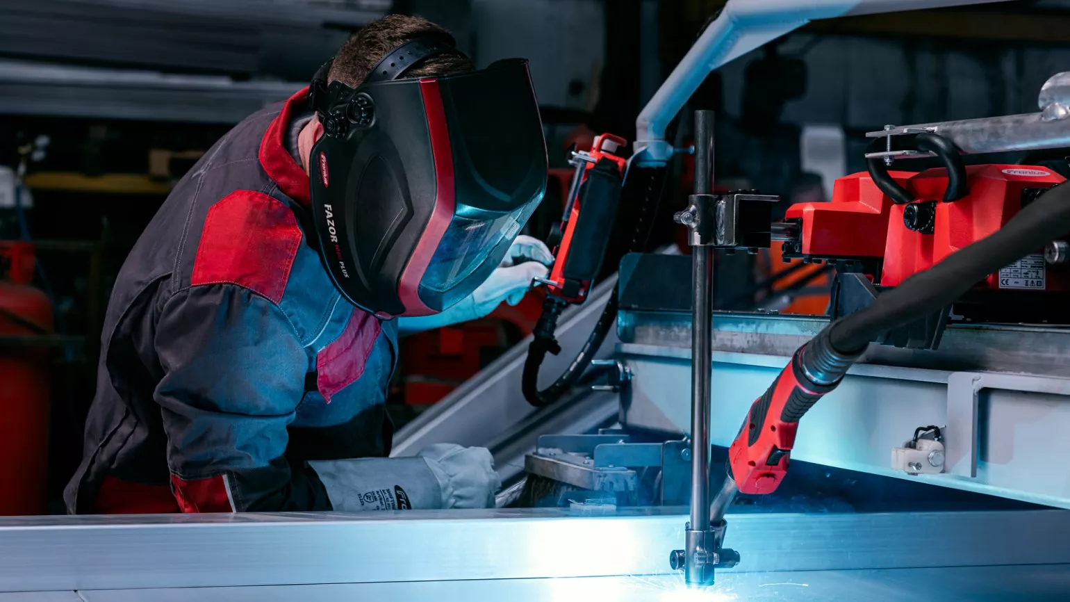

Artūras explains that after several months of testing and modifications to tailor the welding process for side panels in Fruehauf’s Research and Development department, the versatile FlexTrack 45 Pro has been used in production since June 2024. It is utilised daily for a minimum of eight hours, with significant advantages including the consistent quality of the weld, thanks to precise movements, steady welding speeds, and improved comfort for the operator. Additionally, he notes that the company has managed to save roughly one hour per sidewall in welding time, translating to approximately 800 to 1,000 welding hours annually. With current labour rates, these time savings amount to financial savings of £20,000 to £25,000 per year, with the return on investment being achieved in under two years.
Today, it is difficult to envision our aluminium body production without the FlexTrack welding equipment. It ensures perfect reproducibility of welding results, especially when used with the TPS/i welding source,” Artūras states. “We have also found the FlexTrack to be very reliable. We have been operating this application for 18 months without experiencing a single breakdown.”

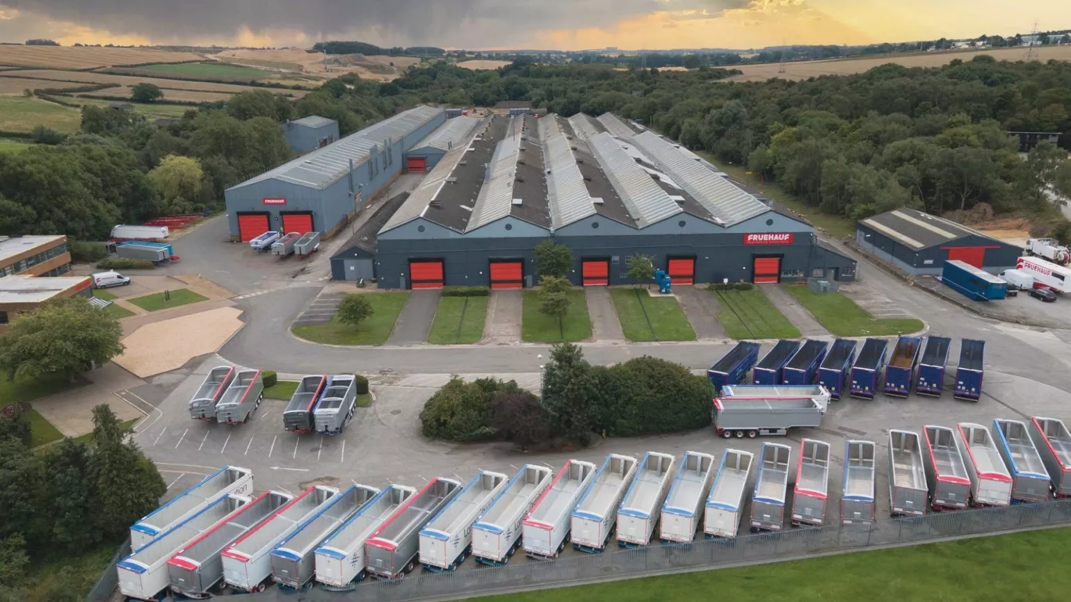

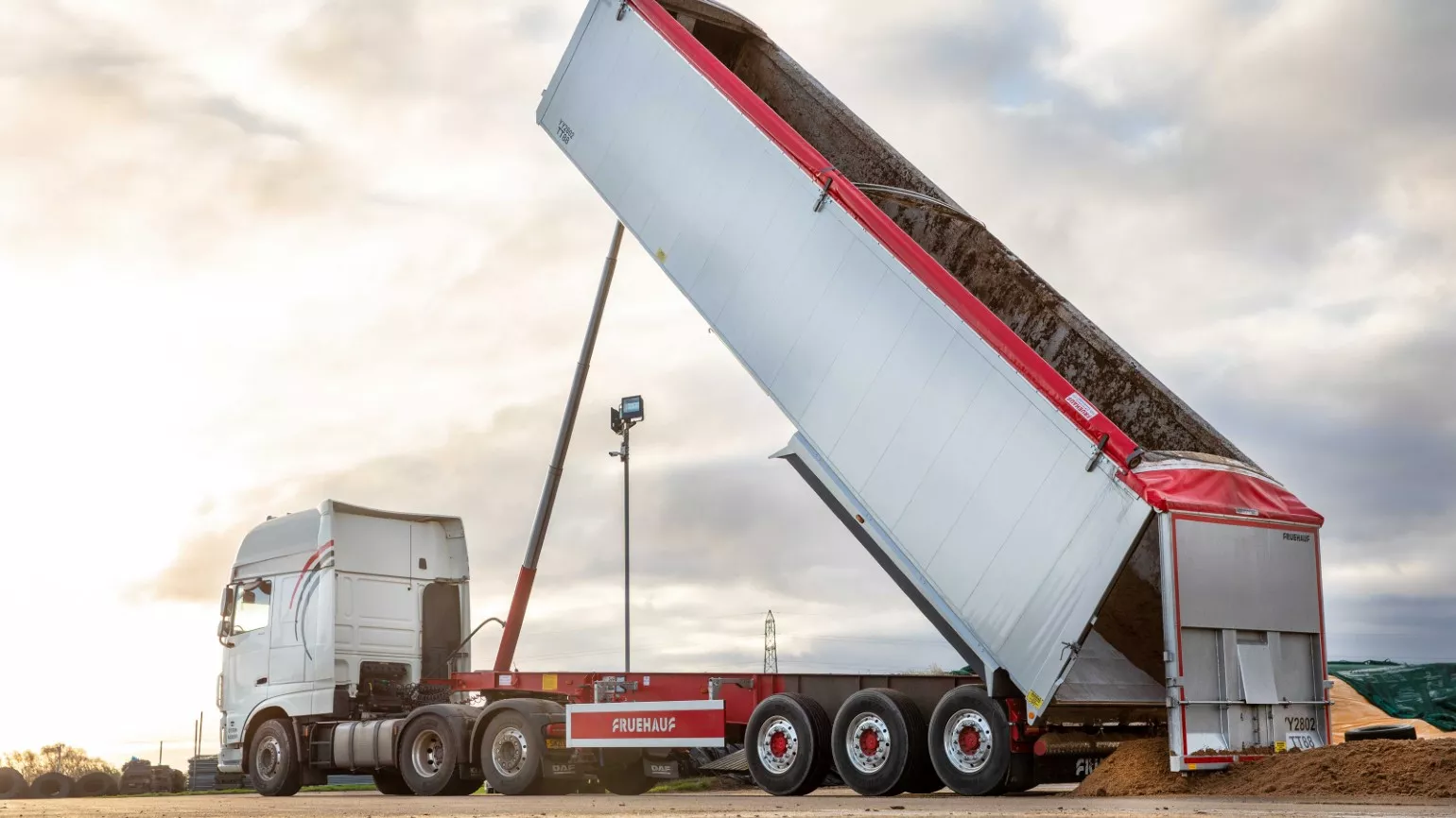

Fruehauf manages the entire manufacturing process for their tipping and bulk trailers at their 64-acre Grantham production facility
Fruehauf designs and manufactures robust and dependable trailers that meet the diverse needs of the agriculture, aggregates, waste management, and haulage sectors.
The power source being used here to weld the trailer body is the Fronius TPS 400i

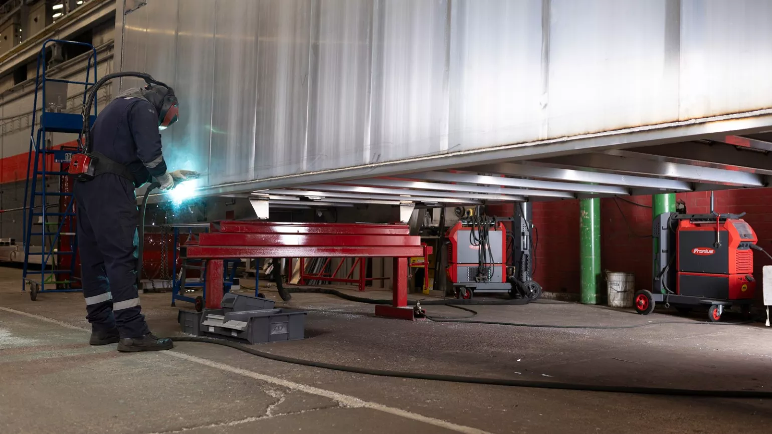

Oleg Bahmanis welding the body of a sloper trailer, using PC, horizontal position welding. The power source being used here is the Fronius TPS 400i
Jaan Zabolotski operating the FlexTrack 45 Pro welding carriage on the specifically engineered assembly jig. The power source being used here is the Fronius TPS 400i

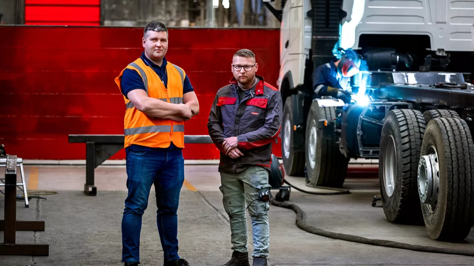

Artūras Mitunevičius, Production Director and Jaan Zabolotski in the production hall (from left to right)
