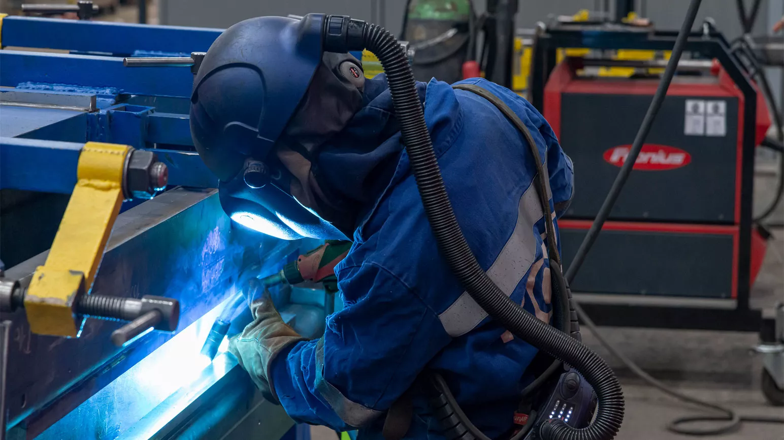

The experts at Tatravagónka rely on the TransSteel 5000 Pulse from Fronius. With up to 167 optimized characteristic curves, it has process variants that are in demand in many industries. Its versatility is particularly evident in its design featuring the pulse function, with the welding machine delivering outstanding results for aluminum, steel or stainless steel. Pulse welding enables higher welding speeds for larger material thicknesses while also generating significantly less welding spatter and reworking compared to the standard process: a tangible commercial benefit for Tatravagónka. If welding work is carried out in awkward conditions using the pulsed arc (for example overhead), the arc pressure can be increased using the pulse correction feature. This prevents the weld pool from escaping.
The dynamic correction feature can be used if more penetration is required for optimal root formation when welding thinner sheets with the standard arc. A harder and more stable arc can be generated by reducing the short-circuit dynamics at the moment of droplet transfer. When welding thicker sheets with the standard arc, a soft, low-spatter arc can be generated by increasing the short-circuiting dynamic. In special 4-step mode, it is also stabilized during ignition by reducing the power. Tatravagónka welders can place uniform welding spots at regular intervals using spot mode. The pause time between the intervals can be freely selected and is therefore ideal for tacking workpieces.
“Welding in overhead and horizontal positions (PE and PC) requires special skills from our welders. The welding equipment also plays a crucial role in achieving the required results,” explains Jaroslav Nemergut, Technical Director at Tatravagónka Tlmače. “Fronius has the perfect welding machine for our needs in the form of the TransSteel 5000 Pulse and its functions for welding heavy steel. But that’s not all: The customer-friendly service package also included bespoke commissioning training and a specially developed custom solution for supporting and routing our hosepacks.”
