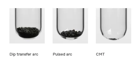

During welding, the wire moves forward and is pulled back again as soon as the short circuit occurs. As a result, the arc only introduces any heat for a very brief period during the arc-burning phase. The result is spatter-free material transfer. The arc remains stable, regardless of the surface characteristics of the workpiece or how quickly the welding specialist works. This means that CMT can be used anywhere and in any position.
CMT Cycle Time
CMT process visualization
Welding does not inevitably have to mean welding spatter and rework. CMT promotes controlled droplet detachment during the short circuit, while the current is kept low. The result is virtually spatter-free material transfer.

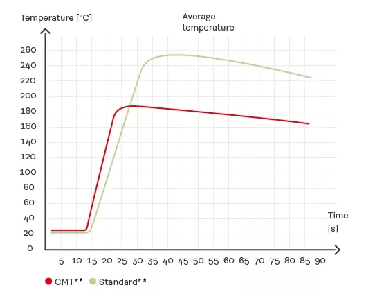

Reduced heat input
*Compared with standard dip transfer arc
Heat input at the lowest level: as soon as the short circuit occurs, the wire is pulled back again during the CMT process. This means that the arc only introduces heat for a very short time.
As a result, CMT enables continuous regulation of the heat input from cold to hot. In addition, higher welding speeds and a wider range of applications* are possible with maximum weld quality.
Reduced heat input
* Compared with standard dip transfer arc
**1.5 mm steel plate FW, PB 1.5 mm steel plate FW-TJ PB

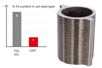

CMT Cladding
CMT cladding
The characteristic for cladding with low penetration, low dilution, and wide weld seam flow for better wetting
More information on cladding
CMT cladding: 75% less dilution of base and filler metals
In conventional overlay welding, the arc fuses a relatively large amount of the base material.
The typical dilution and mixing of base material with filler material reduces the corrosion resistance of the applied layer. However, the base materials are melted to a lesser extent due to the lower heat input of the CMT process. This results in up to 75% less metallurgical mixing of the base and filler materials, and reduces costs for overlay welding.

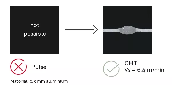

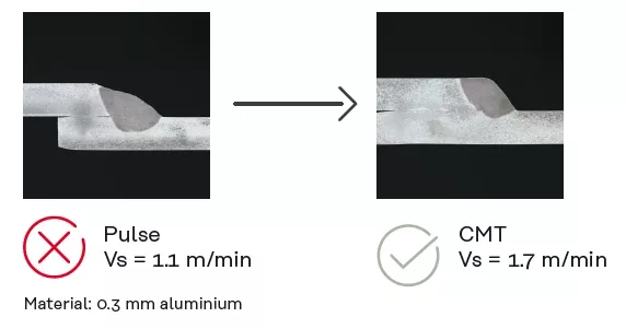

Light gauge (≤ 1 mm) aluminium sheets can be welded.
The low heat input of this process means that weld-pool support isn't necessary to keep the weld from dropping through.

Light gauge sheet
Light gauge sheet
