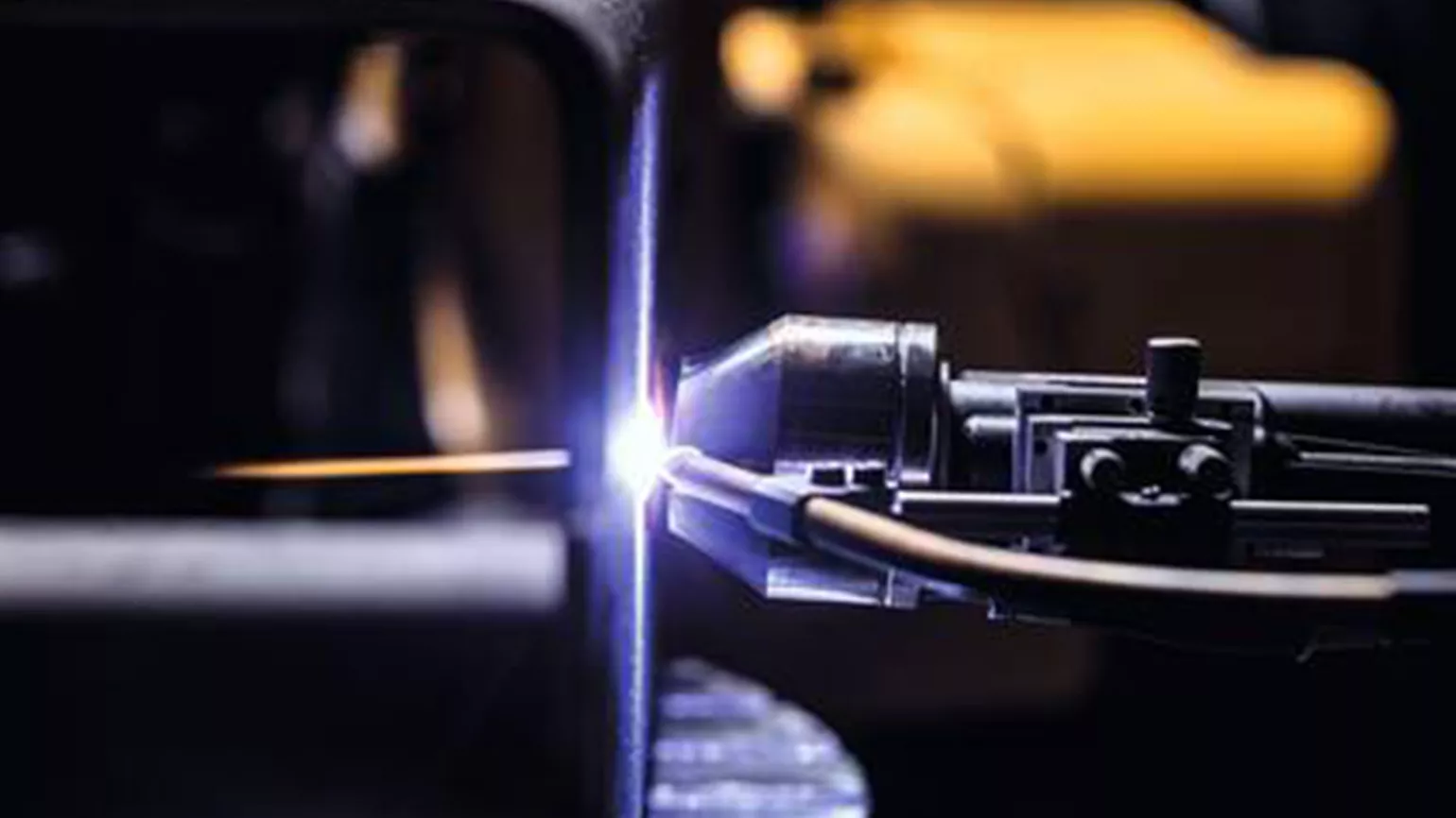

Tungsten inert gas welding (TIG welding) is a gas shielded welding process and is one of the fusion welding processes. It is used wherever optimum quality and spatter-free weld seams are required. TIG welding is suitable, among other things, for stainless steels, aluminum and nickel alloys as well for thin sheet metal made of aluminum and stainless steel. It is used in pipeline and container construction, in portal construction and in aerospace applications.
TIG welding: This is how it works
In TIG welding, the required current is supplied via a tungsten electrode, which is temperature-resistant and does not melt. This electrode emits an arc that heats up and liquefies the material. There is a nozzle for shielding gas around the electrode. This protects the heated material from chemical reactions with the ambient air. The noble gases argon, helium or mixtures thereof are used for this purpose. The inert, i.e. non-reactive, gases prevent chemical reactions with the liquid weld pool and the heated material. This ensures high-quality weld seams.
As the tungsten electrode does not melt, in TIG welding the filler material is fed in by hand or in mechanized form by an external wirefeeder.

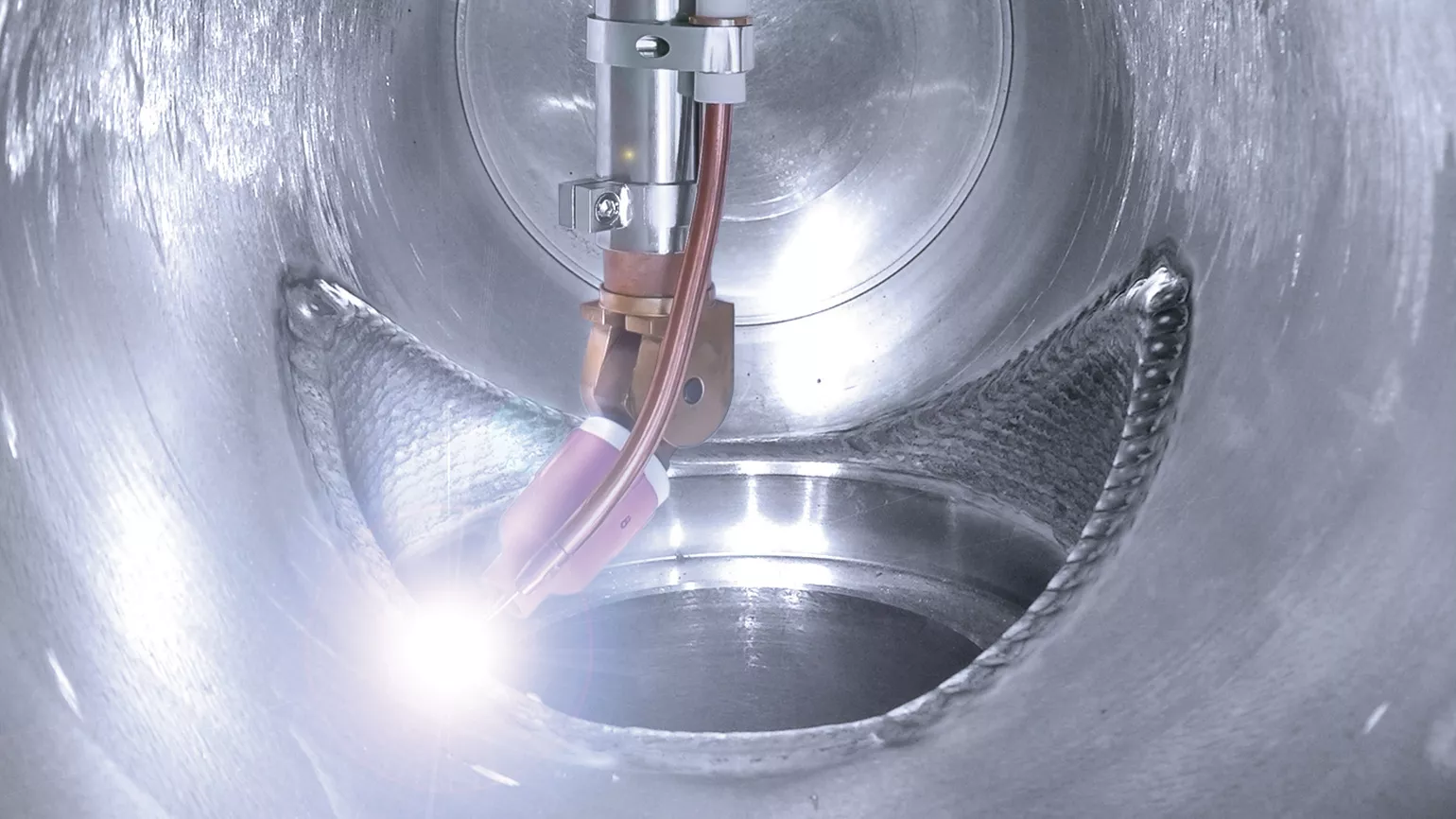

ArcTig
The ArcTig welding process is a TIG process variant for mechanized joint welding. It allows for an excellent weld seam appearance, reliable full penetration welding of the root pass and very high weld quality. Due to the increased welding speed and reduced work to prepare the seam, ArcTig also makes the whole welding process more cost-effective.

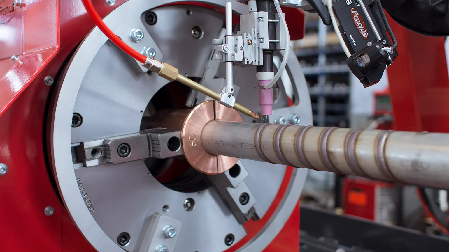

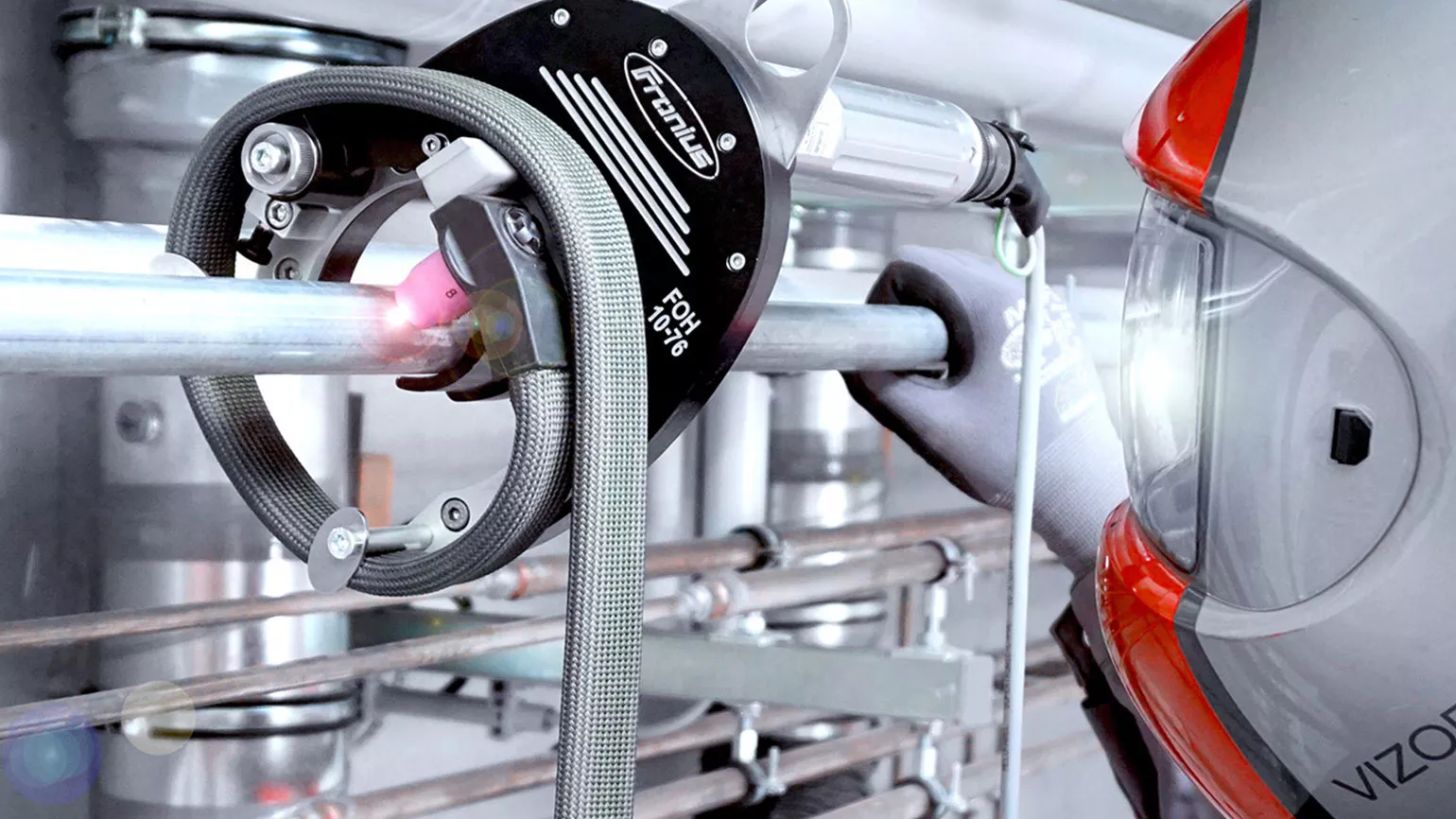

Orbital welding
The basic setup of orbital welding equipment includes a fixed pipe and a moveable TIG welding torch/welding head that moves around the pipe. The moveable orbital welding head is also referred to as a spot welding gun. The orbital welding technique is useful wherever consistent seam qualities must be attained under controlled conditions. Consequently, the main usage areas for this welding technology are pipeline construction, the food industry, and the chemical industry. With the orbital technique, it is not only possible to produce pipe-to-pipe connections, but also to weld pipes into pipe baseplates.
