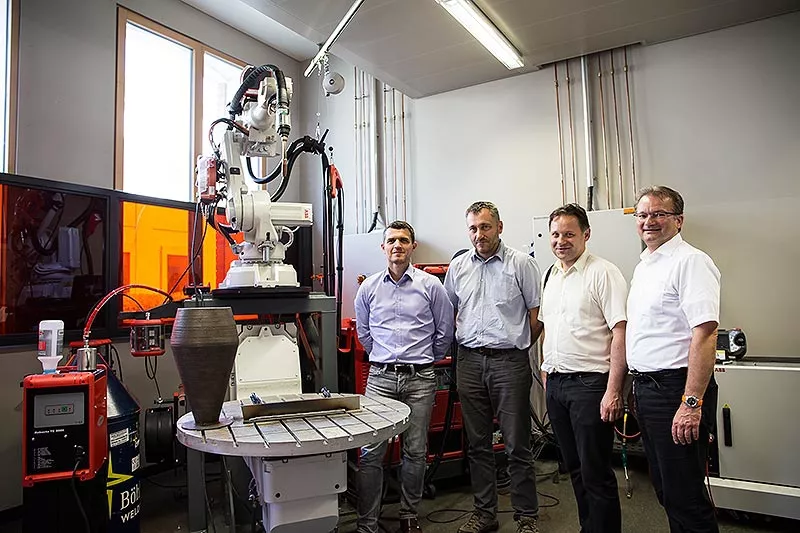

Goran Dzomba (Fronius International), Dr Drago Bracun (University of Ljubljana), Assistant Professor Damjan Klobcar (University of Ljubljana) and Dr Gerhard Posch (Fronius International) (right to left) next to a vase created at Fronius using the CMT welding process and additive welding.
