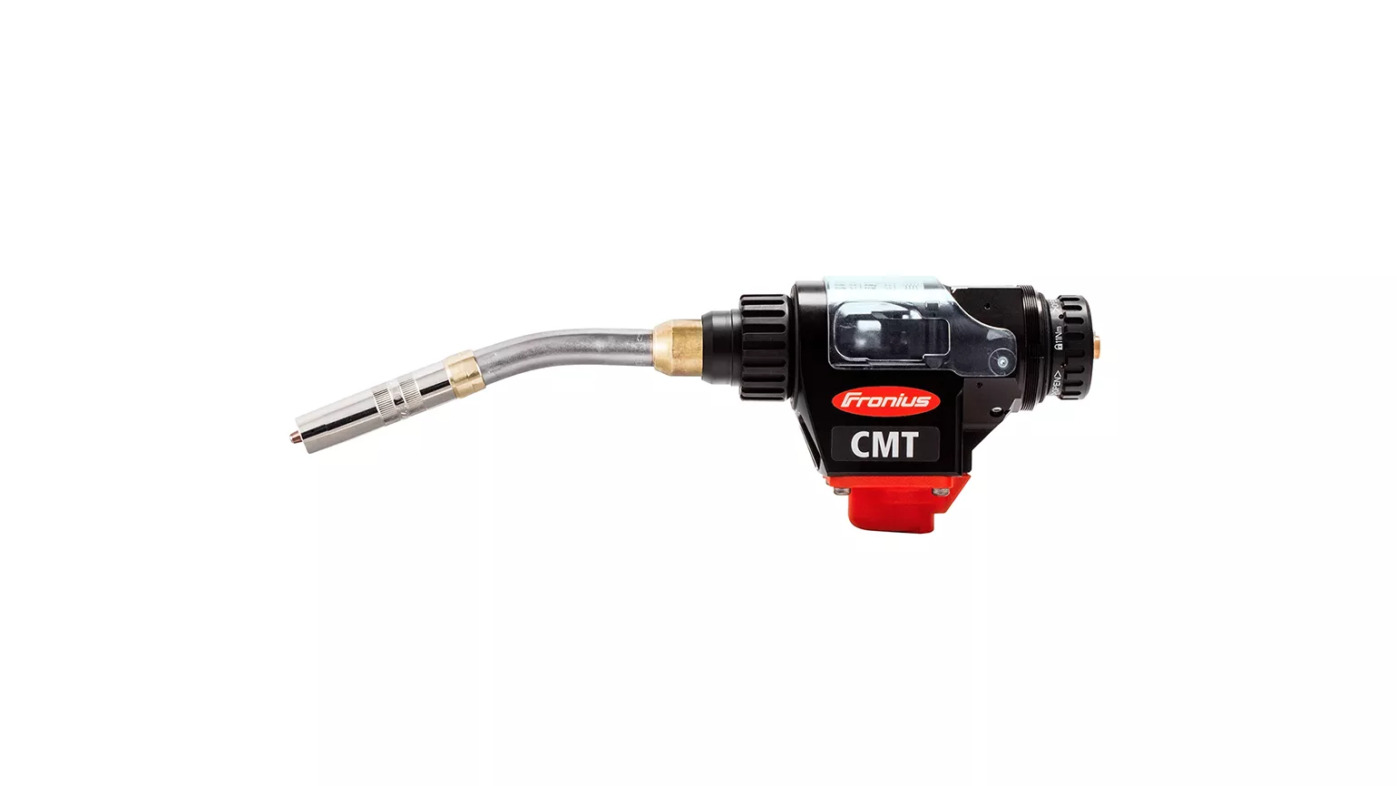

WireSense uses the wire electrode not only for welding, but also for measuring component geometries. Thanks to the high-frequency, reversing wire movement, the system detects precise component and seam geometries, edges, height differences, and air gaps—and all without any additional sensor hardware. The benefits of WireSense are particularly pronounced on reflective surfaces such as aluminum, where optical systems such as cameras often fail.
“The measurement is contact-based and works on the basis of a weld-free short circuit being established. What’s more, WireSense is compatible with all standard filler metals,” explains Philipp Schlor, Strategic Product Manager at Fronius International. “The Fronius welding machine—an iWave or TPS/i—detects edges or impacts and transmits this information to the robot controller. This then compares the data with the programmed path and automatically corrects the tool center point (TCP), ensuring that the seam is always welded at exactly the desired location.”

The assistance system requires a CMT-Ready setup consisting of the Robacta Drive CMT drive unit and the corresponding CMT wire buffer as well as the WireSense software package (the CMT software itself is not required). It is integrated via the Fronius welding machine, which transmits the sensor signal to the robot controller at lightning speed. Fronius works closely with robot manufacturers so that all the most common robots can process WireSense signals without issue.
