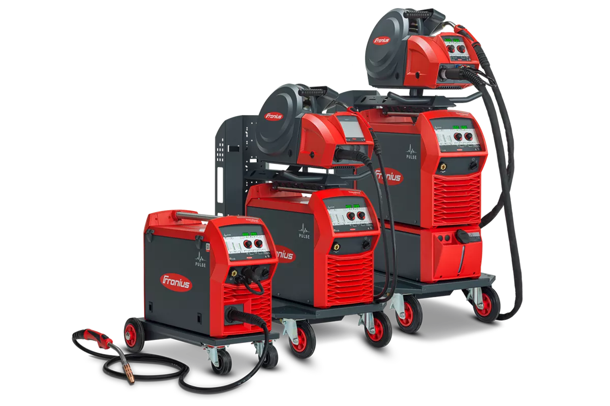

Easy Documentation
Welding data documentation for TransSteel* devices
Welding data documentation is essential, particularly in steel construction. Load-bearing steel structures, mass-produced products or sensitive parts often have to be traceable down to the final welding parameters. The Easy Documentation option enables TransSteel* to record welding data extremely easily.
*except TransSteel 2200C and 2700C and TransSteel devices with production date before July 2020

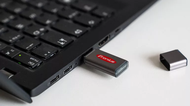

  1. Simply plug the USB flash drive into the back of the welding system (included with the Easy Documentation option)
  2. Check the time and date

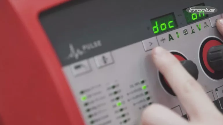

  3. "doc | on" is displayed on the control panel
  4. From now on, your welding data will be saved as a CSV file with a Fronius signature
  5. Simply transfer data via USB flash drive, generate a PDF report and check the authenticity of the data using the Fronius signature
