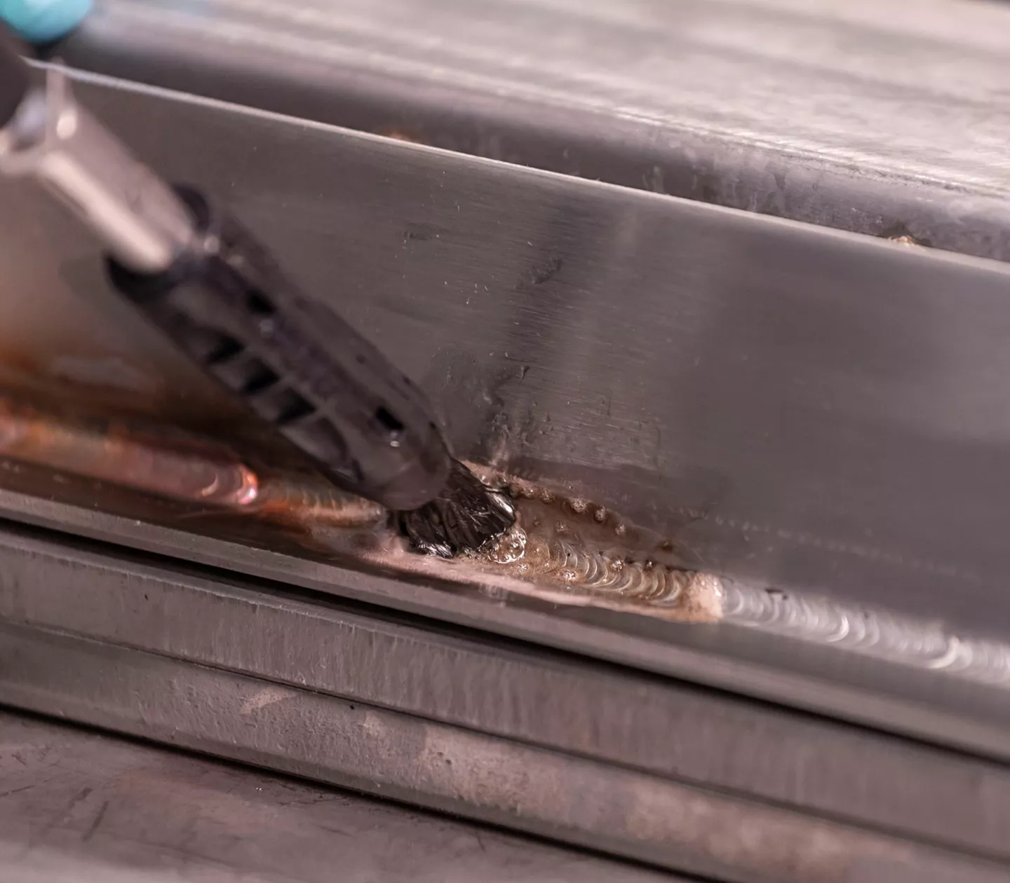

1. Cleaning
The electrochemical cleaning process uses alternating current (AC) and electrolyte fluid to remove and passivate temper coloration after welding.

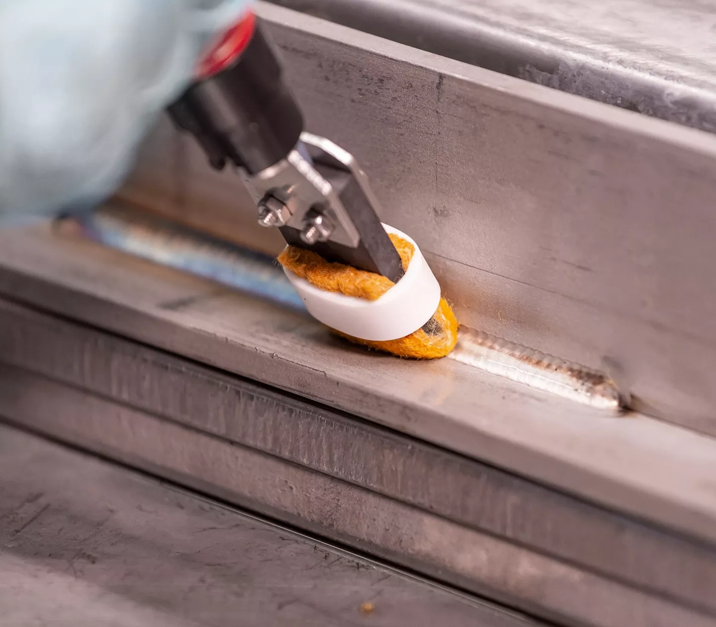

2. Polishing
Electrochemical polishing is a process in which part of the base material is removed from the workpiece and the surface is lightened: The result is an even shine after cleaning. This improves the passivation process of the stainless steel.

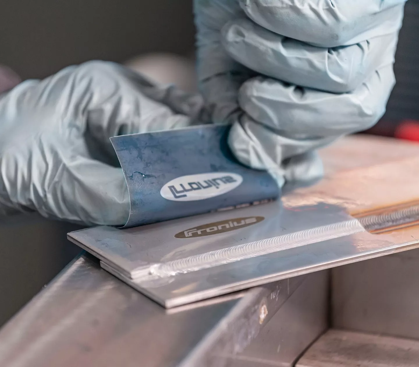

3. Printing
For permanent marking of stainless steel with company logos, item numbers, barcodes, etc. Alternating current (AC) is used for black printing and direct current (DC) for white printing. The perfect alternative to stickers or laser engraving.

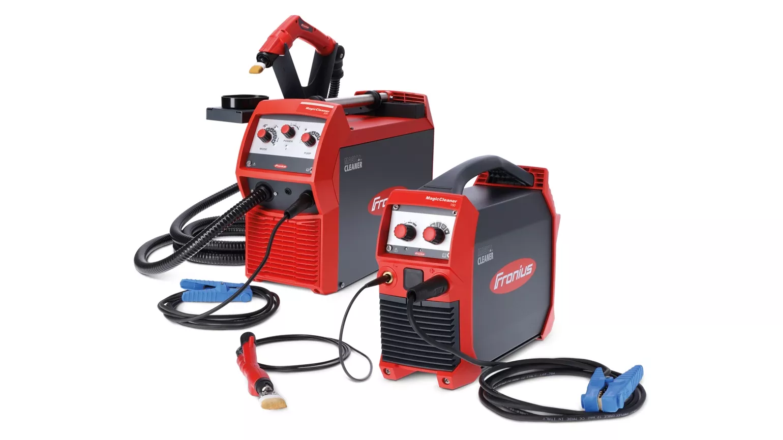

The MagicCleaner variants
MagicCleaner comparison
Features / properties  MagicCleaner 150 MagicCleaner 300
Cleaning AC 🗸  🗸
Cleaning DC  🗸  🗸
Printing (AC & DC)  🗸  🗸
Integrated pump  🗸
Power  15 A  30 A
Cleaning torch MC150  🗸  🗸
Cleaning torch MC300  🗸
Cleaning fluid (capacity) 100-ml tube  1.8-l tank
ToolCase 60 🗸
ToolCase 120 🗸
ToolBox 210 🗸
Trolley available 🗸
