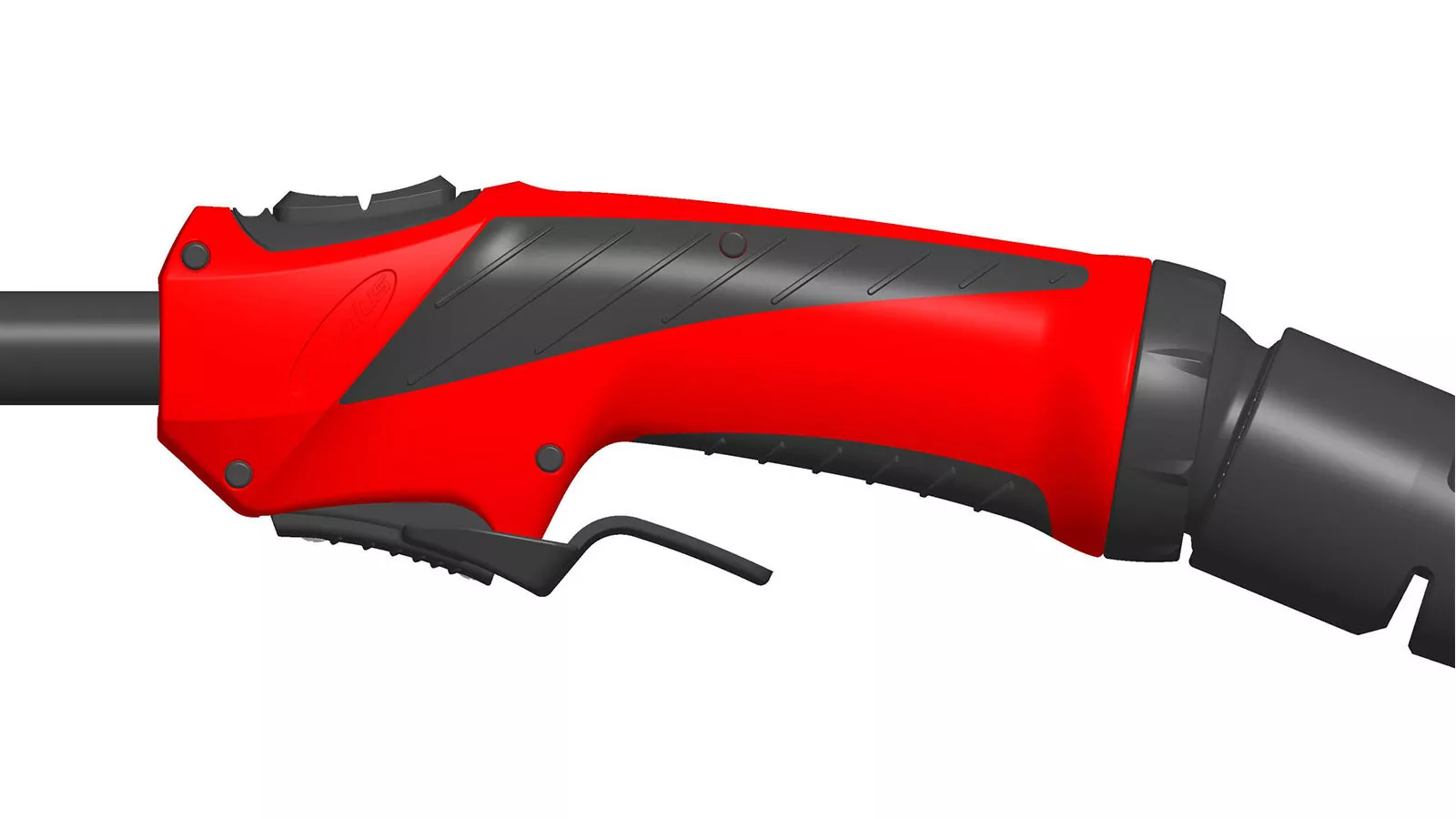

    Fronius welding torches represent the perfect symbiotic relationship between technology and ergonomics. The ergonomic handle with anti-slip components lies comfortably and securely in the hand, allowing the torch to be guided with ease. The ball joint and optimal weight distribution prevent fatigue during welding.
    JobMaster: Everything is under control
    With JobMaster welding torches, the welder can use the remote control with color display integrated in the handle to get a quick overview of important welding parameters such as welding power, wire speed, and previously stored jobs, and can adjust them to the desired value.

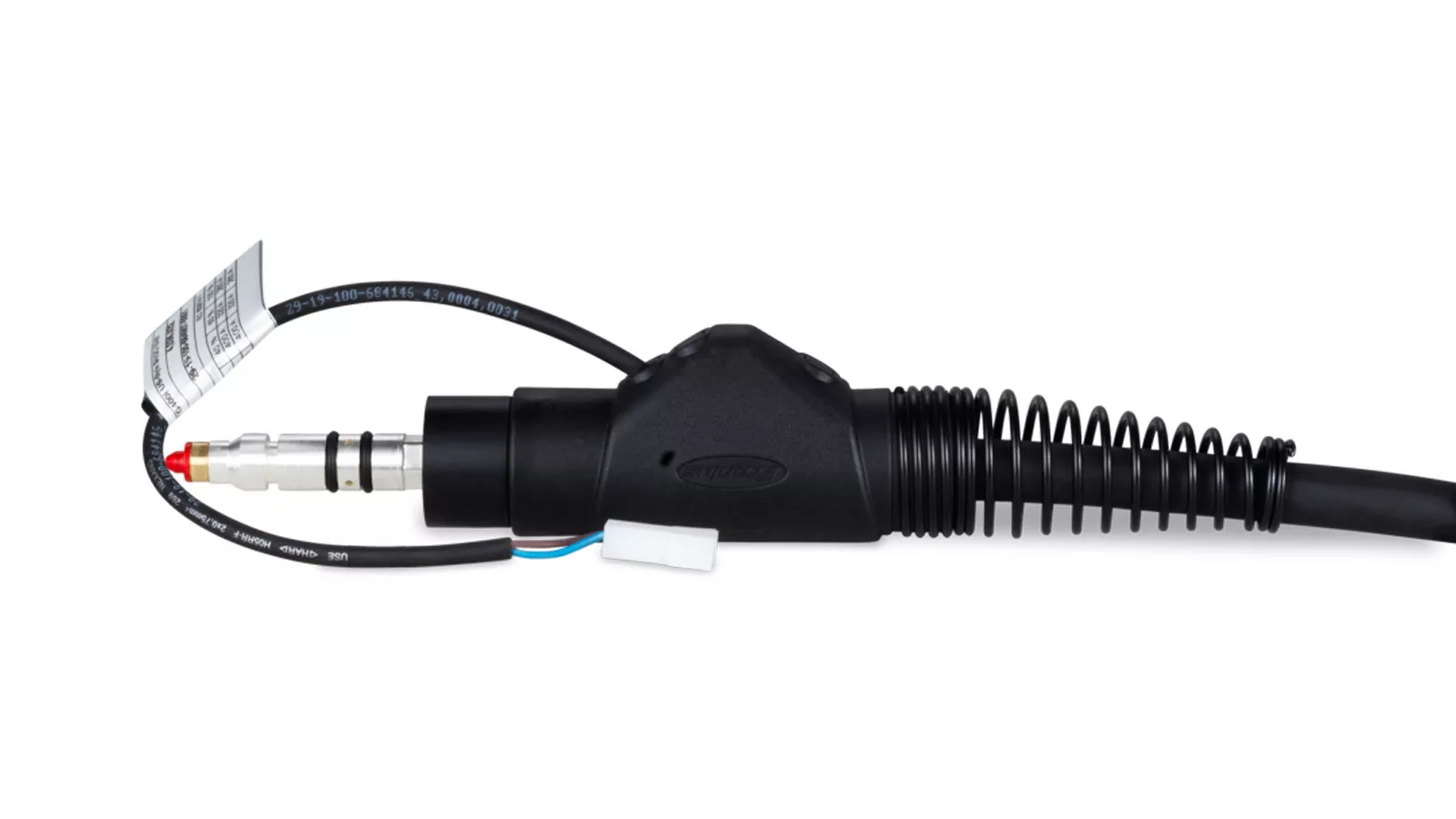

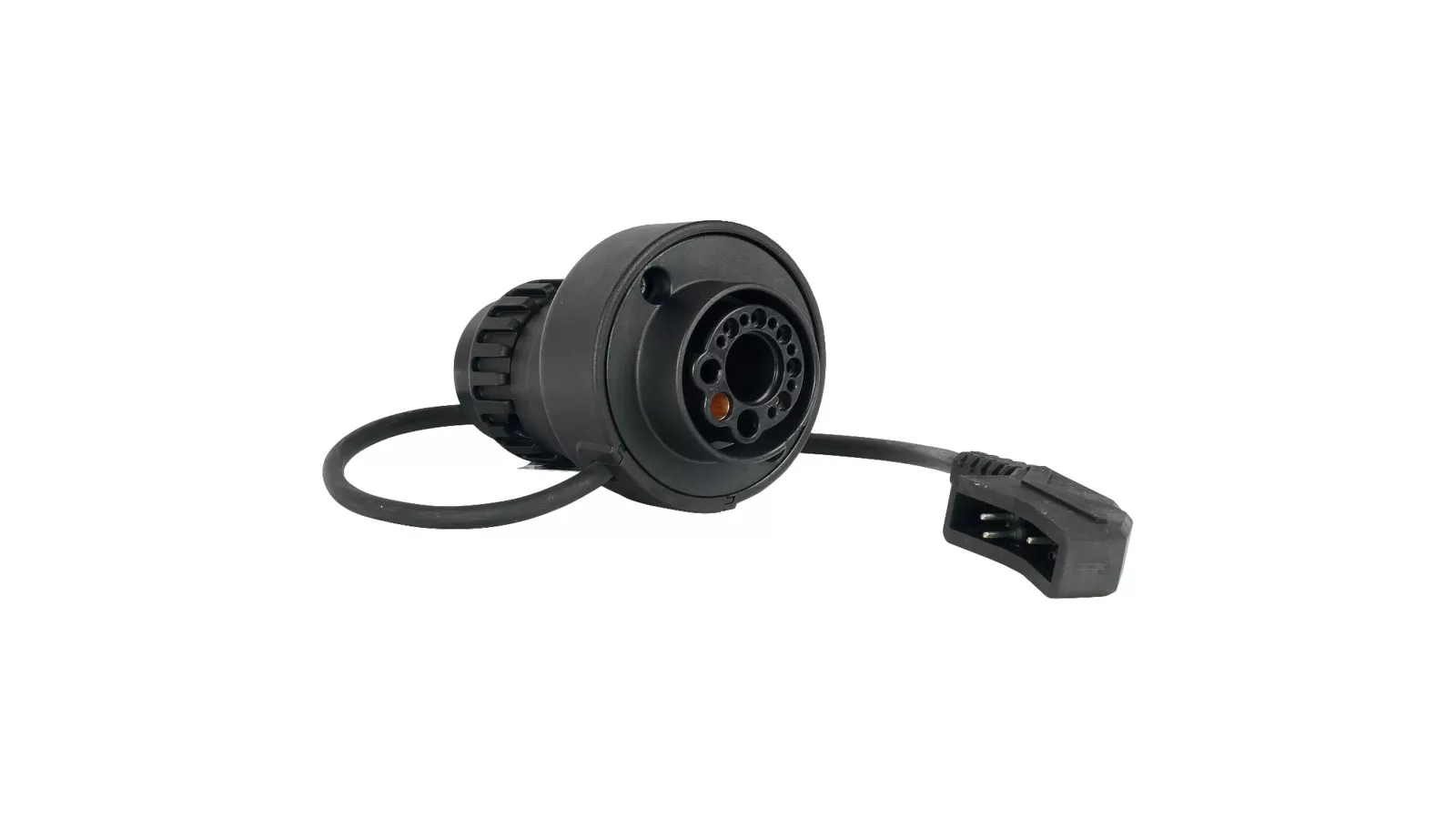

    FSC - One connection for all media
    The Fronius System Connector (FSC) serves as a central connection for all media. This ensures the hose pack to be connected easily and safely to the wire feeder in less than 10 seconds - without tools. For welding equipment from other manufacturers, 4 different central connection variants (suitable for Euro, Lincoln, Miller, Hobart) are offered to guarantee the highest possible compatibility. For this purpose standalone hose packs with corresponding connectors or adapters for existing hose packs are offered. You can get more detailed information from our sales consultants.
