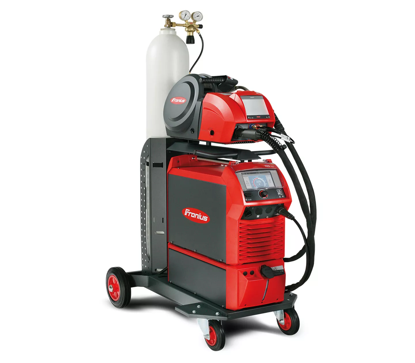

The welding specialists at Knoll use the TPS 320i welding machine in combination with the pulse welding process.  The intelligent MIG/MAG pulse synergic function offers a pulsed arc process with controlled material transfer. In the base current phase, the energy input is reduced to such an extent that the arc only just burns steadily and preheats the surface of the workpiece. In the pulsing current phase, an accurately controlled current pulse ensures targeted droplet detachment. Both phases result in precise, low-spatter welding across the entire power range.
