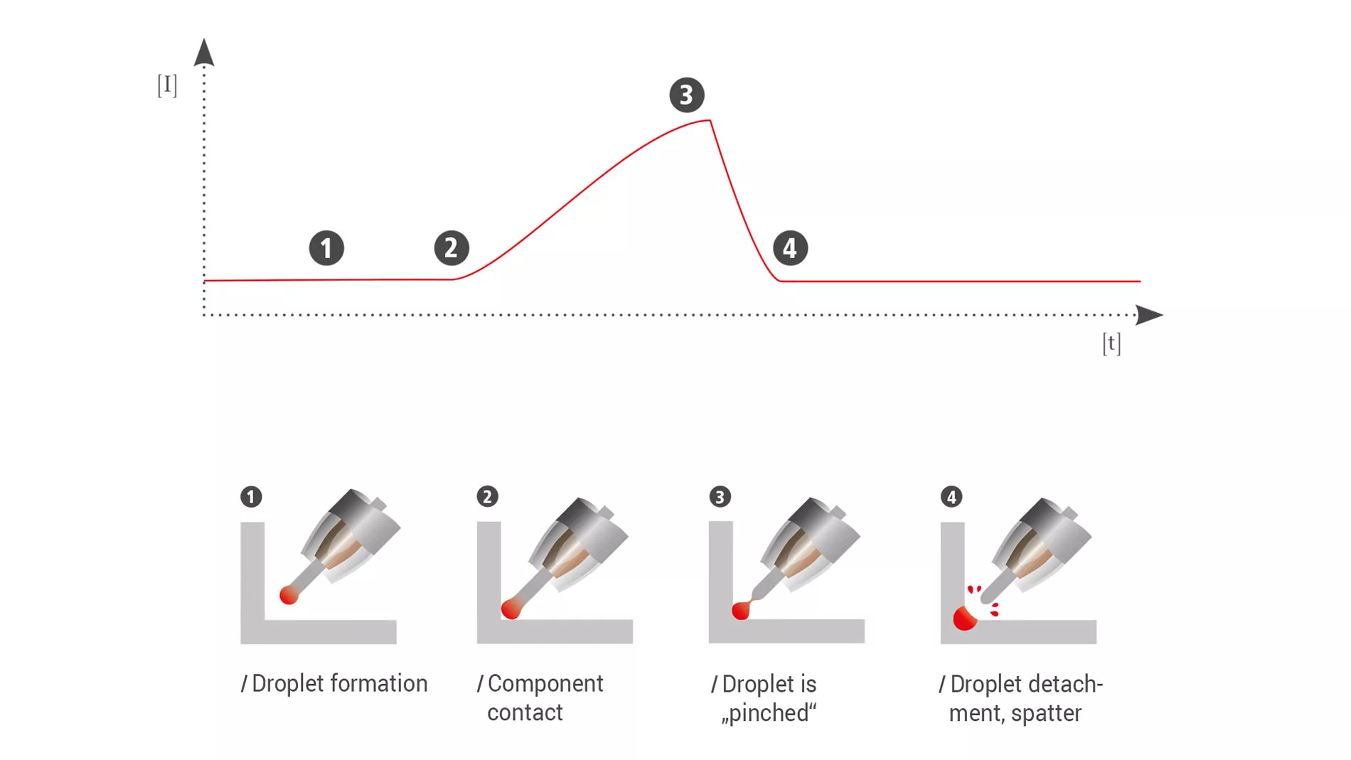

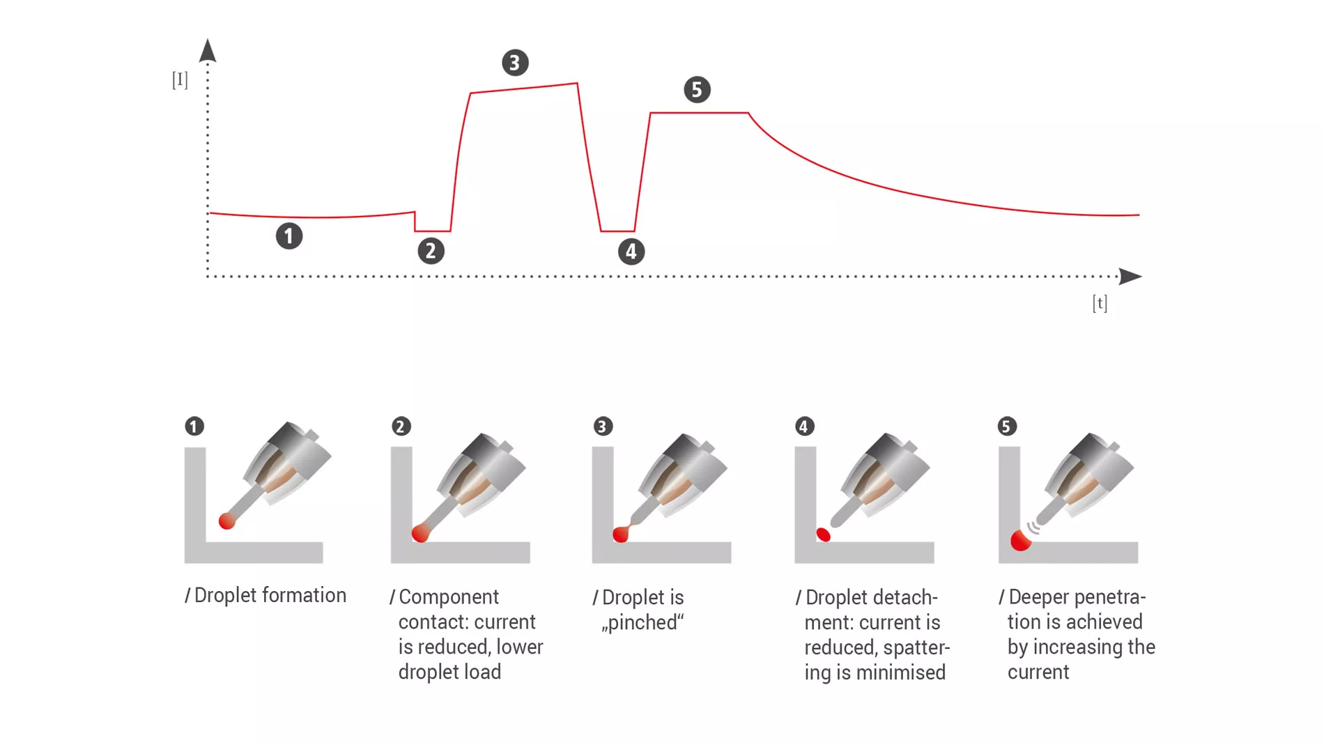

Comparison of standard short circuit transfer and LSC short circuit transfer
The short circuit is triggered at a low current level, resulting in a stable welding process.
Standard short circuit transfer
Excellent results can be achieved with the controlled standard arc. But why settle for the standard when virtually spatter-free welding is possible?
The digital resonant intelligence ensures an absolutely stable arc.
The benefits
  • Up to 75% less spatter
  • Reduction of rework
  • Fewer rejects
