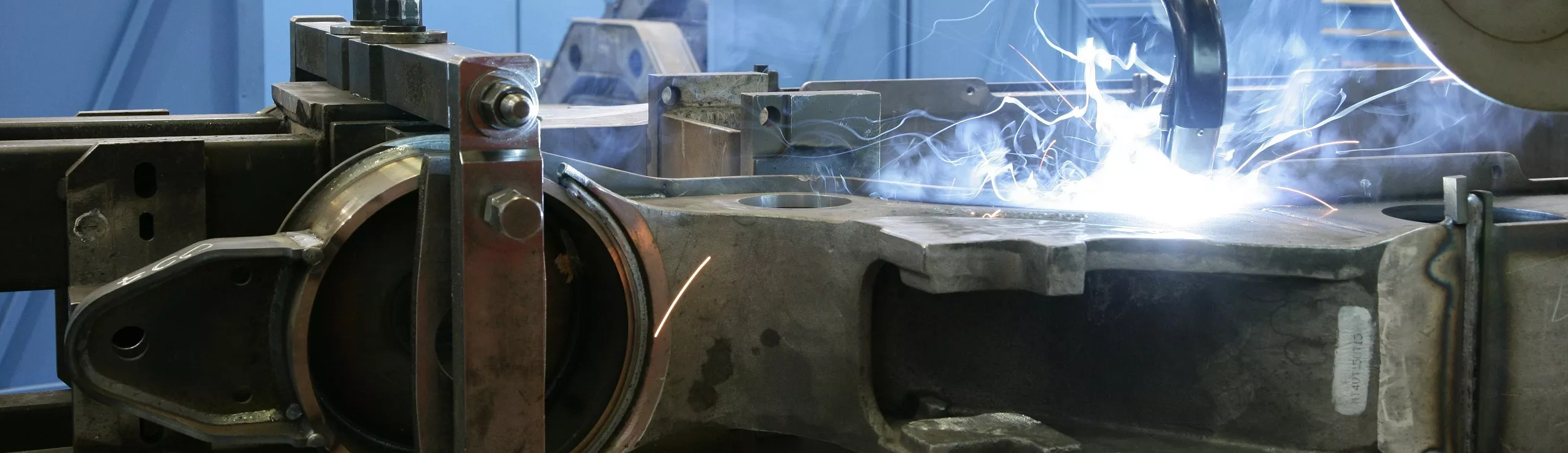

Steel remains the most widespread parent material in metal construction ahead of aluminum and stainless steel.
Its high strength and the low costs make it a popular construction material. Out of all materials, steel is the easiest to weld. The biggest challenge is keeping the material distortion as low as possible. Selecting the correct welding process plays an important part in this.
Interesting facts about steel
Steel is primarily composed of iron and a maximum of 2.06% carbon. Alloys with a higher proportion of carbon are known as cast iron. If the proportion of sulfur and phosphorus accompanying iron is less than 0.025%, it is called stainless steel.
Not every steel can also be welded: only pure steels, i.e. alloys with a carbon content of less than 0.22%, are suitable for this process. As a rule, the more impure the alloy, the harder it is to weld the steel.
Of particular importance are high-strength and super-high-strength steels. In addition to lightweight construction in the automotive industry, for example, they are also used for mobile cranes, concrete pumps, agricultural and forestry machinery. However, they are more difficult to weld than conventional steel alloys. The manufacturer's processing instructions should always be followed without fail.
