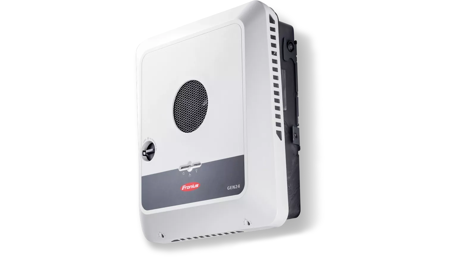

Fronius GEN24:
Backup-Ready For When It Matters
The Fronius GEN24 inverter is designed for homeowners at every stage of their solar journey, whether just getting started or looking to secure lasting energy independence.
Engineered for long-term reliability, this inverter consistently delivers dependable performance along with durable and lightweight design, user-friendly operation, and future-ready technology.

Active Cooling Technology safeguards internal components by preventing excessive heat buildup. Combined with a powerful fan and innovative heat sink, this ensures reliable performance and extended service life of the Fronius
GEN24.

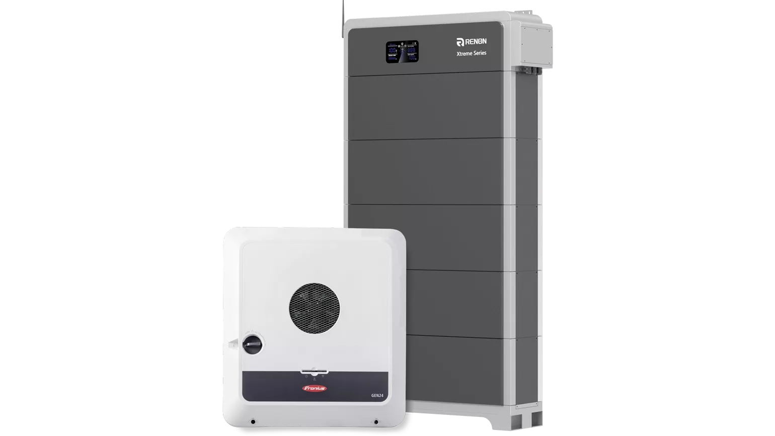

High-Voltage, High-Efficiency Battery Storage
When paired with the Renon Xtreme HV 1.0, the Fronius GEN24 Plus becomes a complete, high-performance energy storage system. Built for easy installation, engineered to protect homeowners from rising utility costs, this high-voltage solution takes the energy you generate and puts it to work!

High Efficiency & Modularity
A 192–384V nominal range cuts transmission losses and reduces conductor size. The stackable, modular design supports 2–4 modules for 9.6, 14.4, or 19.2 kWh and is easy to configure and expand.
Smart Management
Wi-Fi connectivity and intelligent EMS enable simple setup, unified control, and real-time monitoring.
Safety & Durability
Up to 8,000 battery cycles, IP55 protection, a built-in battery optimizer, and global certifications deliver dependable, long-lasting performance.
