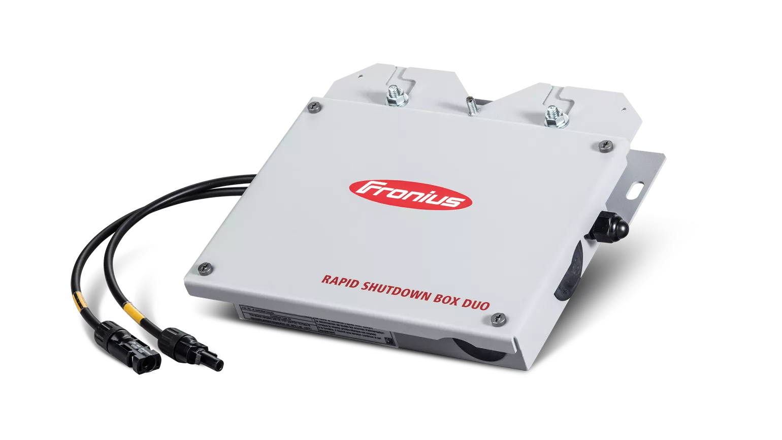

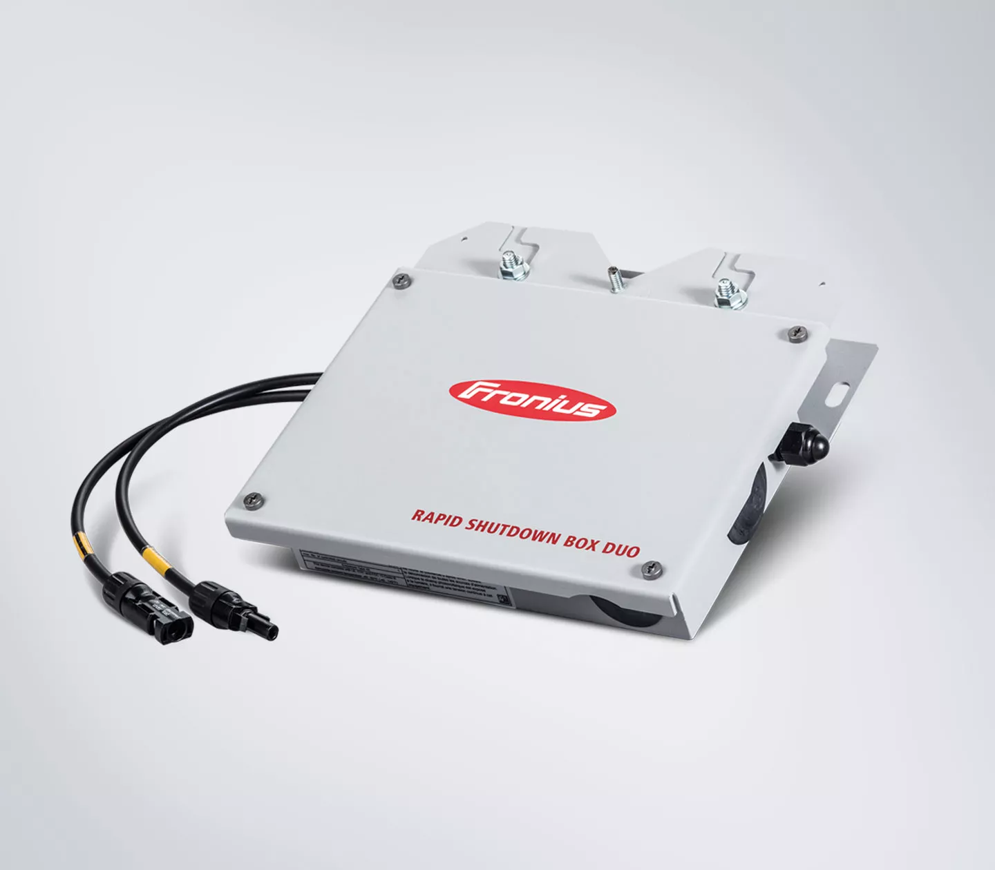

The Fronius Rapid Shutdown Box Duo and Quattro generation has been specially developed for the demands of the North American market and is a reliable, easy-to-install solution for quickly disconnecting the PV array from the inverter. Compliant with NEC 2014 (690.12), the Rapid Shutdown Box is suitable for all North American SnapINverters up to a maximum system voltage of 600V (except Symo 15.0-3 208). As the Box is connected to the inverter via a signal wire and can be mounted conveniently under the module, it needs neither additional components nor a dedicated power supply. The Fronius Rapid Shutdown Box Duo and Quattro are a low cost and simple to install Rapid Shutdown solution for Fronius SnapINverters.
