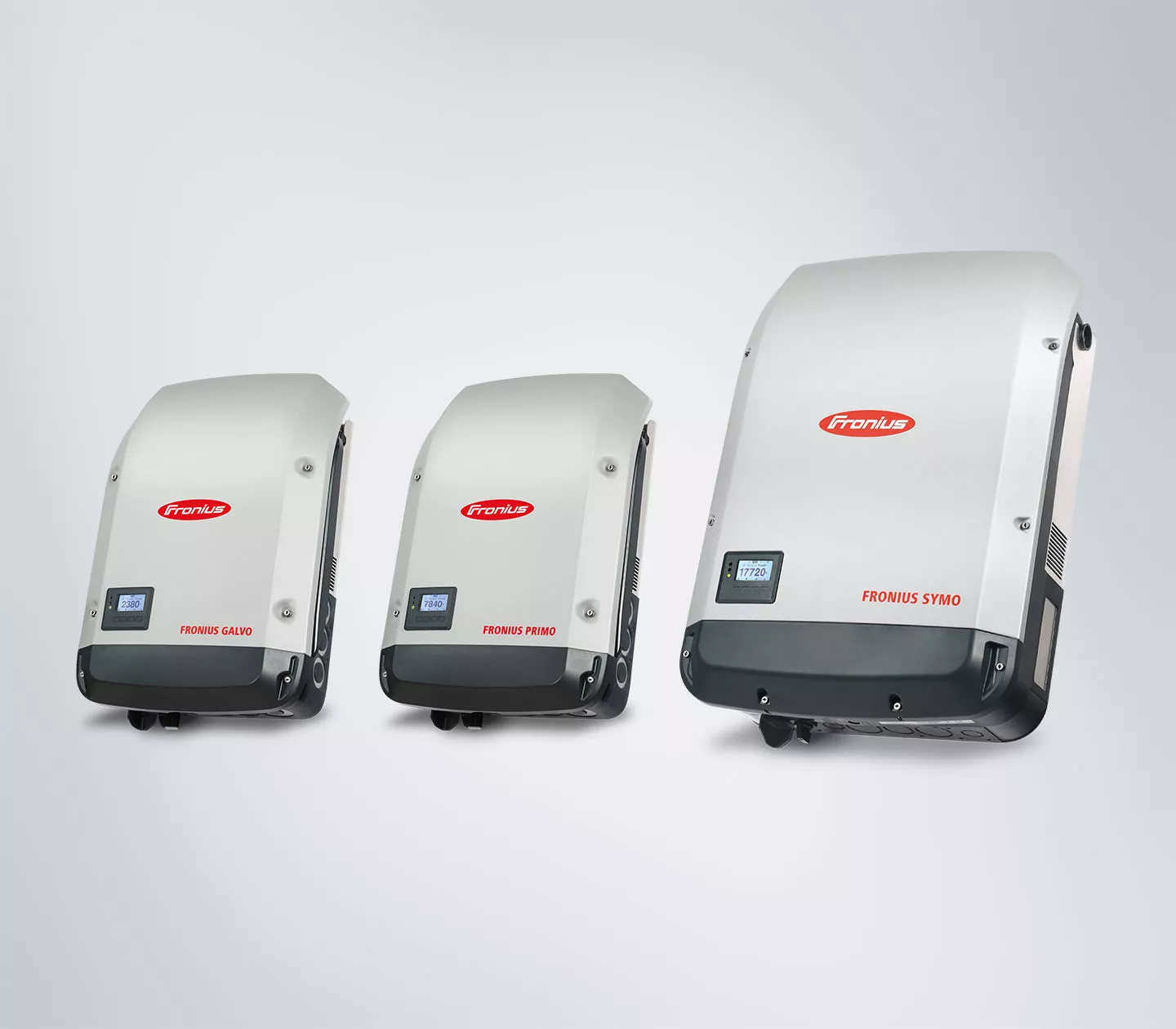

Fronius Symo Advanced
SPECIALLY DEVELOPED FOR THE REQUIREMENTS OF TOMORROW
The Fronius Symo Advanced is the ideal compact three-phase inverter for commercial and industrial applications. This inverter combines the benefits of a modern string inverter, such as the Dynamic Peak Manager for shade mitigation and an integrated Power Line Communications (PLC) transmitter for SunSpec Rapid Shutdown, with light weight, field serviceability, and zero-tilt mount.
