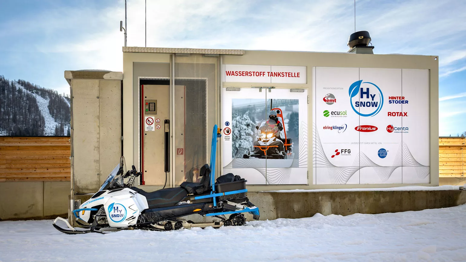

flagship ‘HySnow’ project has been live for around a year. Since February, the
Rotax ‘Lynx HySnow’ snowmobile has also been undergoing testing in real-life
conditions in the Hinterstoder-Wurzeralm winter sports area in Upper Austria.
The snowmobile is supplied with green fuel by a Fronius-developed hydrogen
refuelling system. This represents a significant step towards the urgently
needed decarbonisation of winter tourism.

Fifty kilograms of hydrogen already produced
The H2 refuelling system consists of a 34.5-kWp PV system with two Fronius Symo inverters and two electrolysis modules with a downstream compressor. This provides a 350-bar tank infrastructure. The electrolysis modules have already produced 50 kg of hydrogen over the course of 300 operating hours. The Lynx HySnow has already been refuelled 30 times and is in use on the route between Hutterer Böden (1400 m) and Schafkogel (2000 m). The snowmobile emits only water vapour and moves in almost complete silence. The fuel cell system has now been in operation for 350 hours.
High CO2 savings potential
The key advantage of this sustainable hydrogen system is the generation of green hydrogen from solar energy using electrolysis. The rapid vehicle filling time of less than three minutes and the easy storage of large quantities of energy are further key advantages of the system. This guarantees a six-week hydrogen supply, even if the photovoltaic system is covered in snow.
Real-world implementation will take place over two winter seasons, with a saving of four tonnes of CO2 output achieved in comparison to vehicles with combustion engines. The system was designed and constructed by partners of the HySnow project consortium. Financial support for the flagship project is provided by the Austrian Federal Climate and Energy Fund.
