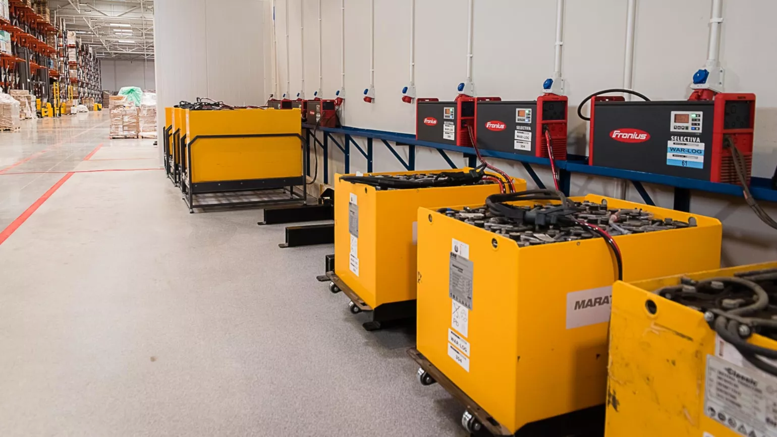

During long periods of idle time, lead-acid batteries should be stored in a charged state – otherwise there is a risk of damage, which can drastically reduce the battery life.
Professional battery maintenance is the best way to ensure that the forklift truck fleet is ready for use again after extended downtimes.
Fronius battery chargers have a dedicated conservation charge feature, which continuously supplies the battery with power to prevent discharging.
