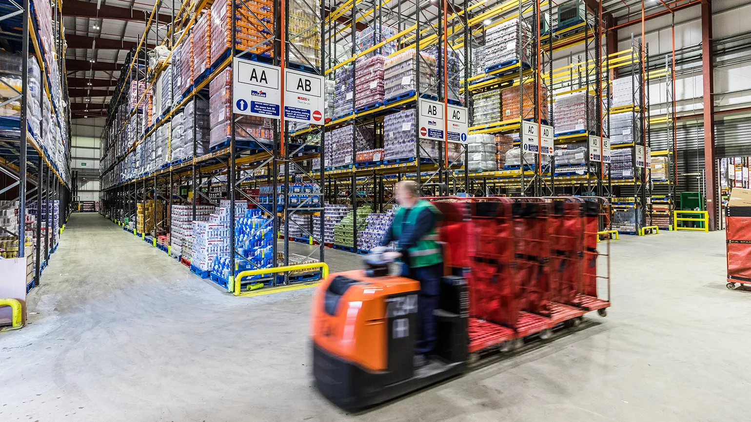

A busy operation, delivering between 300,000 and 400,000 cases per week across different temperature regimes requires a logistics operation of 3 shifts per day over 24 hours, 6 days a week and their volume of cases shipped per week fluctuates depending on the season. This makes the need for their fleet of 40 reach trucks, counter balance, assembly trucks, loading trucks and powered pallet trucks from Toyota and BT to be readily available at all times vital to the smooth operation of their logistics process. Some of the MHE also used secondary batteries to keep the vehicle running during the shift operations.

CJ Lang and Son Ltd operates from an 180,000 sq. ft. multi-temperature distribution centre in Dundee.

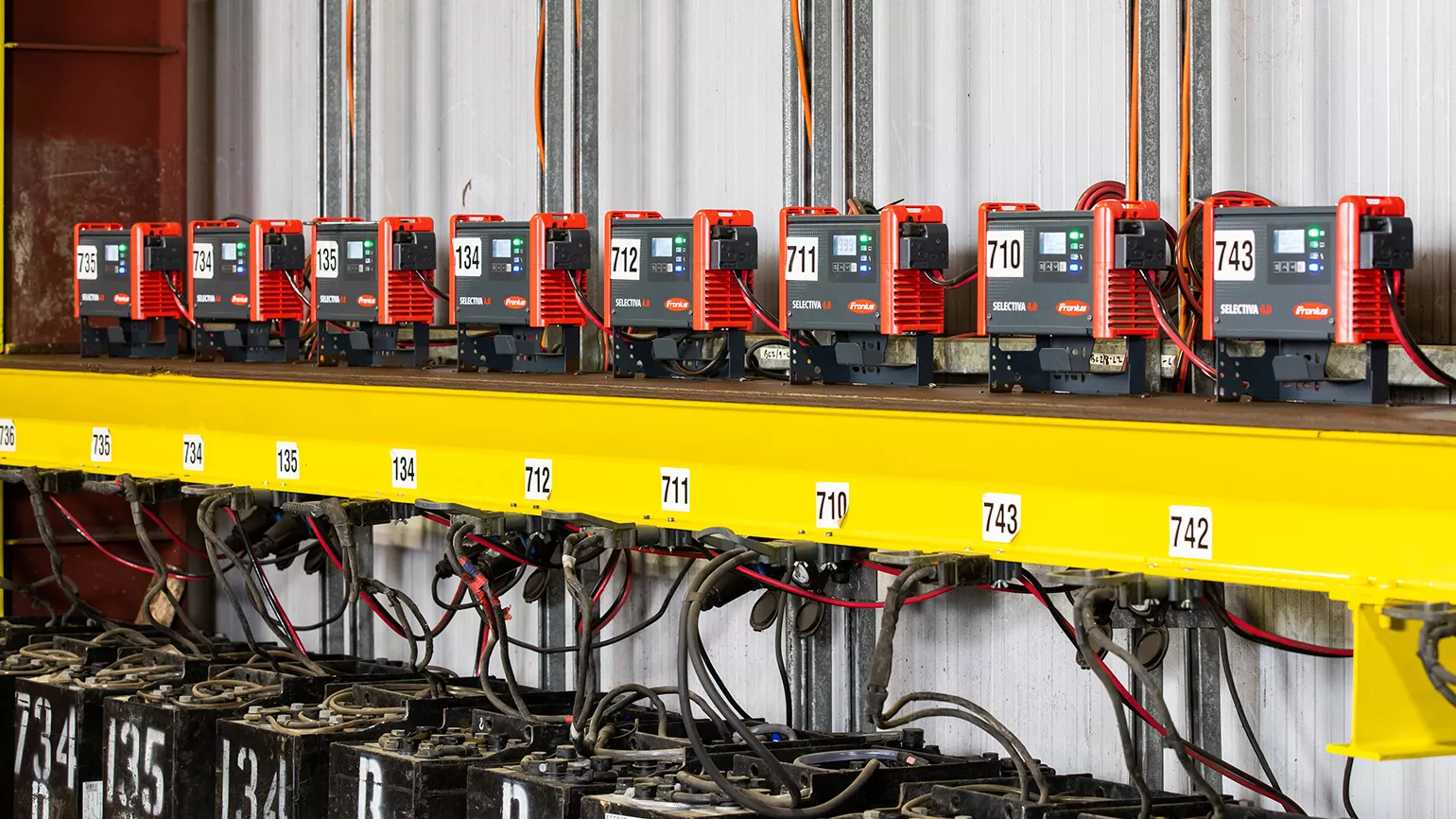

Working with the UK and Austrian teams at Fronius, the unique and innovative Selectiva 4.0 battery chargers were installed as a trial at the Dundee distribution centre. The intelligent Ri charging process of the Selectiva 4.0 battery chargers adapts individually to the condition of each battery, its state of charge and age of the batteries. This ensures a cooler, gentler and more energy efficient charge therefore making the batteries last longer so they do not need to be replaced as often. In order to cope with the different temperature zones at CJ Lang and Son Ltd the “temperature-controlled charging” option was installed. With this option the charging voltage is adapted according to the temperature of the battery, thereby providing sustainable protection and increasing the battery‘s service life. To show how efficient the system is, Fronius has calculated the long-term potential savings, such as cost savings and electricity costs, which can be achieved with the new technology. CO2 savings and reductions in other areas relating to sustainability can also be demonstrated.

The intelligent Ri charging process of the Selectiva 4.0 battery chargers adapt the charging process to take into account the temperature in the battery, its state of charge and age of the batteries.

  • A range of forklift trucks with batteries from different manufacturers and with various power categories – the Ri charging process determines the condition of each battery based on the effective inner resistance (Ri) and adapts the charging characteristic accordingly.
  • Multiple temperature zones – thanks to the “temperature-controlled charging” option, the Selectiva chargers adapt the final charging voltage to the temperature inside the battery, improving performance and extending service life.
