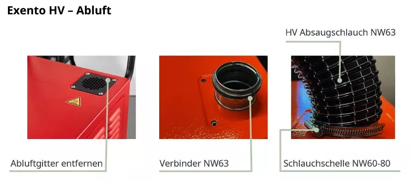

Exento product family
How to operate your Exento welding fume extraction unit correctly.
Yes, there is a solution. Please contact our Customer Service.
Choose the 3-phase configuration of the Exento HighVac for such exhaust air solutions. This ensures sufficient reserve capacity when the filter gradually becomes saturated. For further information, please contact your Fronius consultant at the Technical Competence Center (TCC). We will be glad to help you with the setup.

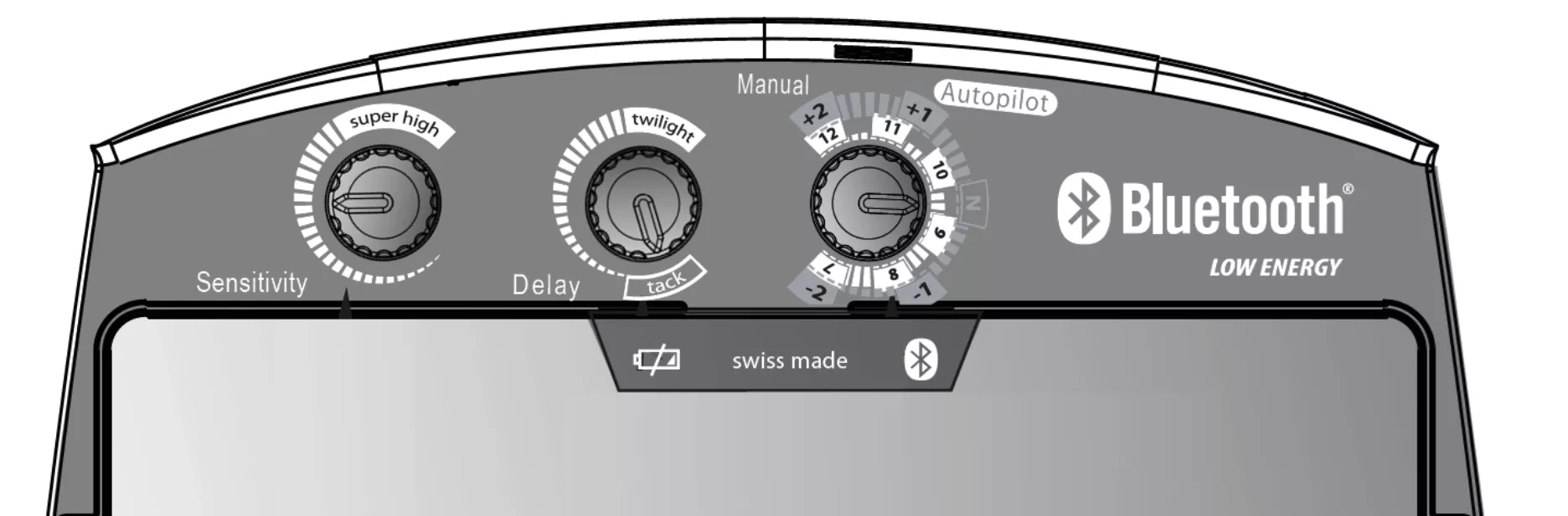

Protective equipment

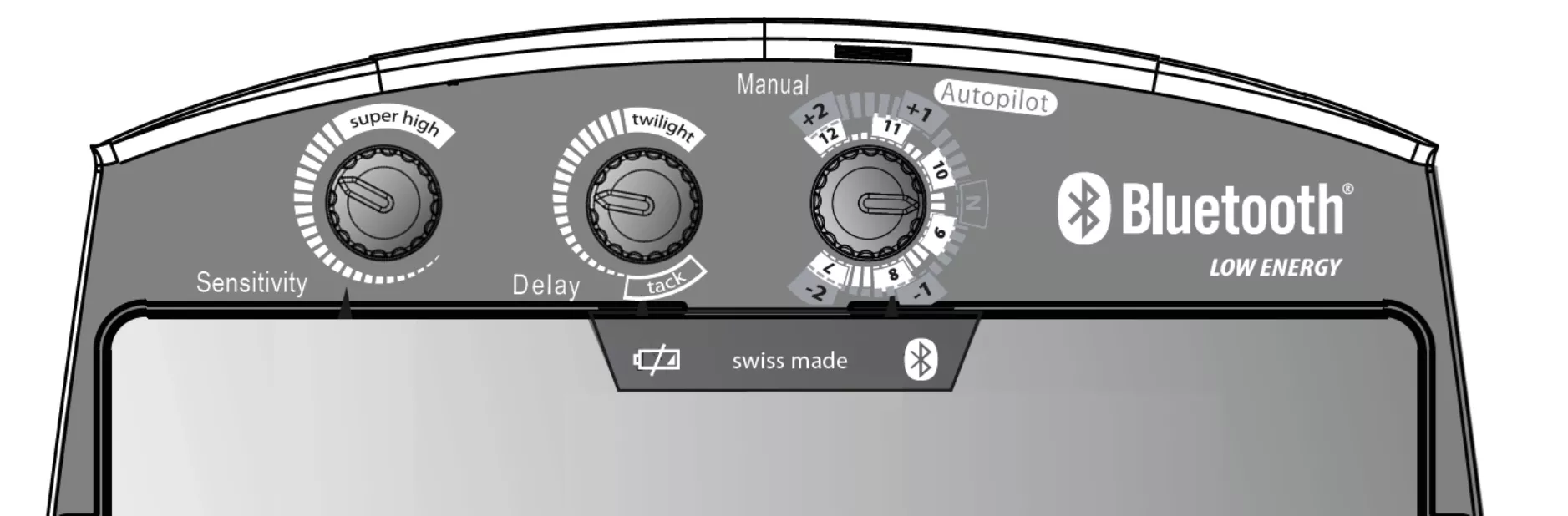

There is no need to worry. Your eyes are protected by the permanent UV and infrared filter.
Our recommendation for the default setting:
Set the control to “Autopilot”
If the helmet does not darken sufficiently, increase the degree of darkening with the “Sensitivity” control. The setting goes up to “super high”.

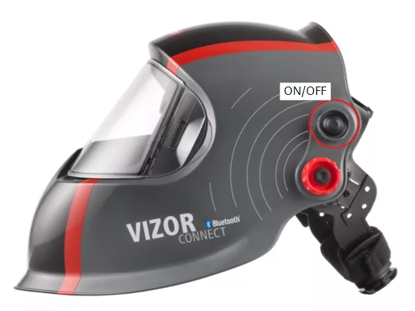

Do you have a Vizor Connect? First charge the helmet via the USB-C connector. If you have a different Fronius helmet, please insert new batteries (CR XXXX).
Note: When changing batteries, remove the plastic film from the battery.

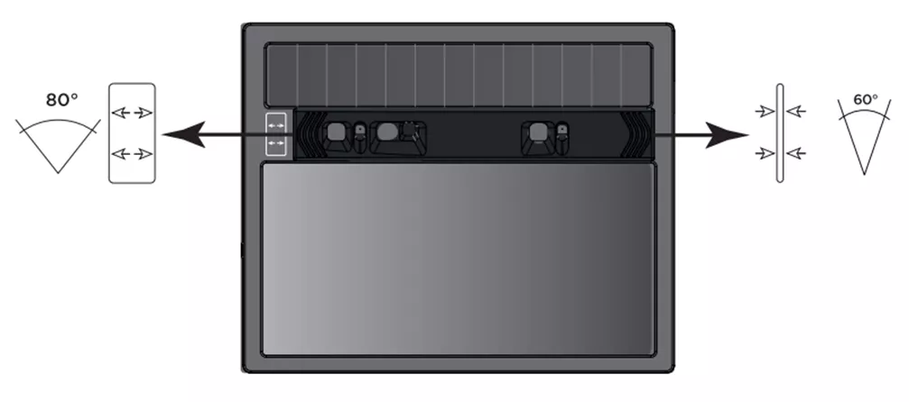

The sensor slider can be set to two different positions. The angle for detecting ambient light is reduced or increased depending on the position.
If you have any further questions or if the error persists, please contact one of our teams or a Fronius Service Partner near you. Find your Fronius Service Partner here.
The grind mode button serves as an on/off switch for the connect mode.
In the off position, the welding helmet works conventionally (no LED indicator).
In the on position, the welding helmet reacts by wireless control via the welding machine (after successful pairing, the blue LED indicator lights up continuously).
Pairing is possible with the following systems:
- TPS 320i C / TPS 320i / TPS 400i / TPS 500i / TPS 600i from serial number 29200502 and 4,067,101 NFC/BLE/WIFI24 Inside (firmware version 2.0.1)
- MW 230i / TT 230i from start of series (firmware version 1.5.0)
- iWave series

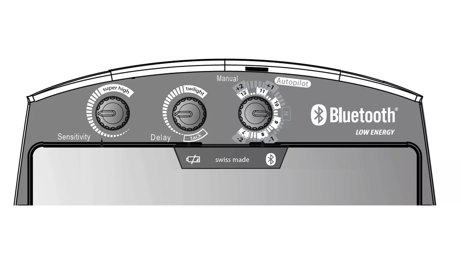

Slider to Autopilot
Recommendation for TIG DC low ampere welding
Recommendation for pulse welding
Recommendation for tack welding
Recommended for welding outdoors or in strong ambient light
If the darkness level is already at maximum due to your welding application, additional shades are available that can be attached to the inside of the auto-darkening filter cartridge. The additional shades increase the darkness by one or two darkness levels, depending on the desired strength. Additional shades are available through our extensive sales network with outlets in your area.
