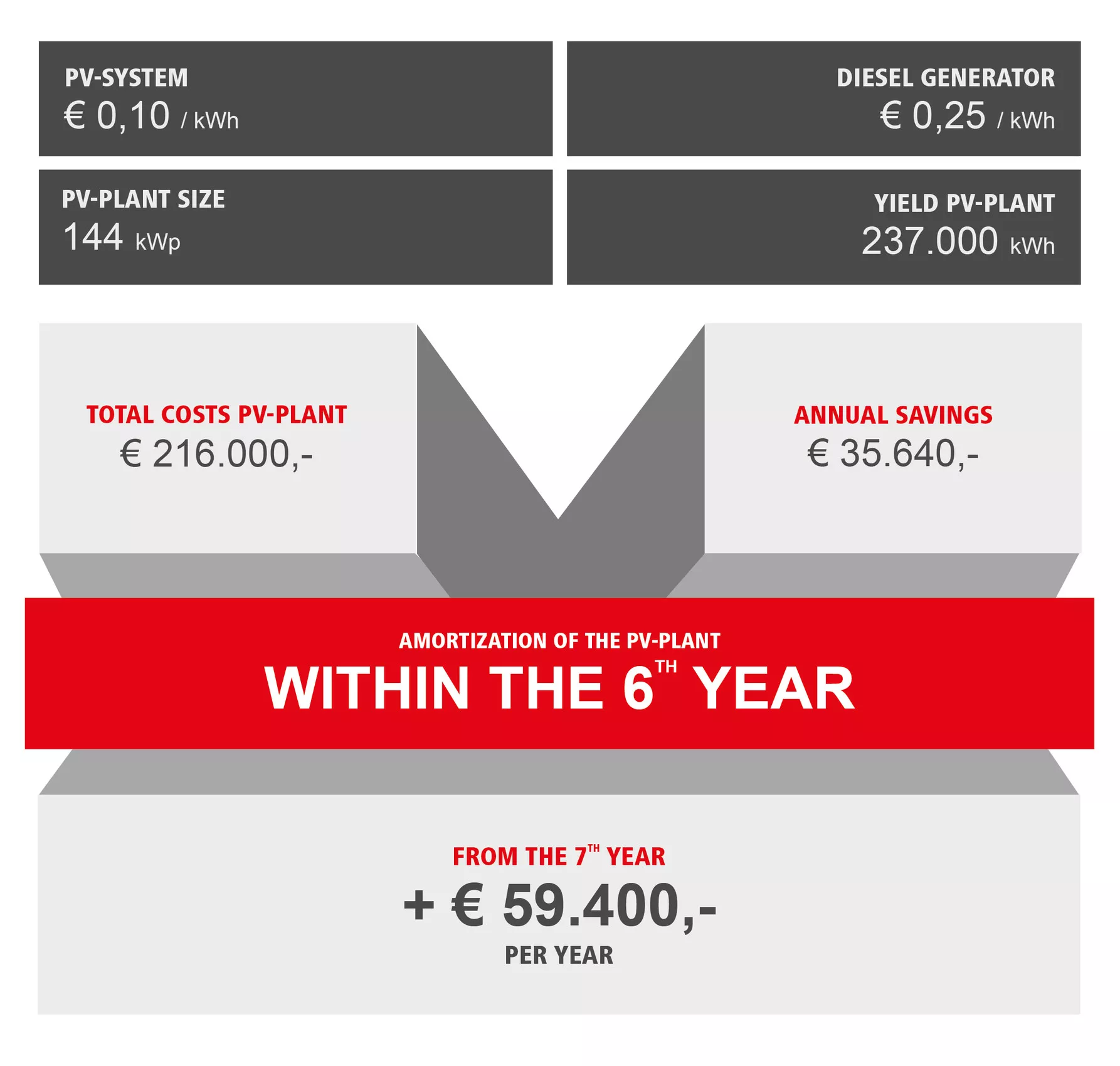

A PV system that will pay for itself within six years
Upgrading diesel-powered systems to the Fronius PV-Genset solution really pays off. Thanks to the PV system, operator Francois Farage of Green Essence Lebanon saves 35,640 euros a year. “The system in Lebanon will pay for itself within the sixth year. After that time savings will exceed 59,000 euros per year,” says David Hanek.
The 144 kWp photovoltaic system in northern Lebanon with six Fronius Symo inverters supports a 280 kVA generator and achieves a 40% degree of self-sufficiency. The system generates 216,000 kWh a year, saving approximately 115 tonnes of CO2.
