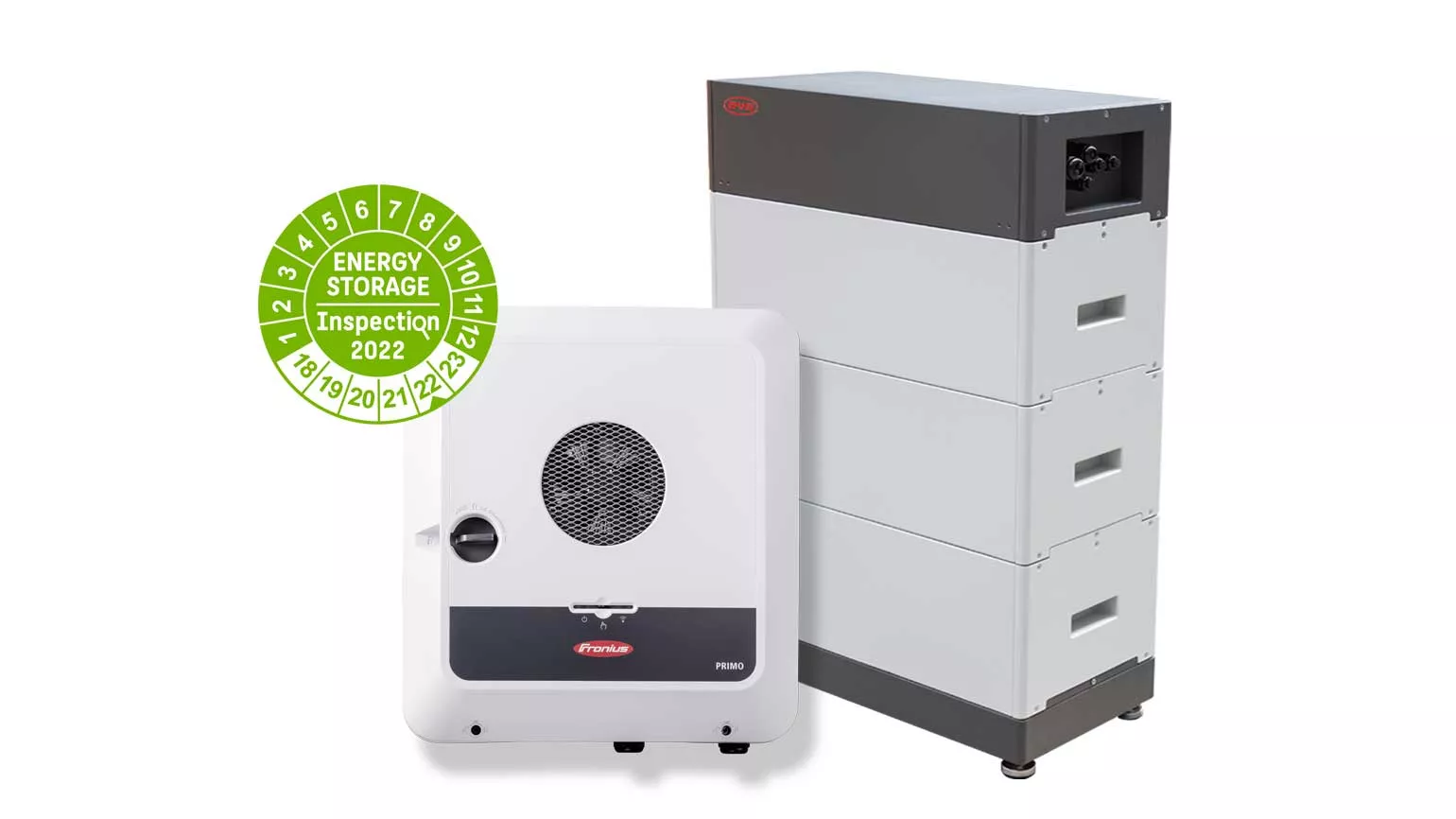

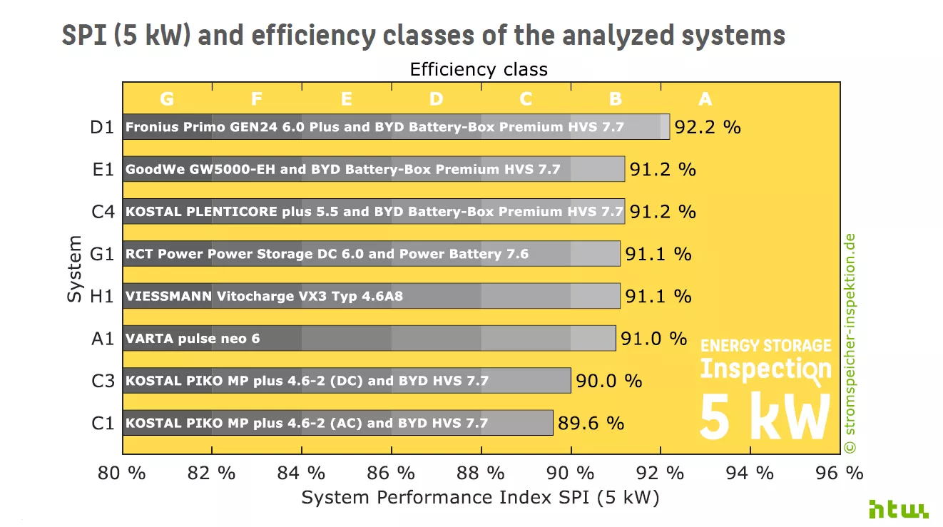

With an unbeatable System Performance Index of 92.2%, the new Primo GEN24 6.0 Plus, together with the BYD Battery-Box Premium HVS 7.7 secured first place in the 5kWp category.
At the same time, the Symo GEN24 10.0 Plus with the BYD Battery-Box Premium HVS 10.2 was able to improve on its showing from last year with a system performance index of 94.7% (2nd place).
With the GEN24 Plus series and the BYD Battery-Box Premium, Fronius is also the only manufacturer to offer a complete system in the highest efficiency class A in both reference cases.

Two different reference cases were used for the evaluation. The first analyzed the SPI (System Performance Index) of a 5 kWp PV system with an annual household consumption of 5,010 kWh/a, while the second reference case combined a 10 kWp PV system with a heat pump (2,664 kWh/a), an electric car (1,690 kWh/a), and an annual household consumption of 5,010 kWh/a.

SL: With the GEN24 Plus series, we were the only manufacturer to achieve energy efficiency class "A" in both reference cases. With scores of 94.7% and 92.2%, the 3-phase Symo GEN24 Plus and the 1-phase Primo GEN24 Plus were able to achieve very high scores.
JW: The greatest influence on the SPI is the conversion efficiency in the different energy paths, and here, the Fronius inverters, together with BYD, achieve by far the best values. On the one hand, this is due to the use of high-quality power semiconductors in our inverters, but on the other hand, of course, it is also due to the perfect interaction with the battery.
