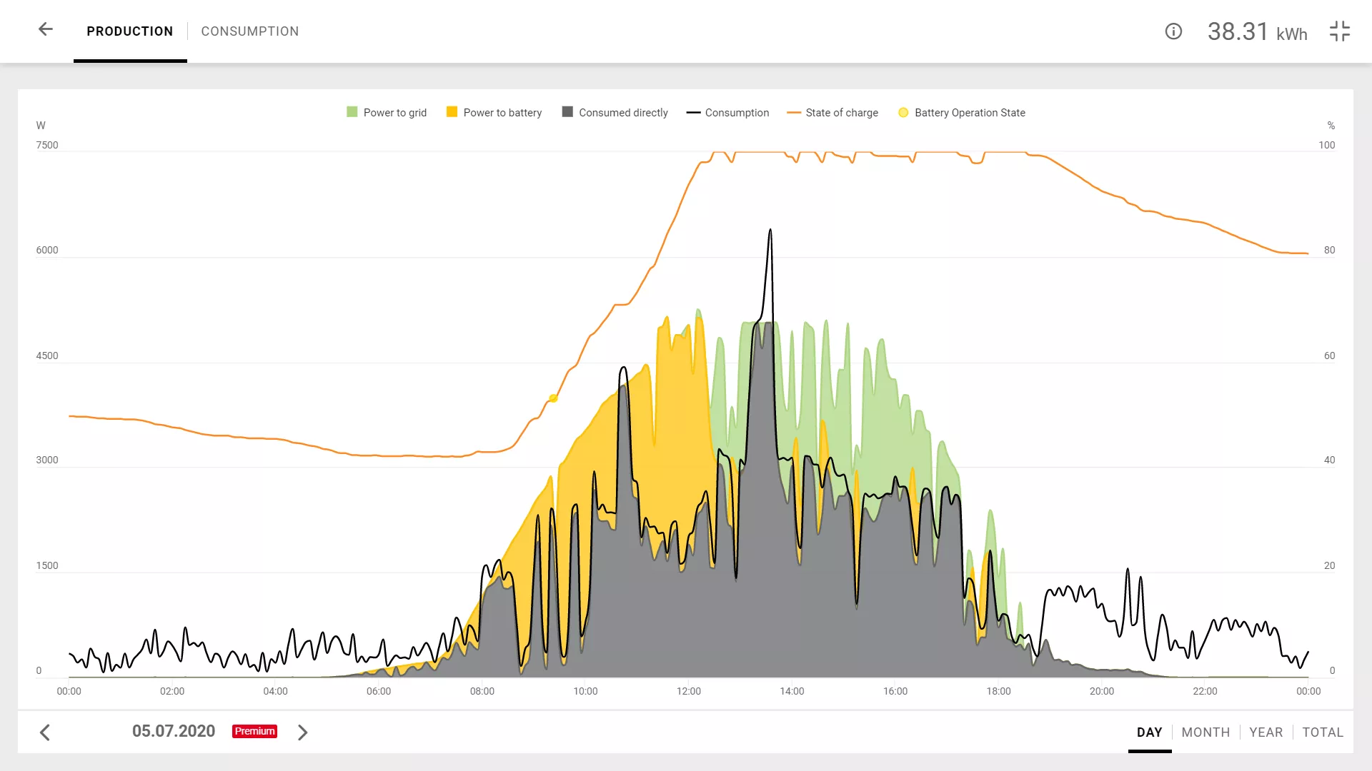

Battery status data available on Solar.web
If the PV system is registered with Fronius Solar.web, the battery state of charge will be clearly displayed on the platform, along with information such as power, battery status and load.

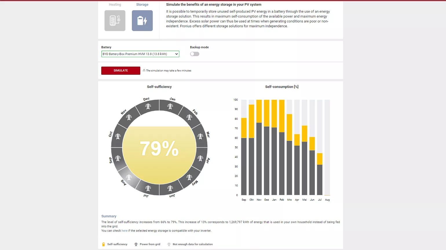

Battery storage simulation on Fronius Solar.web
Fronius Solar.web also provides a simulation option to test how adding a BYD Battery-Box Premium HVM will impact on an existing PV system.
With just one click, the simulation shows how changing the battery would alter the self-consumption levels for all PV systems (provided they have been registered on the platform for a month or more).
