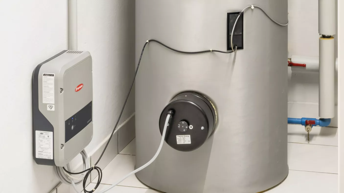

No doing things by halves – generating hot water using PV energy
“When we bought the house it was important to us to preserve its charms while at the same time benefiting from the latest developments in energy generation. For us, this meant turning off the existing oil heating system as far as possible. We are now using PV electricity to heat our water instead,” says Stefanie Ringer.
The principle is quite simple: surplus PV energy, which is not required in the household, is used to generate hot water. All of this takes place via the Fronius Ohmpilot. The intelligent consumption regulator can also be easily integrated into an existing PV system.
