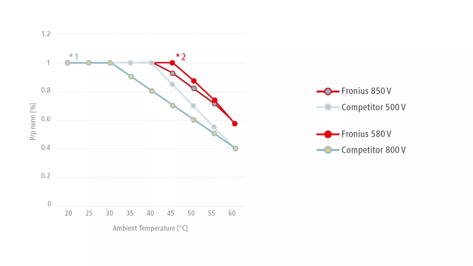

To prevent electronic components from overheating, an inverter is always power derated, i.e. the output power is reduced. Inverters with active cooling technology have a clear advantage here, especially in the higher temperature ranges.
Since the inverters are significantly cooler inside, they only start to reduce their output power at higher ambient temperatures. This has a positive effect on the yield. The inverters deliver higher yields, thereby reducing the payback period of the investment.
*1 passive cooling
*2 active cooling

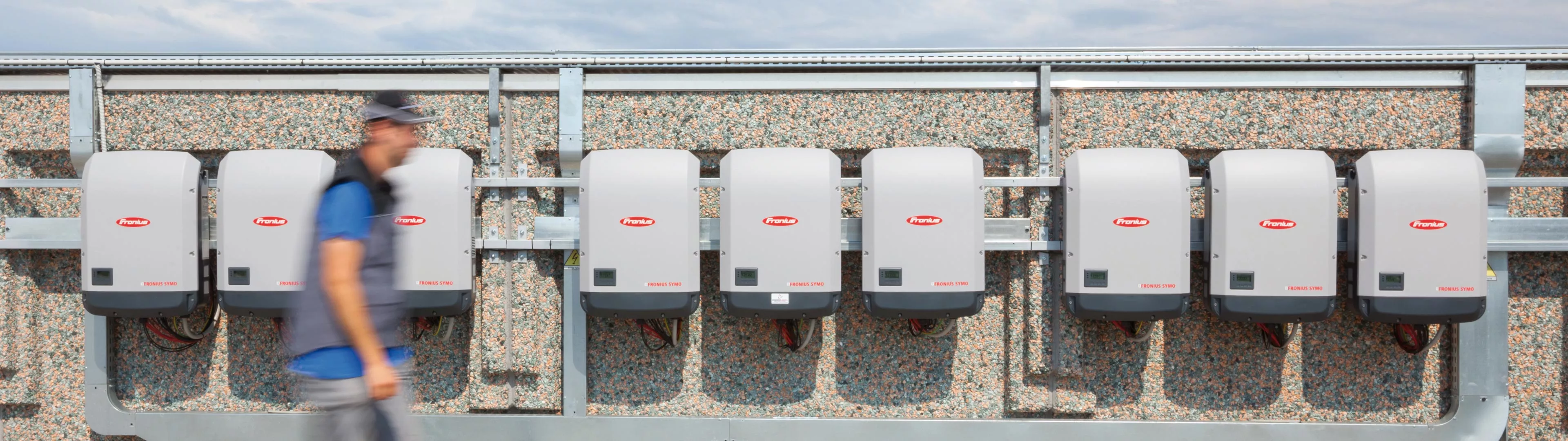

Thanks to active cooling, the inverters are also extremely flexible with regard to installation. Fronius inverters can be mounted vertically, horizontally and even flat on the roof. The intelligent active airflow also makes it possible to mount the inverters side by side.
With the GEN24 Plus, cool air is drawn in centrally and warm air is discharged via the cooling fins. Moreover, since no heat sinks are required, the inverters are very easy to transport and install due to their low weight.
