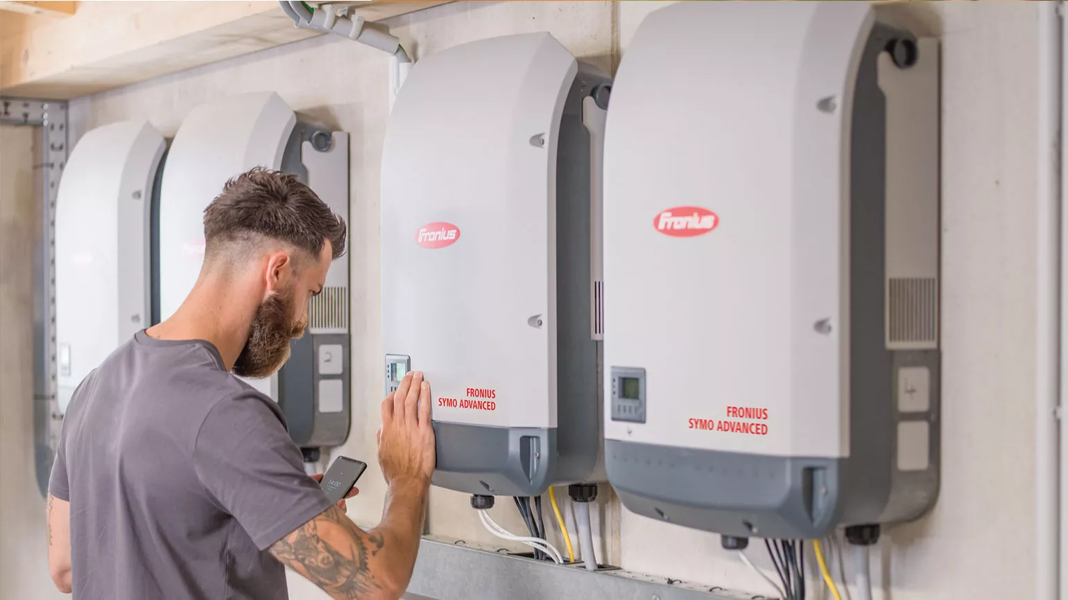

The advantages of the SnapINverters have been proven in numerous photovoltaic systems around the world. When it comes to installation and servicing, the inverters are innovative, straightforward and safe. The inverters offer extremely flexible usage while also having all the integrated functions for distributing the self-generated energy in the household in the best possible way and achieving maximum rates of self-consumption.
Easy installation & service
The SnapINverter technology makes for highly safe and easy installation of the inverters.
Thanks to the proven PC board replacement process, Fronius System Partners can solve any service issues with just one visit. This means minimum time and cost for you and maximum yield dependability for the system owners.
  • Standard mounting system
  • Quick and secure installation & servicing
  • Serviceable on site
