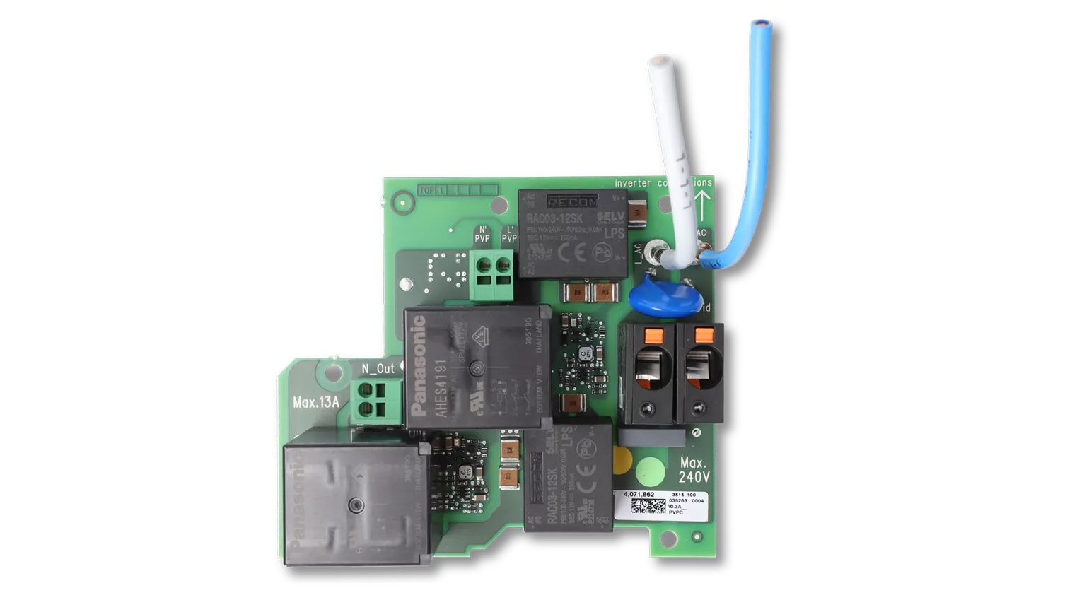

The PV Point Comfort ensures protected sockets or small circuits have a permanent power supply, not only during a power failure, but also in parallel grid operation.
Unlike the PV Point, the PV Point Comfort automatically switches to backup power mode when required, thereby ensuring a continuous mains supply for important loads such as refrigerators, freezers or alarm systems. As an accessory, it can also be easily retrofitted into all Fronius GEN24 and GEN24 Plus inverters.
technicalData
General Data
| Dimension / width | 119 mm |
| Dimension / height | 45 mm |
| Dimension / depth | 103 mm |
| Weight | 0,32 kg |
| Weight incl. packaging | 0,41 kg |
Technical Data
| Electrical fuse | Circuit breaker 13 A1) type C & 30 mA residual current circuit breaker type A |
| Maximum amperage Primo GEN24 [Plus] (continuous operation) | 13 A |
| Maximum amperage Symo GEN24 [Plus] (continuous operation) | 13 A |
| Max. power in backup power mode Primo GEN24 [Plus] (continuous operation) | 3000 W |
| Maximum amperage Primo GEN24 [Plus] (overload - 5 seconds) | 20 A |
| Max. power in backup power mode Symo GEN24 [Plus] (continuous operation) | 3000 W |
| Maximum amperage Symo GEN24 [Plus] (overload - 5 seconds) | 18 A |
| Max. power in backup power mode Symo GEN24 [Plus] (overload - 5 seconds) | 4100 W |
| Max. power in backup power mode Primo GEN24 [Plus] (overload - 5 seconds) | 4700 W |
| Grid connection | NPE |
1) If necessary, a circuit breaker with a maximum of 16 A can also be used as a means of fuse protection. However, a maximum of 13 A can be supplied in backup power mode.
