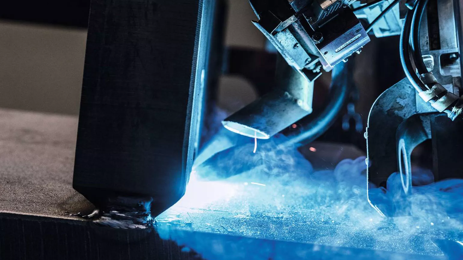

A deciding factor behind this decision was that Fronius had already been involved with TRUMPF's production operations for many years with its MAG welding processes. With its extensive expertise in welding technology, Fronius started by checking that its LaserHybrid method was suitable for thick sheet metals, and then continued by adapting the equipment technology to the specific requirements of TRUMPF's plant. Fronius had in the past already implemented similar systems in shipbuilding for welding reinforcement profiles, and in the automotive industry. The key benefit to the LaserHybrid process is that it is actually a combination of two processes that complement one another perfectly: whilst the MIG/MAG process ensures good gap-bridging ability with relatively simple seam preparation and reduces the proneness to hot cracking, the laser guarantees a reliable and concentrated heat input together with deep penetration.

In order to eliminate the stresses that occur during MAG welding, the entire frame would have to be heated to 600 °C and then slowly cooled. However, that would only have been possible as an external solution. Thomas Reiter also rules out the alternative, inductive preheating, as inefficient: “The required extensions for inductive heating limit access to the workpiece too drastically.” The LaserHybrid method provides the solution: the laser preheats the seam area to 150 to 180 °C, which means that there is no need for any annealing or inductive heating. This makes the whole process considerably more efficient.
The LaserHybrid system is impressive in terms of its results too. It achieves a penetration depth of up to ten mm with perfect weld seam quality, thereby enabling fillet welds to be welded in one weld layer with no weld-seam preparation. In this way, a LaserHybridwelded seam with a throat thickness of 5 mm can achieve the same load capacity as a MAG-welded seam with a throat thickness of 8 mm. However, this would require extensive weld-seam preparation that is restricted by tolerances and multiple weld layers. By using the hybrid process, TRUMPF has succeeded in reducing the weld layers by an average of 15%. Above all for weld seams subjected to high stresses, TRUMPF prefers the LaserHybrid system. However, the machine manufacturer cannot completely do without conventional MAG welding, partly because with this process, weld seams can only be welded from a lying position, and partly because accessibility to the frames is limited. For this reason, the robot cell is fitted with a tool changer, allowing the laser to be used for preheating for the standard MAG process. This renders the annealing process unnecessary and the entire process chain can occur on site.
