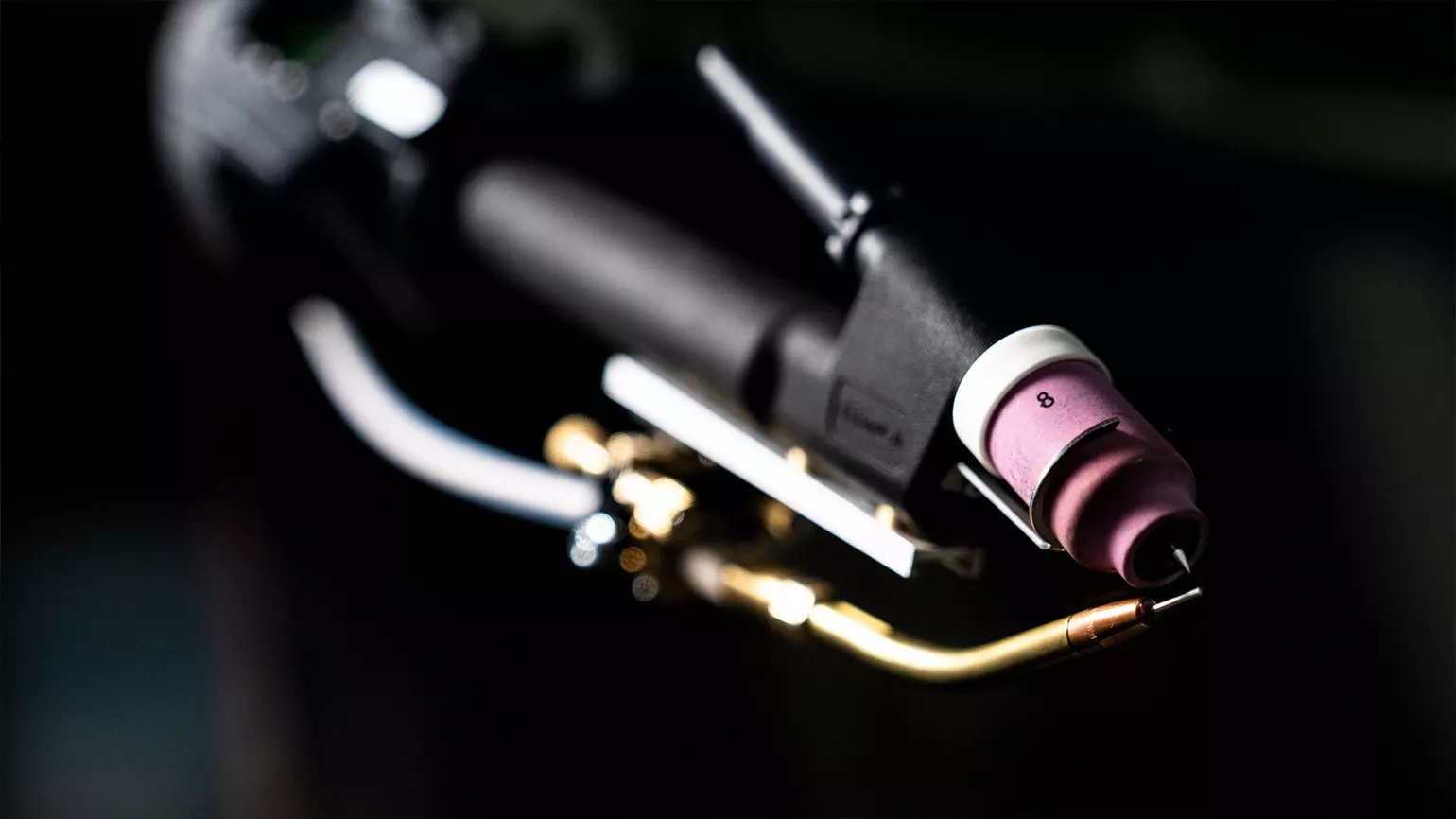

TIG robot torch systems – spot-on precision
To provide even more flexibility and improved accessibility, the “i” and “s” series torch bodies are available in eight different sizes and geometries – ideal for complex applications. This wide choice guarantees maximum adaptability and seamless integration into your welding processes.
  • You only need one hosepack for a range of different torch bodies
  • Torch bodies are available in a range of angles and power categories
  • The TCP accuracy of the torch body is +/- 0.8 mm
  • Cooling of the torch bodies has been improved by increasing the water flow rate

Specially developed for robotic applications, our “i” series sets new standards in flexibility and efficiency. It combines outstanding technological performance with ease of maintenance, facilitating clean and precise control and monitoring of the welding process—perfect for demanding industrial processes.
“i” torch body
  • Torch bodies in a range of shapes and sizes
  • Integrated connection for trailing gas and water cooling
  • Detachable wirefeed
  • Suitable for hollow-arm robots and conventional robotic applications
  • Integrated BID (welding torch ID) for detection and tracking during the production process
“i” welding torch hosepack
A particularly high degree of efficiency is achieved through the use of an internal wirefeeding hose for hollow-arm robot systems. The four buttons integrated on the hosepack permit intuitive control, while the status LED provides immediate feedback on the operating status. The direct control of important functions – such as forwards/backwards movements of the wire, gas flow/gas test, and cooling circuit on/off – means that operation from the power source is no longer necessary.
