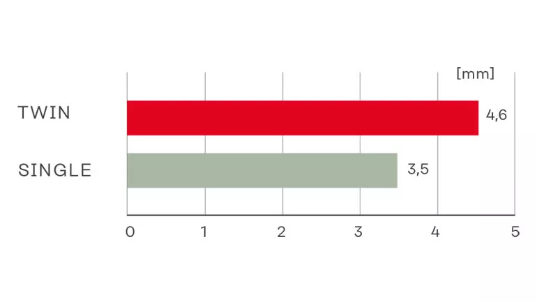

With the TWIN process, even greater penetration is achieved despite its tremendous speed.

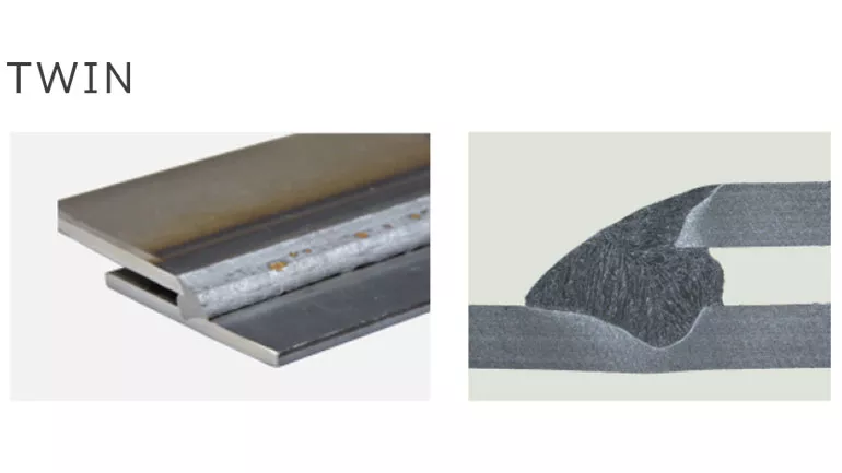

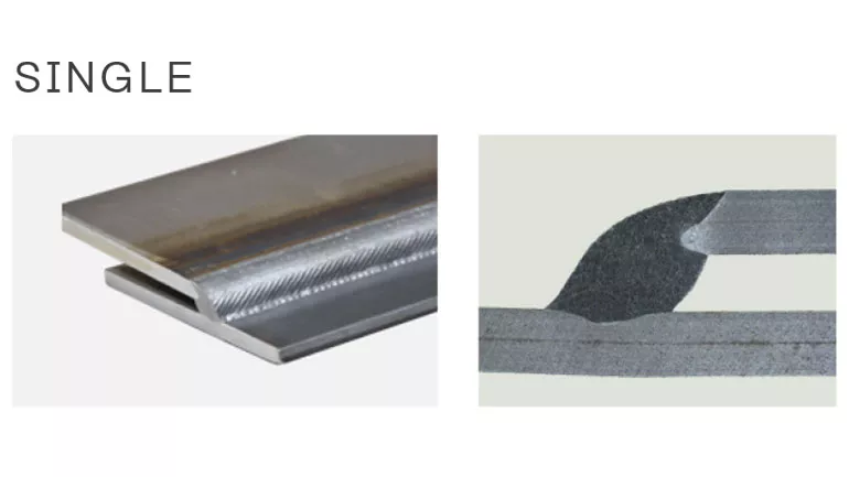

Same a-dimension (a7) and over 30% more penetration at 75% higher welding speed with TWIN.

One weld is enough: Thanks to the high deposition rate of the TWIN system, welds that require multiple layers are a thing of the past.

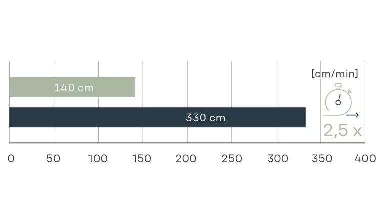

Reliable penetration without notches: Thanks to the high deposition rate, the tandem process enables speeds of up to 330 cm/min. This allows you to weld 2.5 times faster than with just one arc.

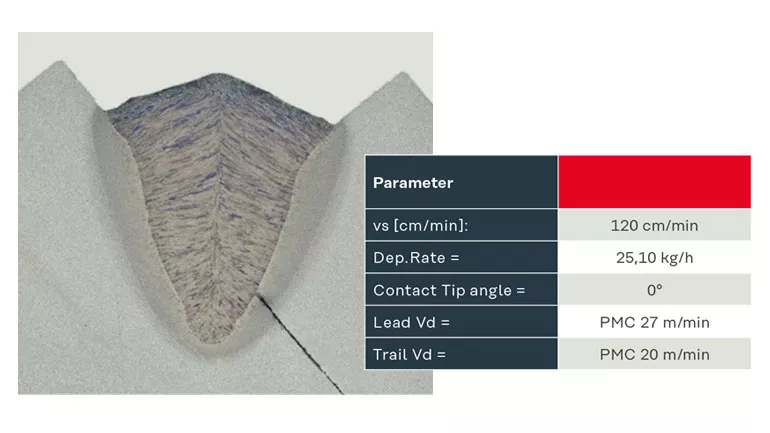

Current [A]: 155, voltage [V]: 12.3, vs [cm/min]: 30
Lead: Current [A]: 280, voltage [V]: 28.0, vs [cm/min]: 110 trail: Current [A]: 125, voltage [V]: 17.0, vs [cm/min]: –
