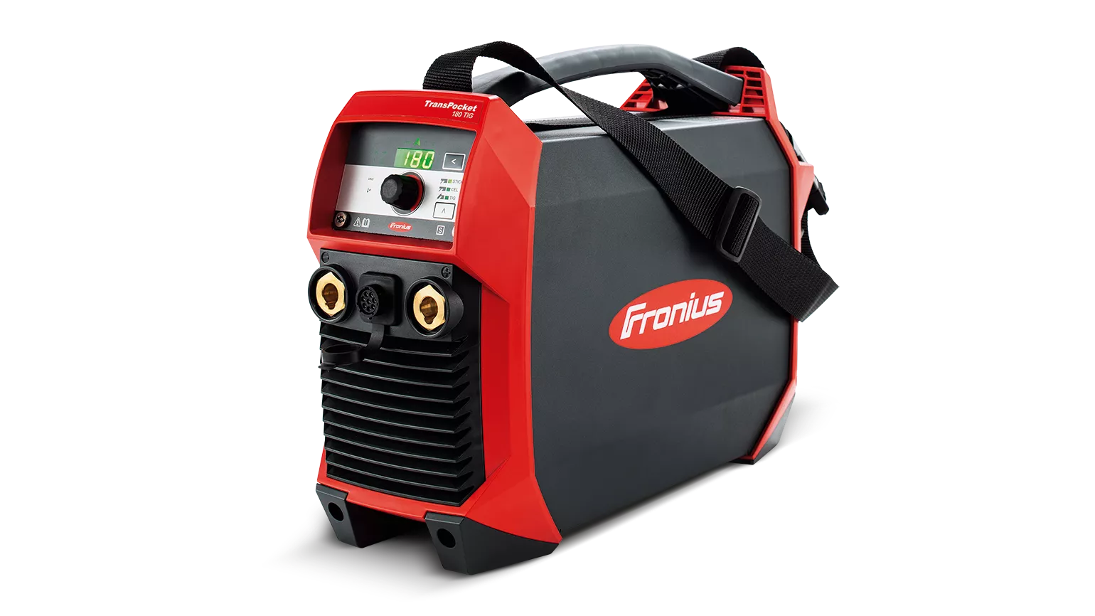

The TIG series of the TransPocket is available in the 150 to 350 A power categories. Thanks to their additional functions, they make work easier for the user: with the TIG Comfort Stop, it is possible to prevent annoying arc breaks at the end of welding. The TIG pulsed-arc function ensures better control of the weld pool during out-of-position welding and when bridging gaps. A gas-test function has also been provided.

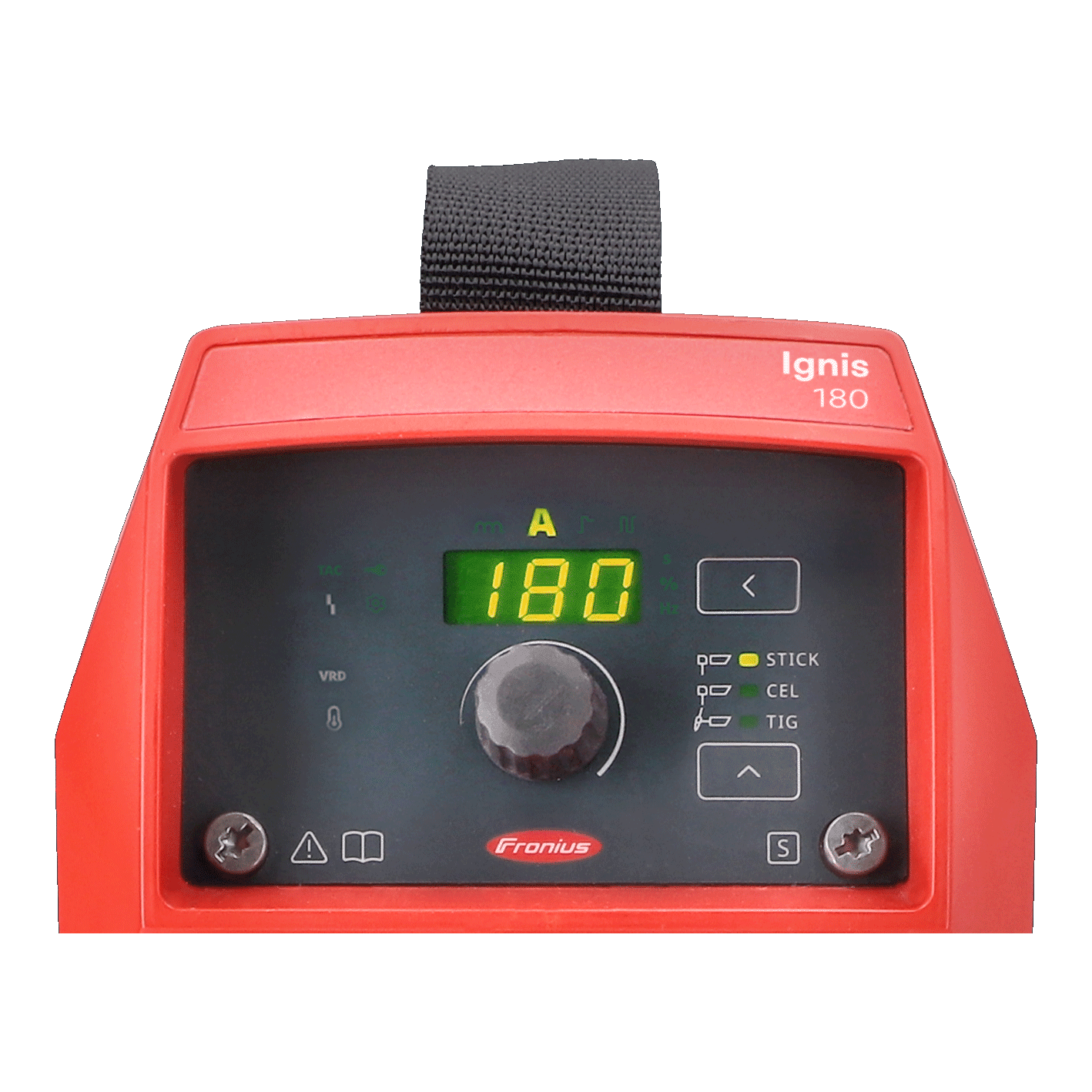

The new generation of TransPocket 150/180 devices brings a high degree of flexibility. The integrated PFC (Power Factor Correction) technology supports the use of extremely long mains leads of up to 100 m in length. The operating concept has also become even more intuitive. A 7-segment display makes it possible to quickly read off the parameters that have been configured. In addition, the display is slightly set back and therefore well protected against damage. Easily comprehensible setup settings are a tremendous help in simplifying operation.
