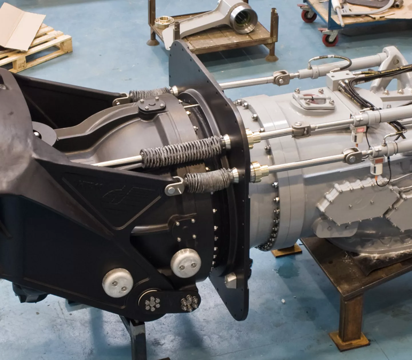

Duplex steel is therefore particularly suitable for the chemical industry, but also for applications in which seawater is involved, just as it is in products from Hamilton Jet Global.The company, with headquarters in Christchurch, New Zealand, has been specializing in propulsion systems for ships and associated control systems for over 35 years.Hamilton Jet manufactures waterjets in New Zealand, and a network of distributors sells them to customers around the world. Amongst other things, the products are used in fire boats and rescue ships, fast ferries, fishing vessels and also in pleasure boats.
Hamilton Jet uses duplex stainless steel to manufacture wear rings for marine waterjet propulsion systems. The wear ring protects the aluminum impeller race from abrasion caused by ingested debris and the rotating impeller. New designs require a joint in this component to be welded. Although Hamilton have experience with keyhole plasma welding of thicker material, the welding of material only 1.5 mm thick has proved a challenge. Hamilton has clear requirements in terms of quality: The weld joints must not have any notches, distortion may only be minimal, and the joining process is not to have any negative impact on the corrosion resistance of the material.
