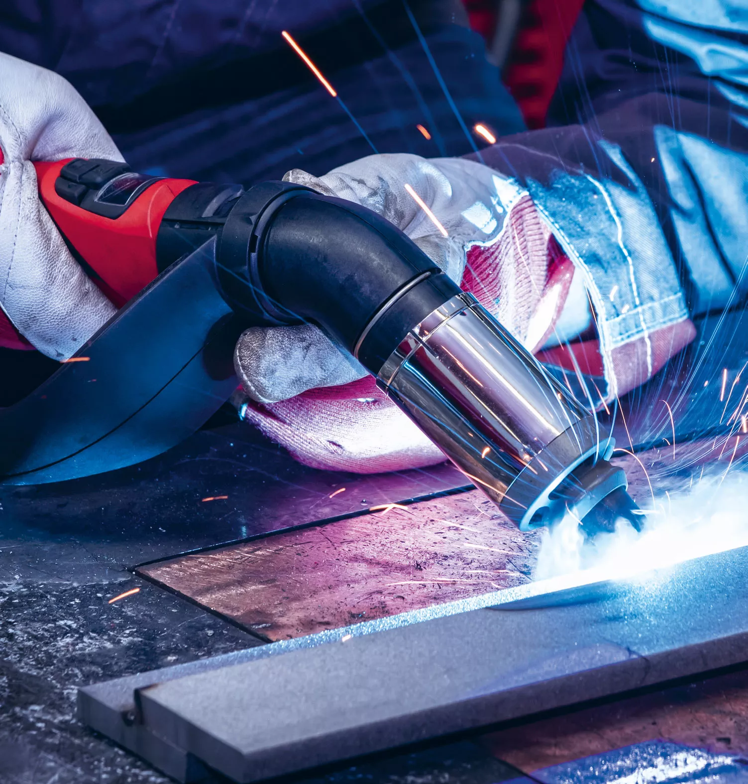

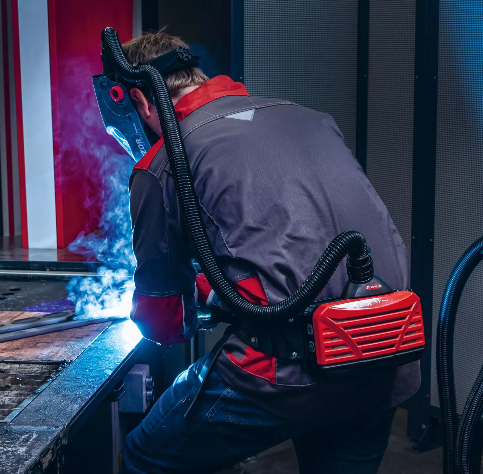

Nevertheless, welding fumes will always be unavoidable to a certain degree. For this reason, we offer a wide range of products such as welding helmets with a fresh air supply and fume extraction torches. However, not everybody uses them. Why do you think this is the case?
I think that fume extraction torches have a bad reputation, so companies do not see them as a viable method to control welding fume. There are concerns that they disturb the shielding gas, leading to poor quality welds, and the original designs were heavy and bulky. Manufacturers such as Fronius need to convince their customers that the new generation of extraction torches are a good alternative to local exhaust ventilation (LEV).
