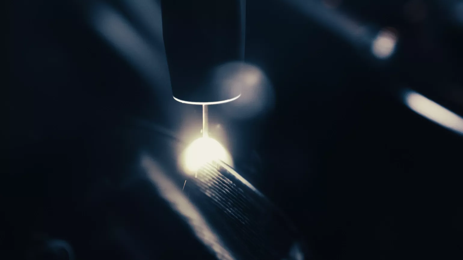

    CMT – a stable arc with no exceptions
    The synergy between stability and flexibility is crucial to producing components in additive manufacturing as well as a reliable welding process and efficient heat management.
    Thanks to its revolutionary reversing wire movement, the CMT process is extremely stable, making it a perfect solution for additive manufacturing. Layers are built up consistently, evenly, and virtually spatter-free,
    ensuring that the welded layers and components produced meet the highest standards of quality.

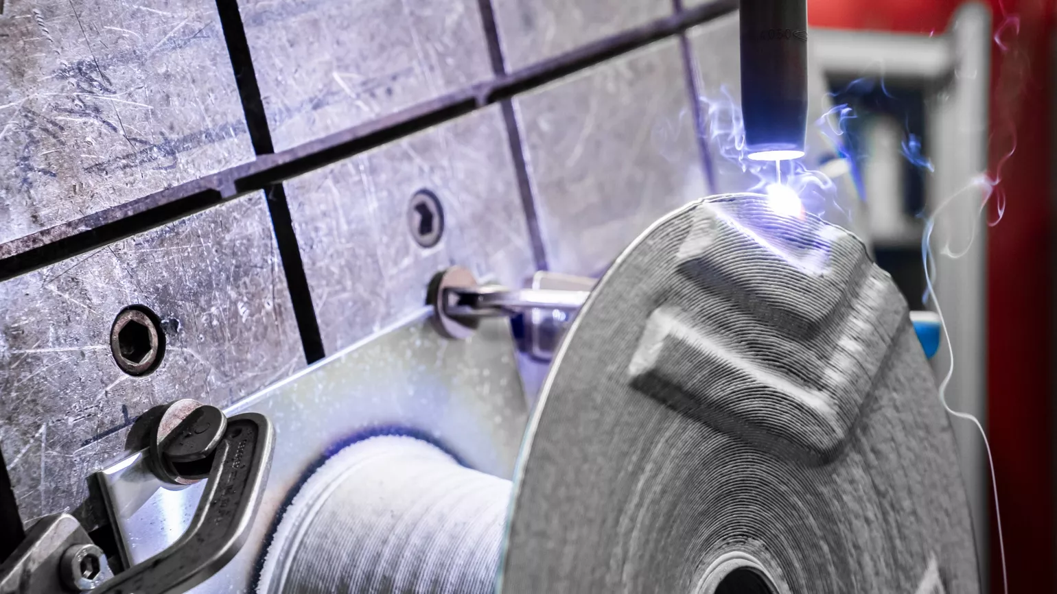

    CMT Additive Pro – additive features packed into one characteristic
    Exclusive features for maximum control in additive manufacturing
    We developed CMT Additive Pro welding characteristics specifically for additive manufacturing. They make it easy to achieve a reproducible uniform layer structure, as well as deal with other challenges.
    For the first time, you can also get positioning feedback during welding without any external sensors.
    Deposition rate stabilizer
    The deposition rate is regulated by the welding process. Layers are built up more consistently while boosting the reproducibility of production.
    Pulsed HotStart
    It’s simple to start welding in pulsed arc, so you can achieve sufficient penetration and adhesion even without adjusting the operating point.
    CTWD measurement
    The CTWD value [mm] is measured in real time and was specially developed for materials with low electrical conductivity, such as steel.
    Power correction
    Heat input can be precisely regulated thanks to the power correction, so you can keep the seam geometry almost constant, even at elevated temperatures.
